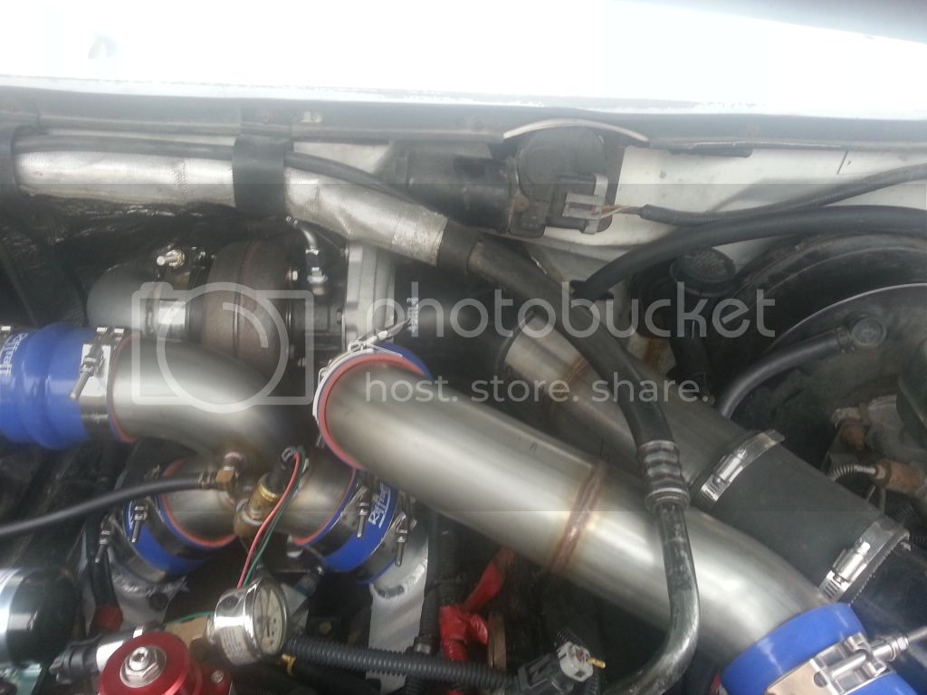

got the downpipe in
and the first try of fuel lines in the valley.
I think the return line and some wiring cleanup is all that is left in the valley if the plenums seal
m j
Jan 13, 2013
1,225
BC Canada Eh!
a/c was non functioning when I bought the truck last winter. condensor mounting brackets broken etc so I removed it.
the a/c is on the list of things to fix but not very high on it as we dont really get the heat to need it up here for more then a week or two a year.
do you see something I have placed to impede the factory lines that I can address?
jwlandry
2,533
S.W. Louisiana
mine is close to that intercooler pipe thats all.
you can see here how close it is.... I didnt realize how far north you are.
