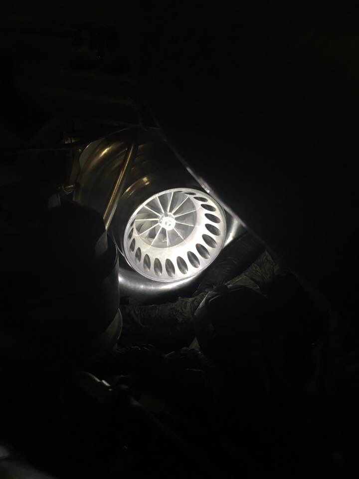

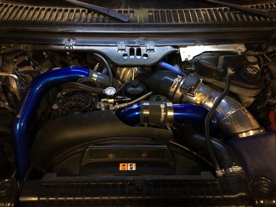

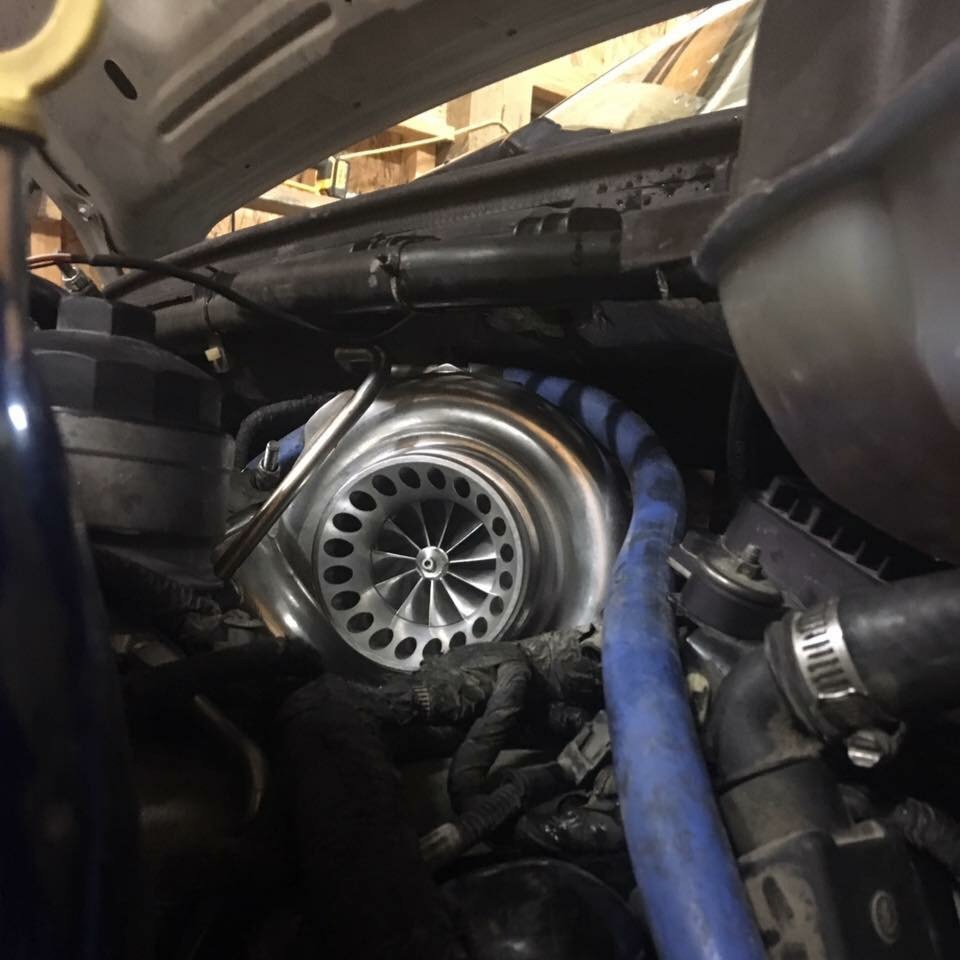

So for the past few weeks I have been testing the new ball bearing turbo from Kc turbos the stage 2r. I must say the quality never stops amazing me. This turbo is absolutely amazing. My mods include:
5" turbo back exhaust
190/30 injectors
New ford heads with 6.4 pushrods
No limits intake with pro guard filter
Driven diesel reg return fuel bowl del ete
Fass 200gph pump
Stage 3 twisted diesel transmission
2k pi converter
And a few other things I'm sure I'm forgetting, but anyways on to the review.
I really didn't think I would notice such a difference, but I couldn't be more wrong it lights 3x faster, builds boost down low, and stays around 200-300* cooler on egts. At 65mph and 2k rpm I'm at around 13# of boost, and 550* egts at WOT about 34# of boost and 950-1050* on egt. Also I loaded up a tow tune and hauled my 33ft fifth wheel around that weighs in at around 13-15k pounds. It pulled like nothing was back there in overdrive at 70mph I was about 1950-2100 rpms my egts never got above 1100*. Well then I got the extreme tune from Charlie with the new Ebp sensor that can ONLY BE RAN WITH HIS TUNE in case any of y'all get this tune and sensor, and all I can say is wow this thing rips so hard and run extremely clean. I have zero lag and jumping into it from overdrive just a faint haze of smoke it's crazy how clean and hard it runs.
Again the customer service was first class as always he stayed on the phone with me the entire time to get it dialed in exactly how I wanted and answered every email no matter what time I sent it. If you are thinking of going from the stage 2 to the stage 3 but don't want to give up towing heavy this is the way to go. If anyone has anymore questions feel free to ask me.
