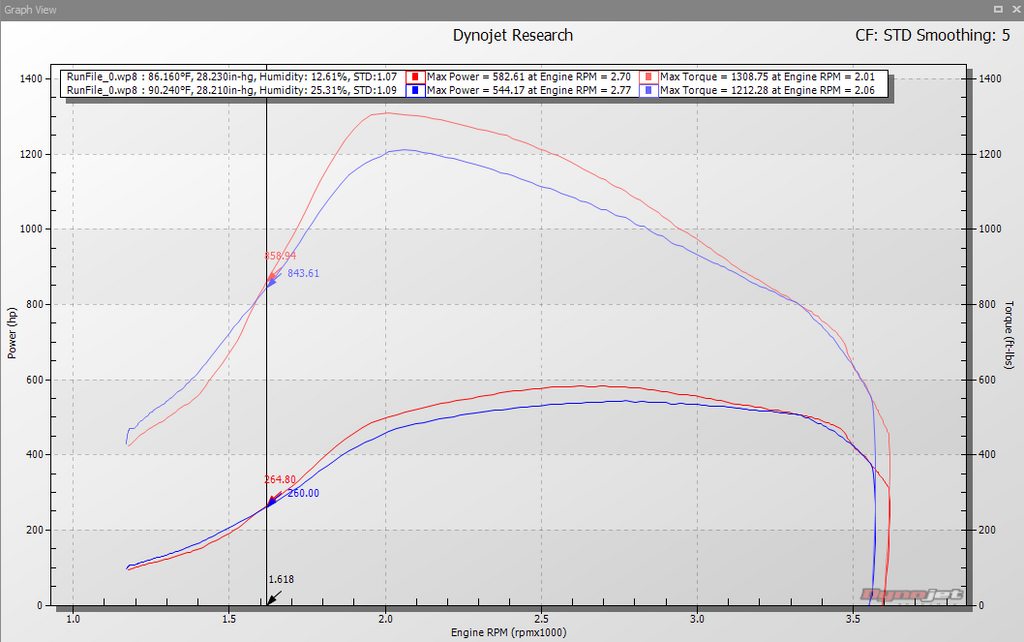

We did some more dyno testing on our 2011 f250 6.7 test truck. The results were much more impressive than we were expecting.
This test was to show how much power is gained when swapping on a 2015 cp4 fuel pump. Truck mods: stock 2015 turbo, EGR/*** ******, No Limit Air intake, and EZ Lynk loaded with Truck Source Diesel SPD tunes (aka Super Panty Dropper tune)
Peak HP increase 38hp
Peak Tq increase 96tq
So with the 2015 turbo and CP4 with TSD SPD tunes
582hp
1308tq
Huge shout out to Chris Buhidar with Truck Source Diesel & Off-Road for the quick turn around on the amazing tunes! The truck is SO MUCH fun to drive. It is incredible to punch the throttle at 1800rpms with 2nd gear early lockup... it puts a smile on your face every time!

wow that's really impressive for a stock 2015 turbo and CP4 setup! nice and thanks for a complete testing of each part as you add them! it helps put into perspective what parts help with making power and what sort of power that might be

hey somebody chime in and correct me but the factory rods can live at the 580ish/1300 numbers KCturbo made right? I thought 650rwhp was the safe limit of the factory rods correct?

It is not just HP that kills these motors. IMO huge tq numbers way down low can cause big issues also. (also crazy timing also has a big effect)
580hp should be fine
1300tq at 2000rpms should be fine... but I don't think I would want to be making any more tq down low. I think that is why a lot of these trucks last longer in the higher HP range with non-vgt because it move the tq curve up a couple hundred RPMS. Kind of the same theory on 7.3 trucks. They tend to be really conservative down low with tuning and it helps them to last longer at higher HP levels
