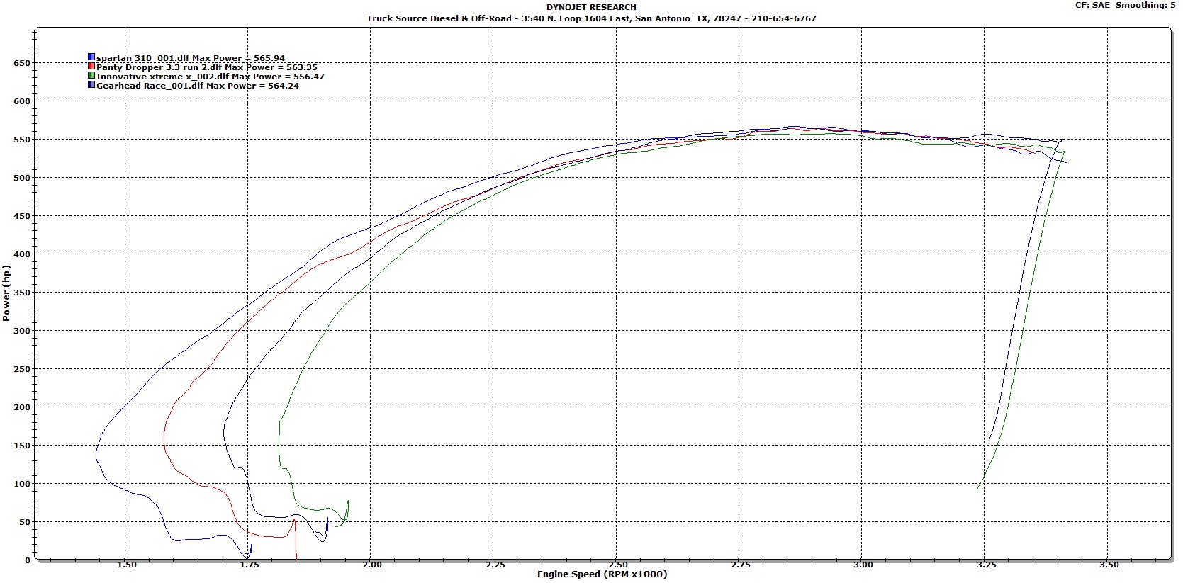

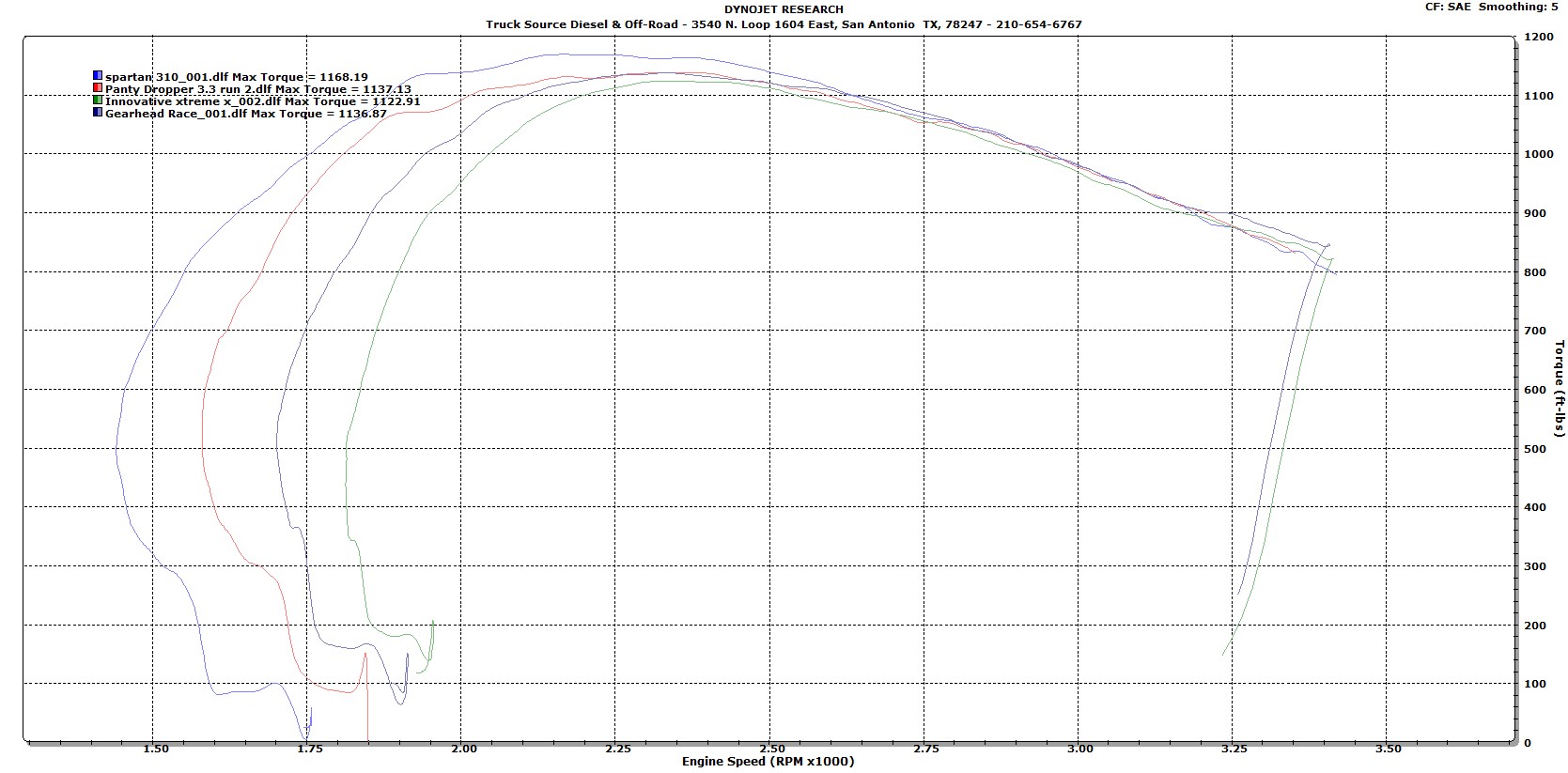

These were about two years ago. Only mods were batmowheel, ported fuel rails and a built trans. Truck had about 185k miles then on stock hpfp so I didn't bother with the Spartan 350 tune.

And what were your results? What tune ran best for you? Loaded or unloaded dyno?

Never mind didn't see the graphs. There all dam close. A lot better then what I saw. See spartan still looked the strongest slightly

From when I had Spartan I think they are stronger because they have very little smoke control over the whole throttle range. Any tune I ran from them I could smoke the intersection out unless turbos were really lit. I liked them a lot just my experience.

All my tunes will smoke an intersection before the turbos light if I get on it hard from an idle. But all clean right up once turbos lite. Even the spartan
