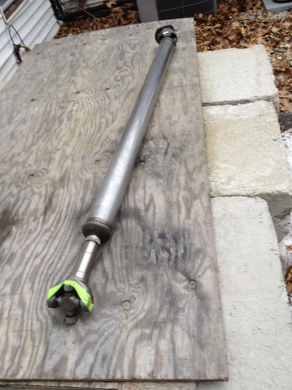

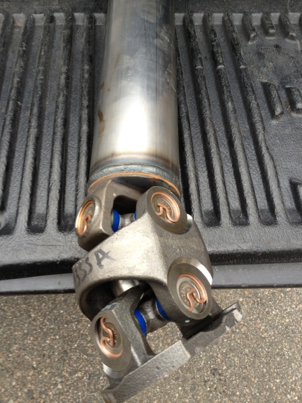

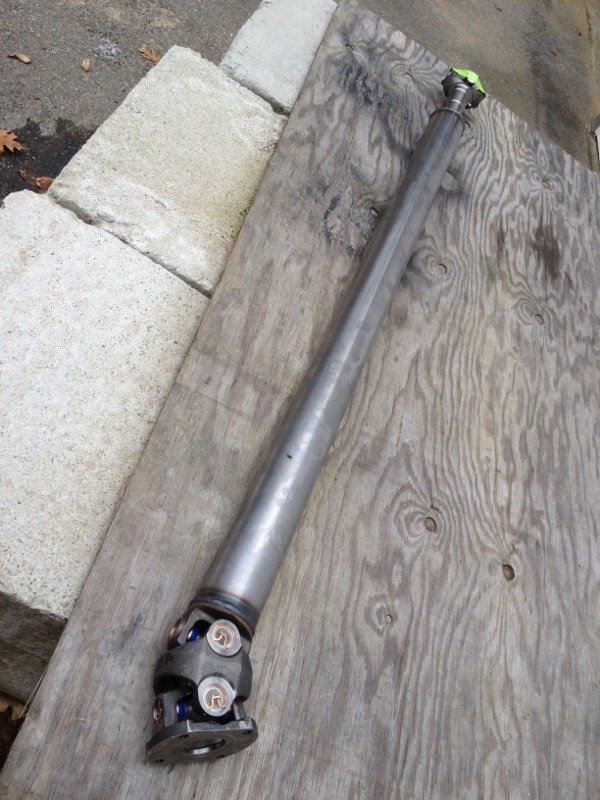

After test driving it I noticed a drive line shutter on any acceleration. Once again SDP got the parts. Sean has a one piece drive shaft being made up as I type this. Once we get that baby installed I can feed Sean my output shaft and pinion angles and we can see if I need to put in an angled block in place of my one inch aluminum piece. I should be good to go. The angle doesn't look too drastic.
