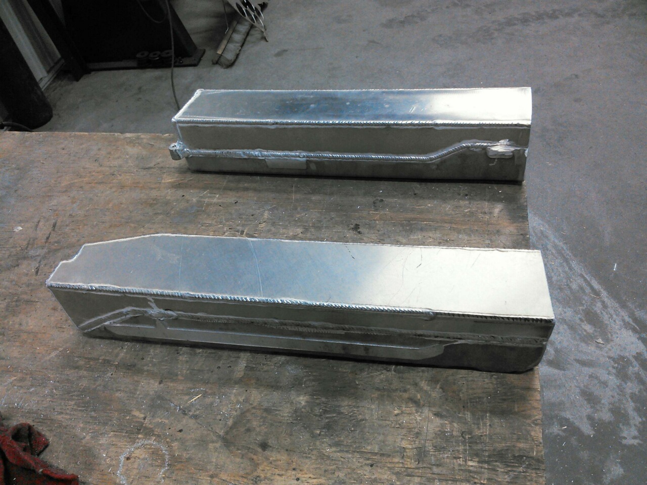

Fuel cell being fabbed up, it does have baffles on the inside, if youre wondering what the weld marks on the sides are
