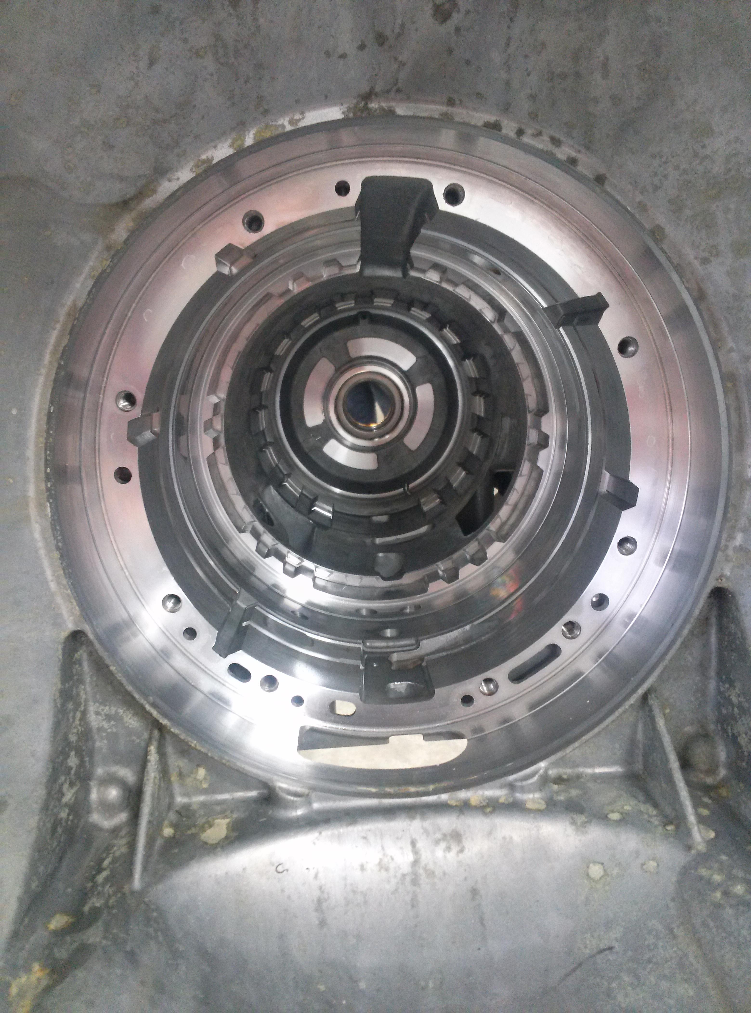

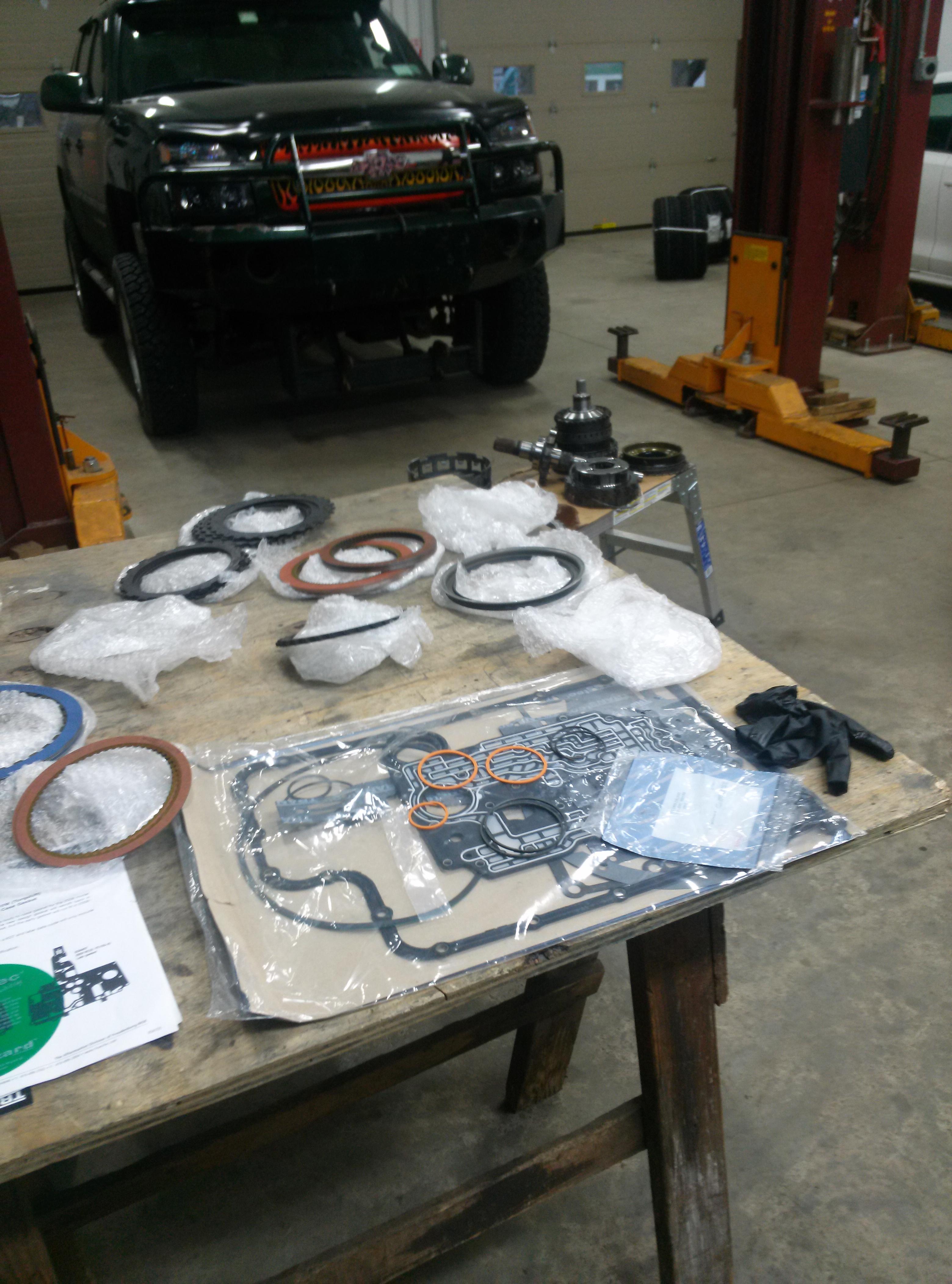

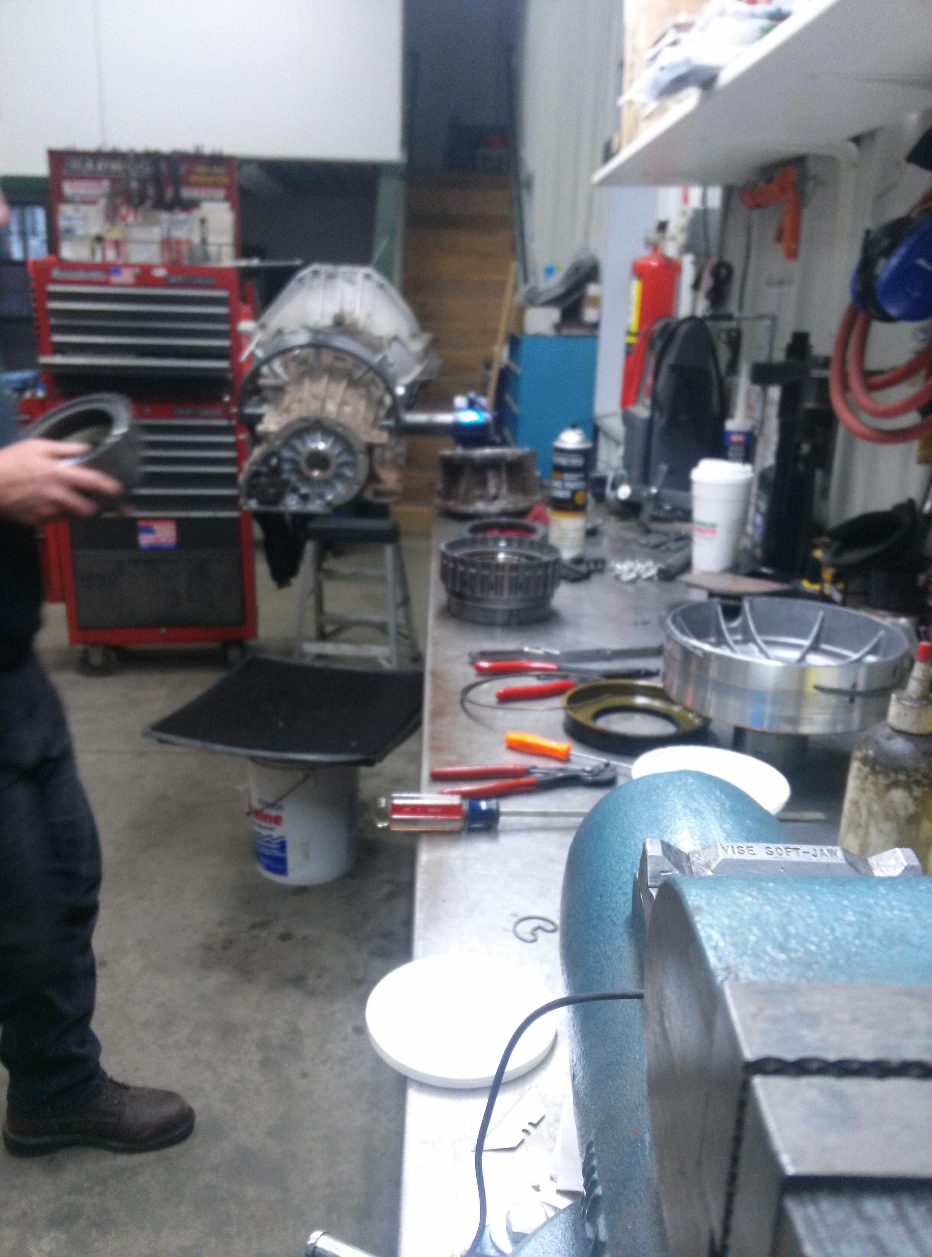

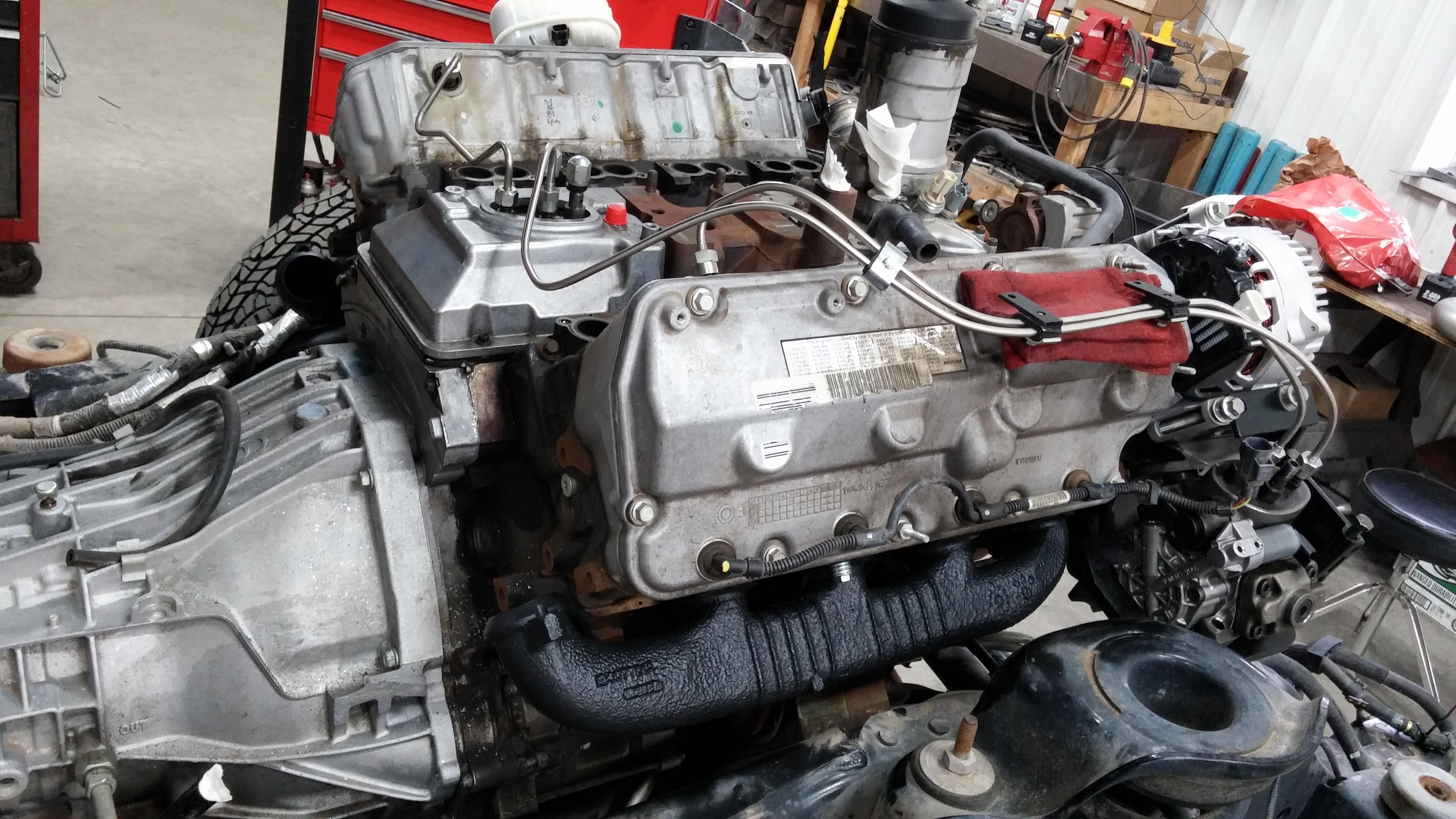

Trans is apart and should be done tomorrow. Still debating on doing the transgo kit I have. Its the small 40 dollar kit with the reverse snap ring, a pressure relief valve and a few springs. It seems like some use it and some dont, or some use the snap ring and thats it and that tuning has a big role in how the trans feels with or without the kit. I may message matt at gearhead to see what he would prefer I have in it since I will be going to him for the tuning.

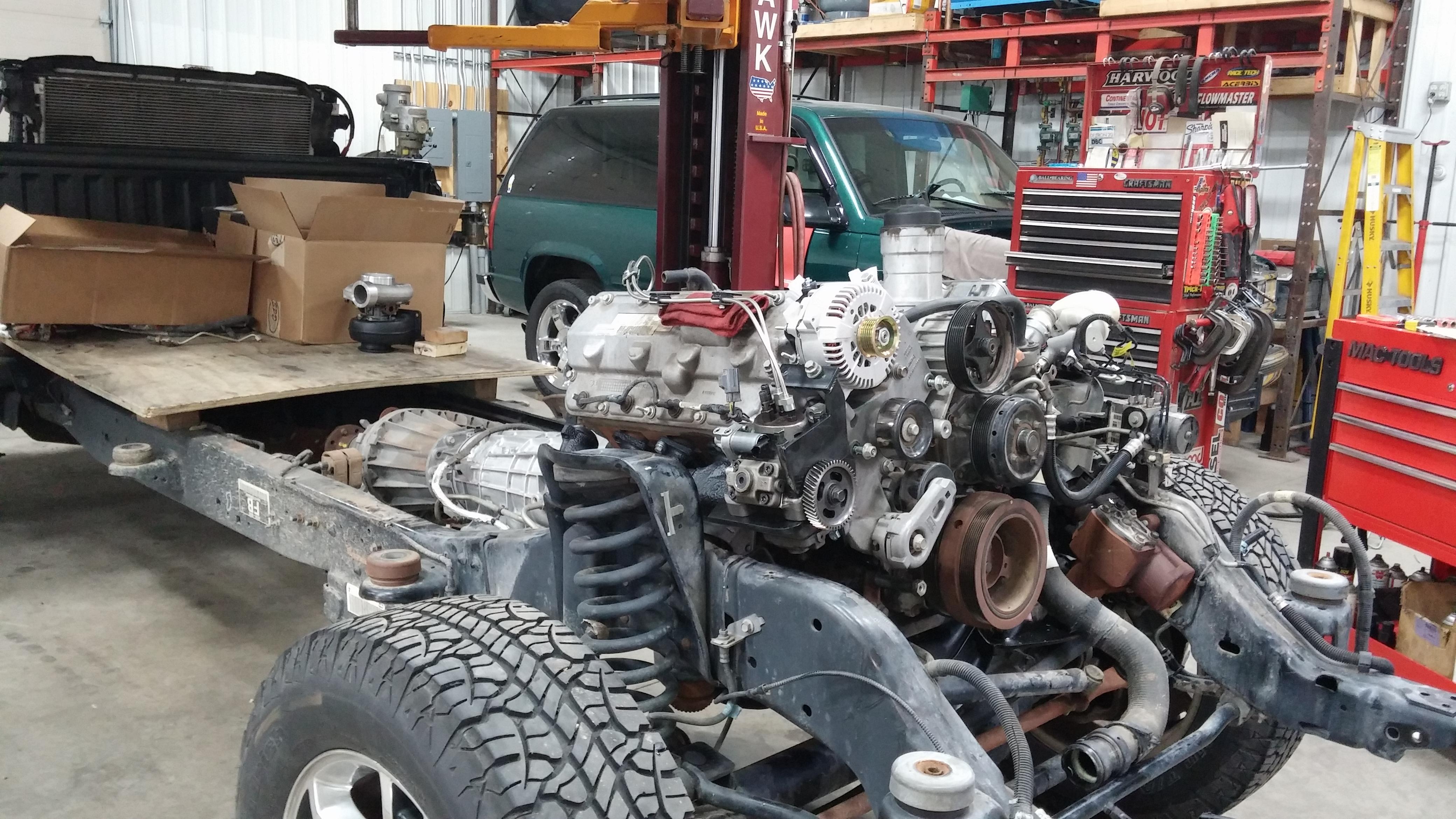

Also waiting for the converter to show up from dpc. As soon as thats in the trans is going in the truck and we are going to take it for a short drive to make sure it seems good since this is the first one my buddy has done, then back in the garage to lift the cab

At the very least put the heavy snap ring in.
Leave the pump spring out. Those are for raising line pressure without a tuner.
The little piston/plug deal with the hole drilled through it, it prevents pressure spikes in reverse.
4x4s can avoid pressure spikes by backing up heavy loads in 4-low.
2wd truck obviously cant do that.
I put the snap ring, relief piston in my trans when building it.
No problems so far.
Tip: the pump has to be separated to install the relief piston. When resembling the pump make sure the two halves are lined up to one another, think 2 quarters stacked.
Or the pump will not want to bottom out when ya go to put it in.
On edit: im running Matts tunes as well.

I dont really tow or do anything heavy in reverse so I was thinking about just leaving the pressure relief valve out. Thanks for the info, I did read that in the directions tonight though.
So unless gearhead says otherwise Ill probably just use the snap ring

Thats what i would do then, leave the relief out of it.
Saves from having to split the pump and realigning it.

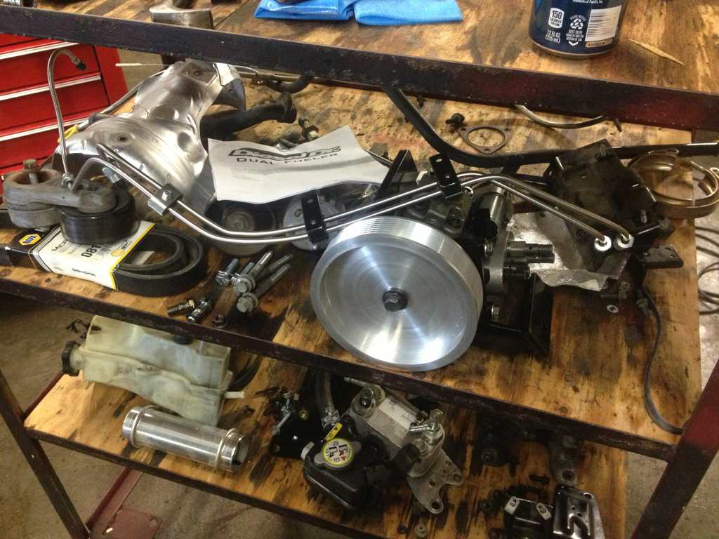

Any up close pics of the diesel dr dual fuel kit?
I love my DPC converter. I believe Craig is running a DPC in king kong with those big ass compounds.
madman1234509
Nov 20, 2011
2,669
mayfield, ny
I dont have any at the moment, the kit is sitting in a box at the shop. If you youtube it he has a video explaining the kit, give you a pretty good idea of the kit, besides the bracket being painted.
