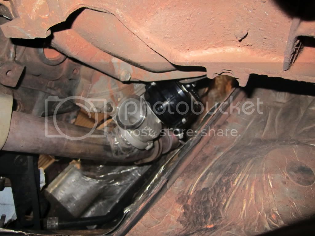

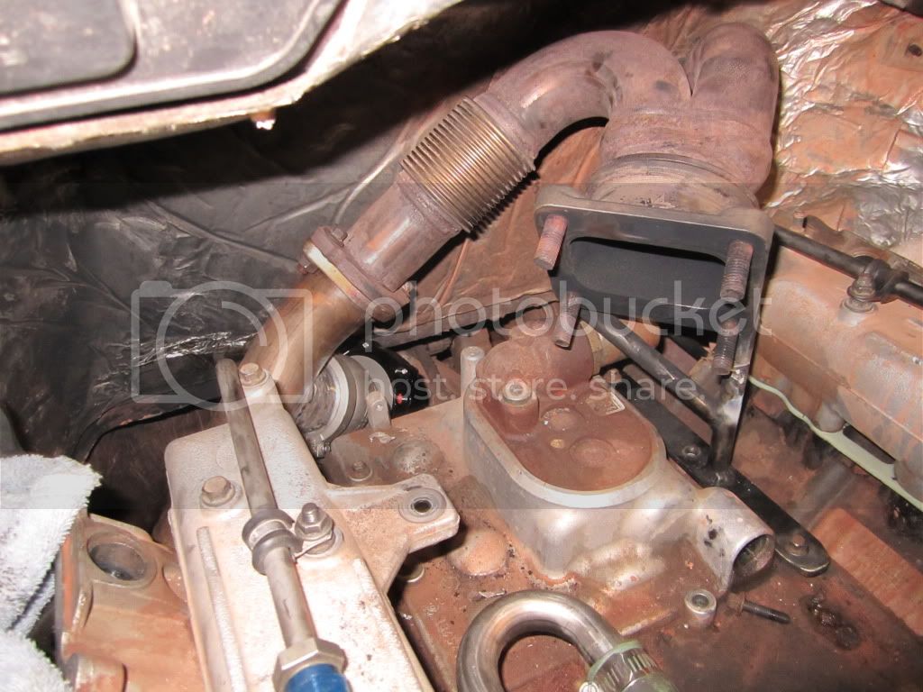

I plan this week to remOve the up pipes and install a 40mm external waste gate and dump to the atmo and weld some sort of bung for a mechanical EBP gauge
id like some feed back pics
i have autometter phantom 2 guages id prefer to run a guage on the shifter collum
if im right i need to buy a boost guage for the ebp guage. or can i run some sort of electrical one and run off of the factory sensor?
id also like some feed back on the way i need to run my external wastegate
i plan on putting it on the left up pipe and running a pipe for dump off down to the front driveshaft
heres some old pics before i parked the truck again
all my parts will hopefully be here by Friday.

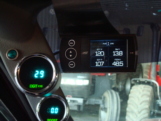

Yeah i agree Matt....mine is an electric. This way you wont have any chance of the gauge getting plugged with soot. I had a home made filter on mine.
strokin6L
2,979
Springville NY
ding ding ding on the dakota digitals....that's what i got. They are awesome.
