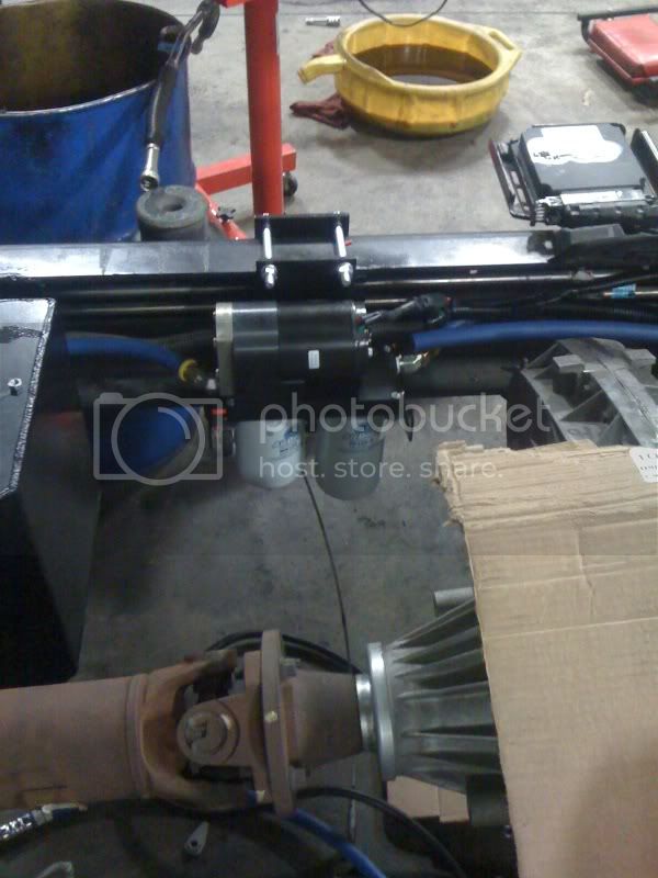

You will need an air dog to hook to the hp's vgt turbo. Other than that just tune it and go. Look up bigrpower his truck is set up this way and he has a thread on it. 625hp I believe. He has supporting mods as well.
BFT
2,628
southern cali
only thing other then the turbos that we did on bigrpowr's truck (aside from the fuel block on the engine bay to run the air dog)
edit: and 6.0 exhaust manifolds
jdgleason
7,993
Fort Collins, CO
So you are saying just run the high powers and all else stock? I understand stock injectors but upgraded low fuel pump? I am new to the whole 6.4 game so please forgive my ignorance.
Exactly. The reason you have to run the air dog is because the stock fuel dowl needs to be removed to fit the high powers. So, an airdog with the fuel block (in place of the fuel bowl) and a set of turbos put bigrpowers truck over 650 to the ground. Trap speeds show a little better power than that even.
