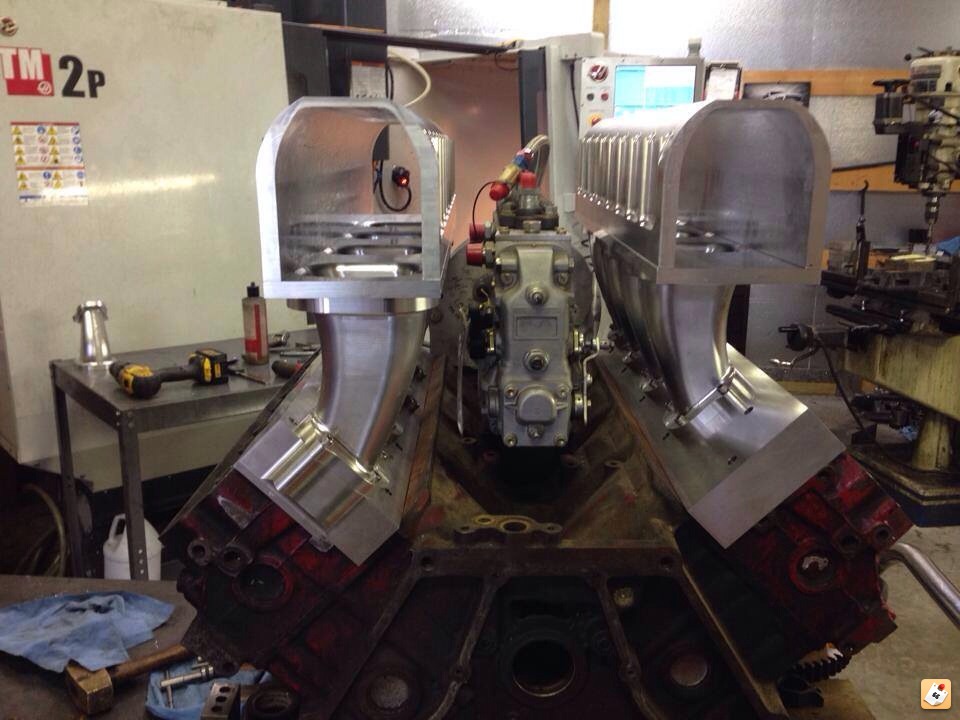

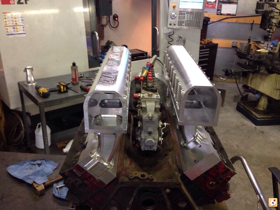

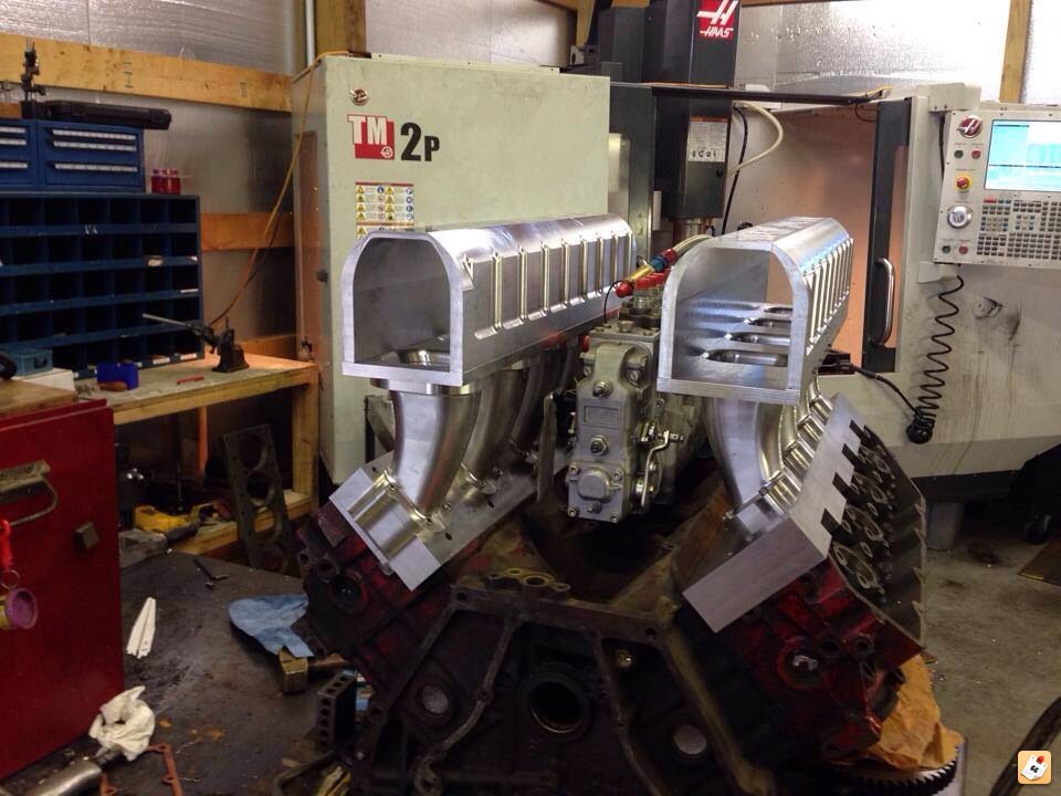

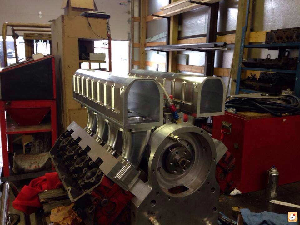

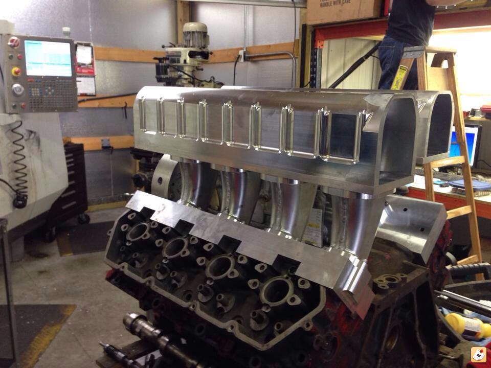

Some intake porn for you guys.
Oct 1, 2012
5,868
Athens, IL
That is freaking sick! So you cut out the intake side off. Isn't that kinda like double over times head are like now? They should flow awesome numbers. Too bad my 6.4 doesn't have something like that.
513
Bremen, Ohio
Morgan, I haven't seen the latest setup on DOT, but these will definitely be a HUGE improvement over what is currently being offered.
6.4 and 6.0 intakes are in the works... I'll keep you updated when they become available.
