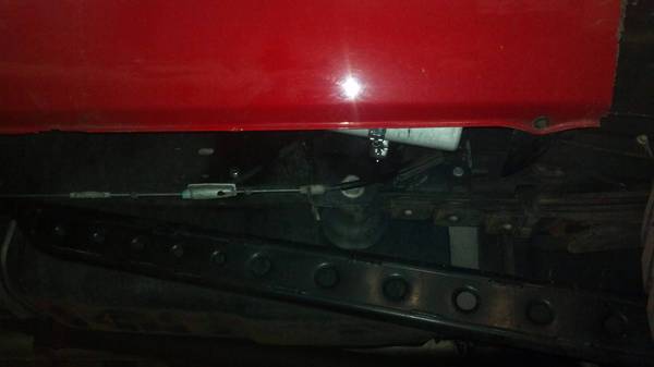

i just hooked up to my trailer for the first time since i put the ladder bars on and it not only hits the bars but bows them. is it a problem to flip them over for more clearance?
what have others done in the same situation?

i found no solution to the bar issue yet short of replacing them. is anyone else running the fabtech bars on here?????

the only issue with these bars is they hit the springs which sucks because i tow a fair bit.

here you can see how Wayne mounted the same Fabtech bars you bought from him

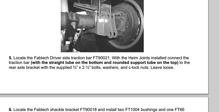

Thanks Shone-that's exactly what i was wondering. as soon as the cab is back down and the truck is mobile i will flip them. i guess i got thrown off by the instructions...
