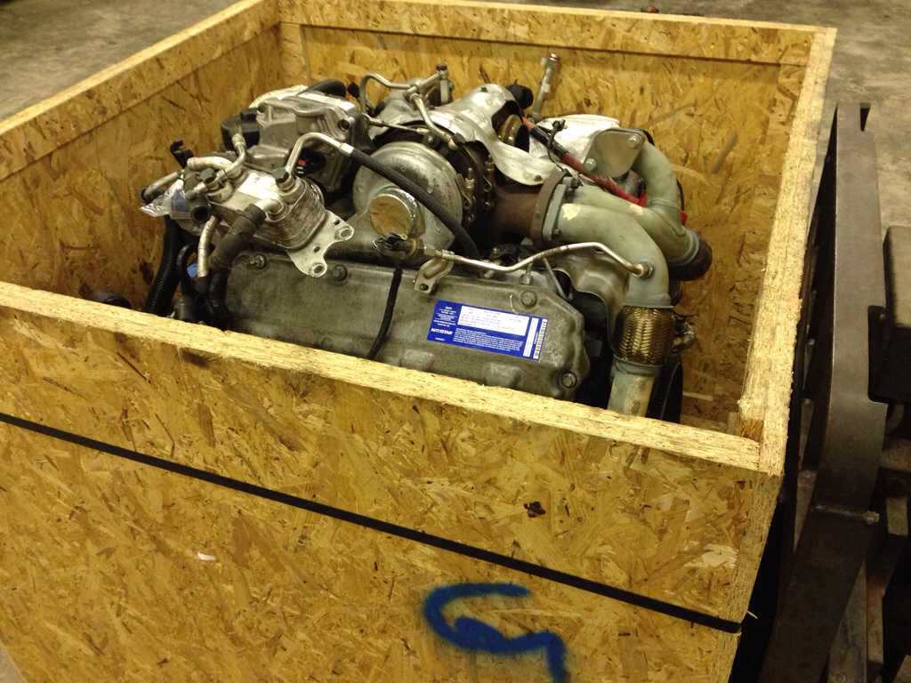

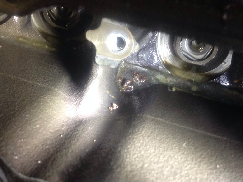

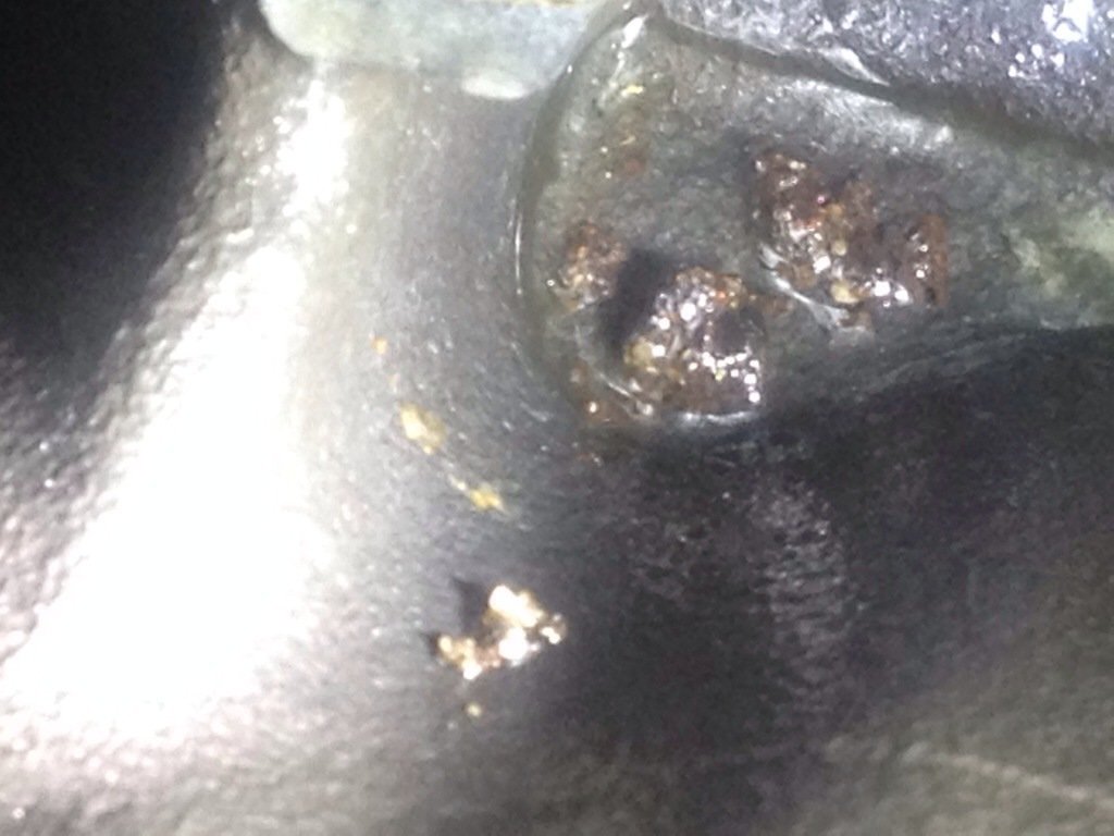

Just a little bump to the top. As sootie has mentioned he has had antifreeze in his crankcase. He contacted use and picked my brain about the experiences we have had with cracked blocks of the same nature. The talks ended up with the engine being pulled and shipped down to us.
The agreement was made in a list of parts and pricing to do the build. Also agreed upon was that we will not perform anything until the leak was positively confirmed. Here's what's we found after some disassembly and pressure check. The pic is not perfect but you can see the rust line in the block. It had plenty of bubbles when pressurized to 40psi.
The crack is exactly where the majority of them split. In the second head bolt in from the end in the lifter valley.

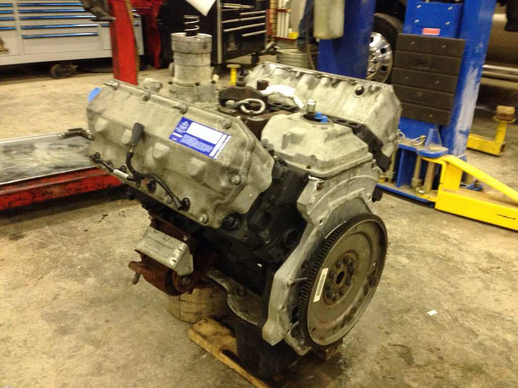

And some pics for sootie since I don't think the engine showed up yet. He may be antsy to see it.

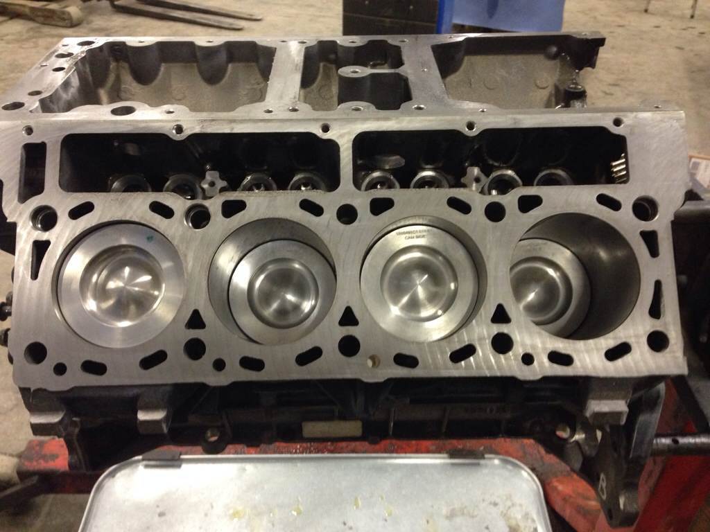

We did a full new block, HD pistons, HD springs, HD pushrods, new lifters, new oil cooler, new studs and oem gaskets, all new seals bearings and gaskets.

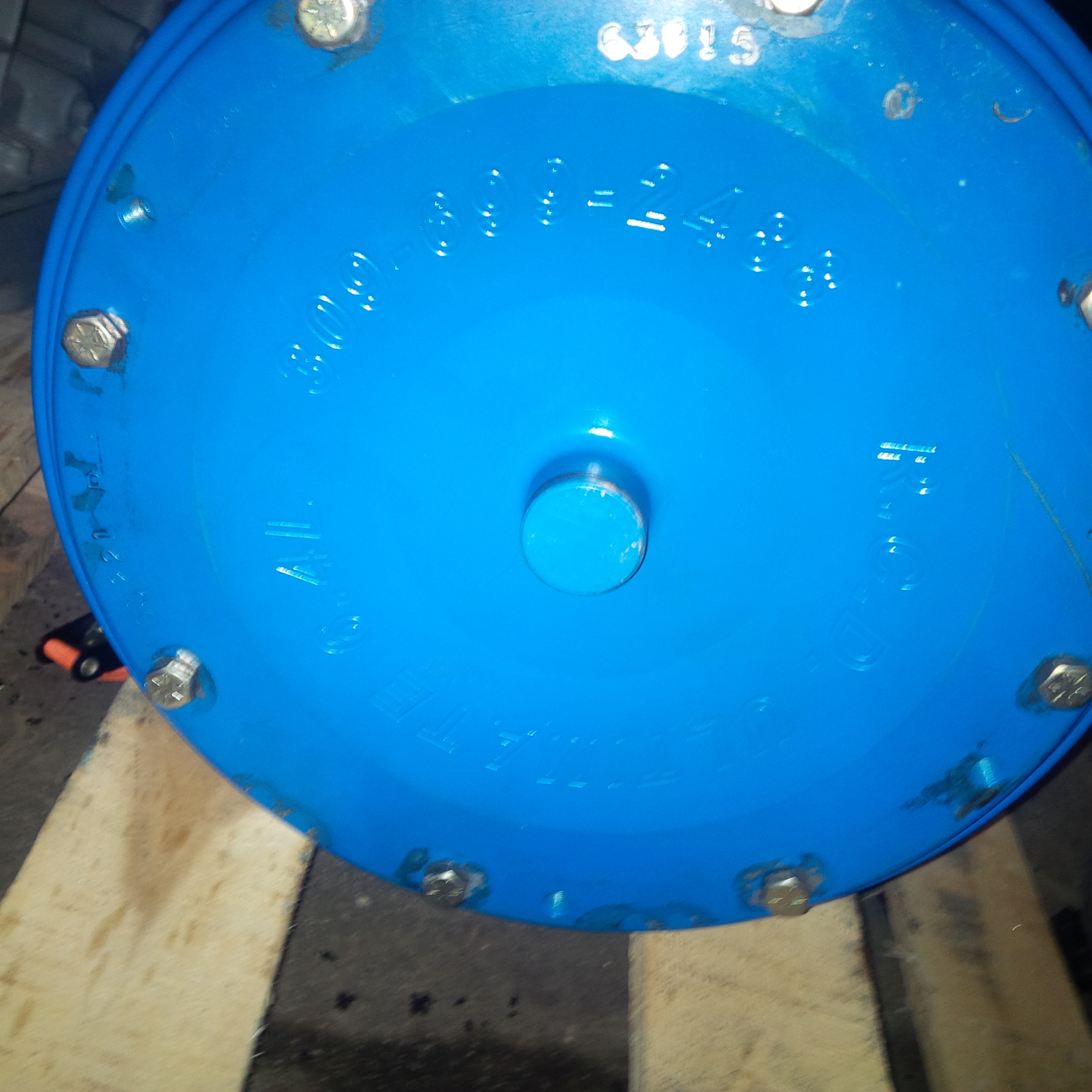

RCD Torque Convertor & Refreshed trans
Something was slipping in the drive-line as the rpms would climb drastically in 3rd gear and the speed wasn't increasing incrementally LOL
i figured the stock TC couldnt hold the power so i decided to install an aftermarket unit. i picked up an RCD unit with a 1600 rpm stall.
i also installed a trans with billet input and low/reverse hub and Suncoast IronPac 3 rebuild kit.
We'll see how long this lasts... :demon:
all i can say is-now that i've driven a truck with an aftermarket TC its gonna be hard to drive a stock one. when it locks, it is instant and pulling thru the gears with it unlocked it feels really strong.
