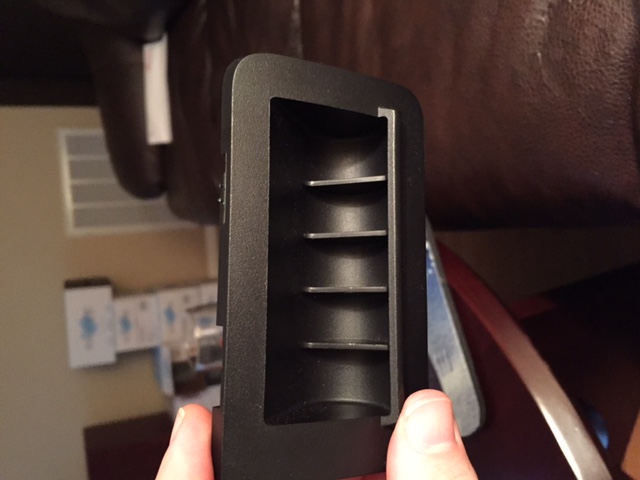

Hi, figured I did not need to start a new thread for this but does anyone have pictures of our trucks WITHOUT the factory Ford upfitter switches? Is it just a blank panel that goes in there? Also are the upfitter switches able to be disassembled one by one or are they only a complete set of 4?

I added the upfitters on my truck but here is the piece that was there before. I don't know if this will help you at all.

Thank you for the picture. It is perfect, a little disappointing considering what I was planning but we will make it work. You wouldn't want to sell that piece all of a sudden would you?
