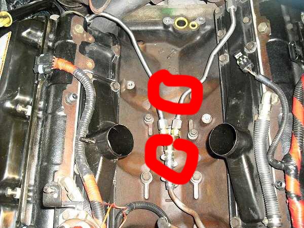

mn_sclb
Feb 26, 2015
112
Inver Grove Heights, MN
the circled parts are where there are seemingly small puddles of oil. But they are both deep enough to at least go up to the first joint of my middle finger.
I can't see farther than the 2nd circled area so I assume it's there too

Is that you motor or just a pic you snagged. I like the fuel feed lines on that motor.
If there is oil in the valley, you have to clean it all out, if you wash it out it will drain out that hole it the back passenger side of the valley. That oil can be coming from the HPOP, the pedestal, the HPO rails or the HPO lines. You have to clean it, run it and observe with a light while it is running to find the leak.
whs^^^ spot on.. and while its running please for the love of god dont forget about the fan spinning!!!!
