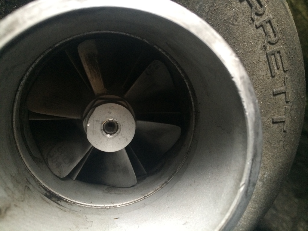

Or it could be that it's lost compression. I mean air box shattered, rip in intake, and map line unplugged for who knows how long, with a compressor that definitely has wear it's possible

Definitely seems like a tired/neglected old girl. Might want to start looking for a sound lowerish mileage motor to swap in.
Dude, that compressor wheel is looking pretty rough. I'm sure the motor has been dusted pretty bad. What is the oil consumption like?

im thinking turbo seals are bad

Hard to tell, between the oil spots on the ground and the blue smoke.. I'd say I'm probably down a qt total. I've just been telling myself that dusting would probably cause way harder starting then mine, and the blowby would have pressure. Maybe I'm just lying to myself tho lol

Just a bit above the botom of the "2qt down mark" but It was never much more than that hot. Let me clarify I knew the oil level I just wasn't sure how much was actually being 'consumed' lol
