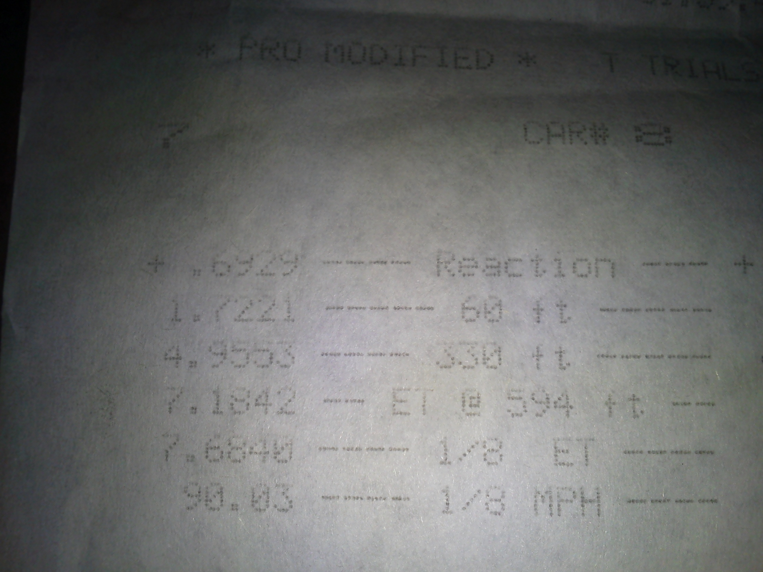

I took it to the track tonight, still have not moved the gate but she ran good for the way the gate is. I will try to get it moved to where it should be soon, I have just had too much going on. A bunch of us decided to go to the track so I ran it a few times. Best pass was 7.68 @ 90.03mph with a 1.72 60ft.
I have 6in lift 35 tires and still had the spare under the truck. We did pull the tail gate, and my brother was riding with me. That pass I saw 56psi boost (till the gate opened early) I'm too tired to watch the data logger again to figure the #'s out. I had major traction issues with the tires even at 35psi front and 30 rear.
It got lots of attention! I cant wait to get the thing dialed in perfect when time permits. She still has a good bit more in her I just didn't want to hurt anything or push it too hard till I get it right.

Great job Tony!
I think that 1/8 mile converts to 11.98ish in the 1/4. Glad it's coming together, get the bugs worked out, weight dropped, and it's a solid 11.5 truck IMO.

trans is hating life on that second pass and you're leaving way too hard. you should prolly be able to get 7.50 out of it at current power level getting that 60ft way down. great start for sure buddy! congrats.
