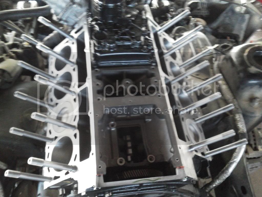

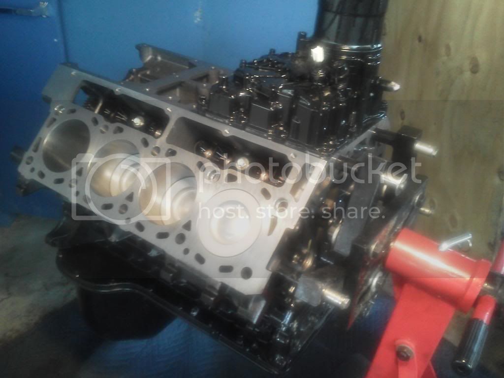

short block with IH coated pistons and RCD cam
Elite studs in

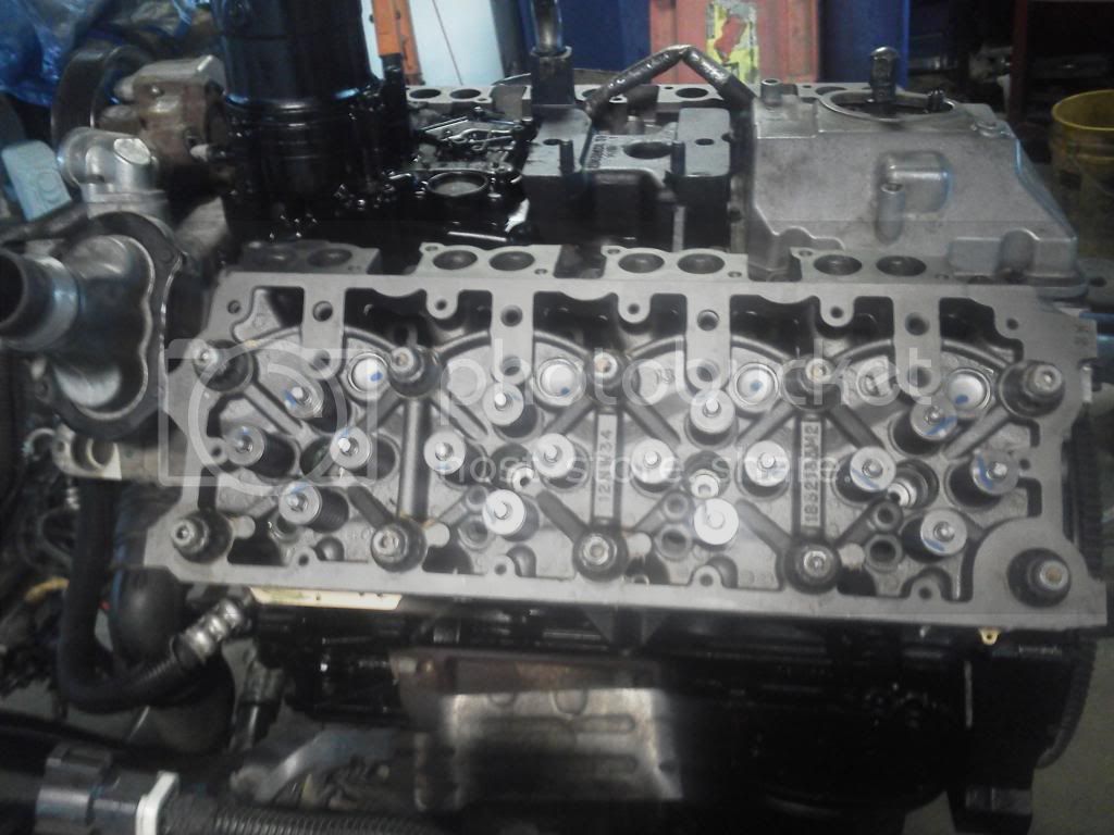

heads on

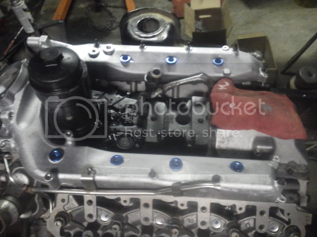

Rcd intake on, looks good!

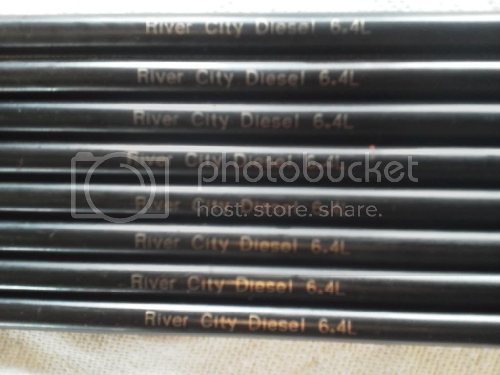

RCD posh rods look nice too

I put the short block in the frame then installed everything else, I don't really trust my 2k engine stand with the long block on it.
