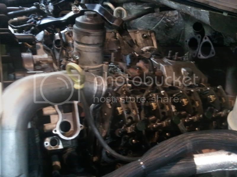

Heads are off as of a hour ago. Everything looks good. Heads check out good for being flat so that's a bonus. Truck wasnt puking so I highly doubt the heads are cracked. Have to do some checks. Should have heads torques down tomorrow by dinner time. Have to locate a big torque wrench, didn't realize ARP studs went to 325ftlbs and my torque wrench only goes to 250ftlbs. Oh well, we got some resources. Pog is getting some parts cleaned, his intake elbow and cold side pipe got powder coated, they look real good. Well that's enough for day 1. Time for a shower and bed. Later guys

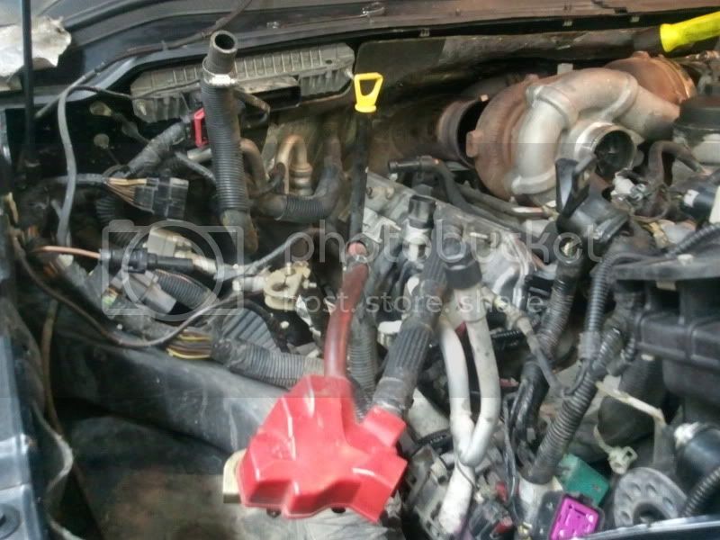

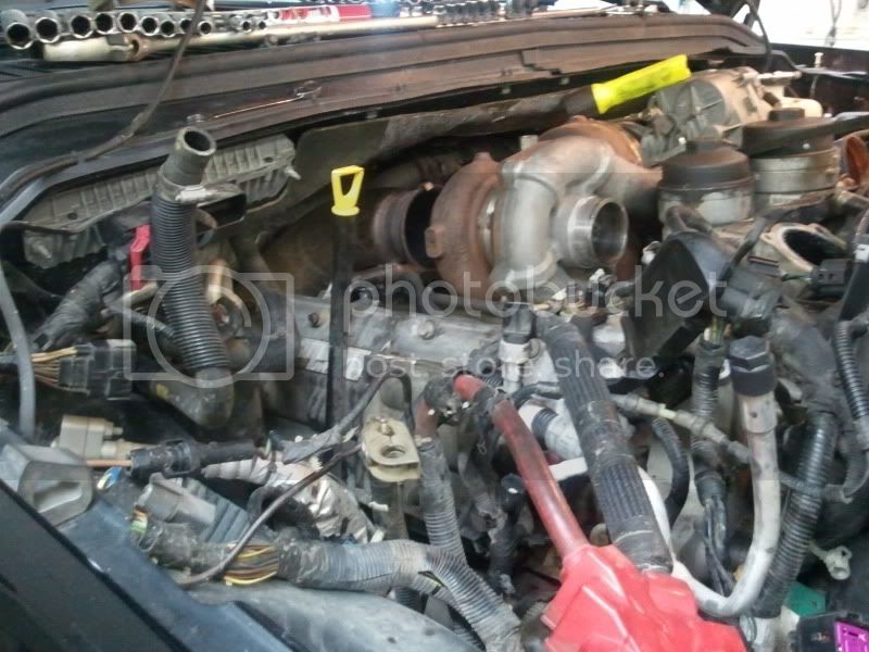

End of day one progress. How do ya like my added power in pic 6, my hood just doesnt close now LOL.
