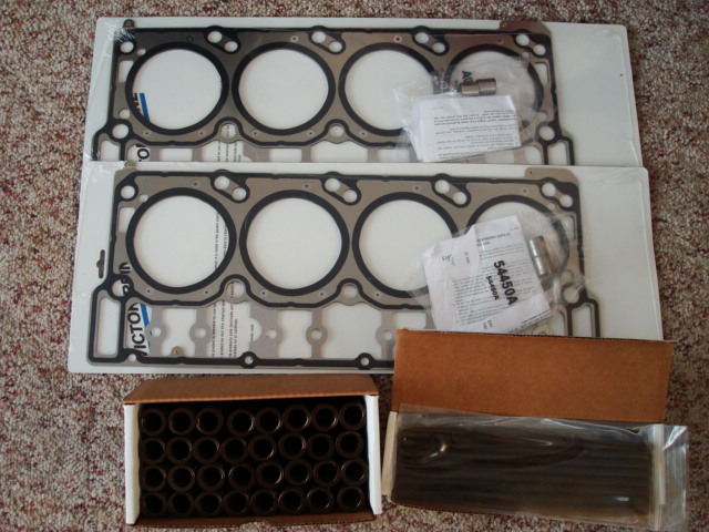

Here's some pics of the RCD gaskets, springs, and pushrods. My truck is an early build '04(build date july '03) with all the '03 stuff. So it still has the original length pushrods...I've heard that ford updated them and actually shortened them. I stood a stock '03-04 pushrod next to the RCD pushrods and they seem/look the same length. My truck has always used 5w-40 synthetic oil since I've owned it and oil changed every 4-5k miles. And had the amsoil oil bypass since about 45k miles...it now has 80k on the odometer. I've heard that the extra pressure of the stiffer springs isn't good on the lifters and stock cam. I don't plan on replacing the lifters or upgrading the cam....just not in the budget. I don't see lifter failures as being a common problem. I know they can happen, but it doesn't happen much I believe. I think it's more do to poor maintenance and high mileage

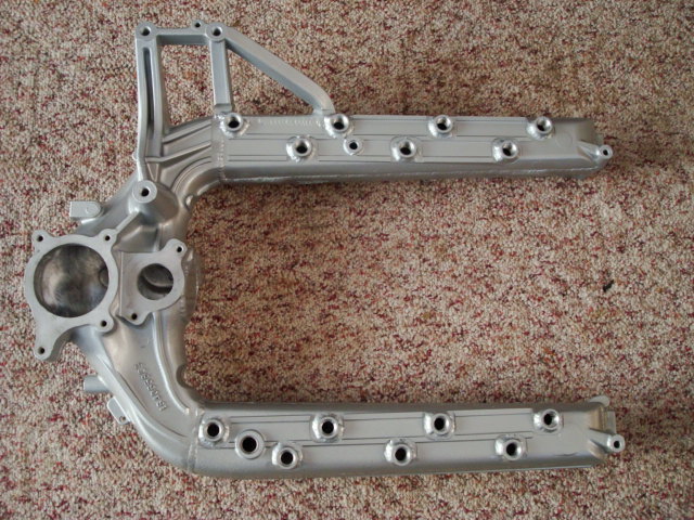

I painted the ported intake the same color as the rocker boxes. Wanna thank Oliver for building a kick a$$ manifold...thanks again man!

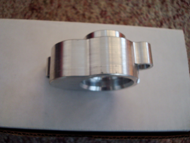

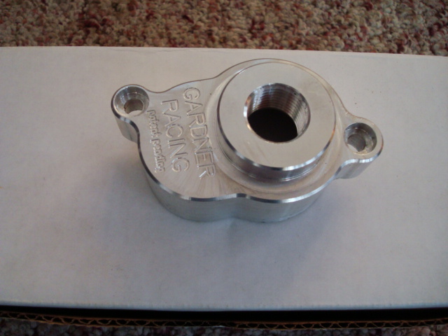

I got the billet oil cooler fitting from Steve at Absolute Performance so that I can send coolant from the oil cooler to the degas tank since coolant will no longer be going through the intake manifold.

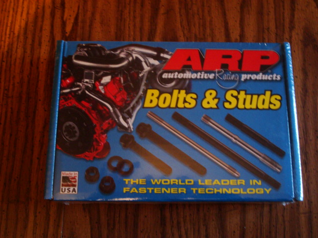

I suppose I could reuse my current ARP's from when I did fire ring head gaskets and ARP's back in '06, but I decided to just get some new ones. I went with standard ARP's again. Thought about Extreme studs and even ARP 625's, but I couldn't bring myself on spending that much on studs. Talked to Jared at RCD and Craig at MPD, and both told me they use nothing else but standard ARP's.

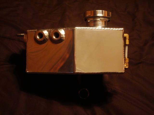

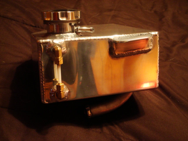

Wanna give a shout out to Nick(nighthawk285)! He did a great job with the polishing as usual...thanks again man!

Aluminum coolant tank installed!
