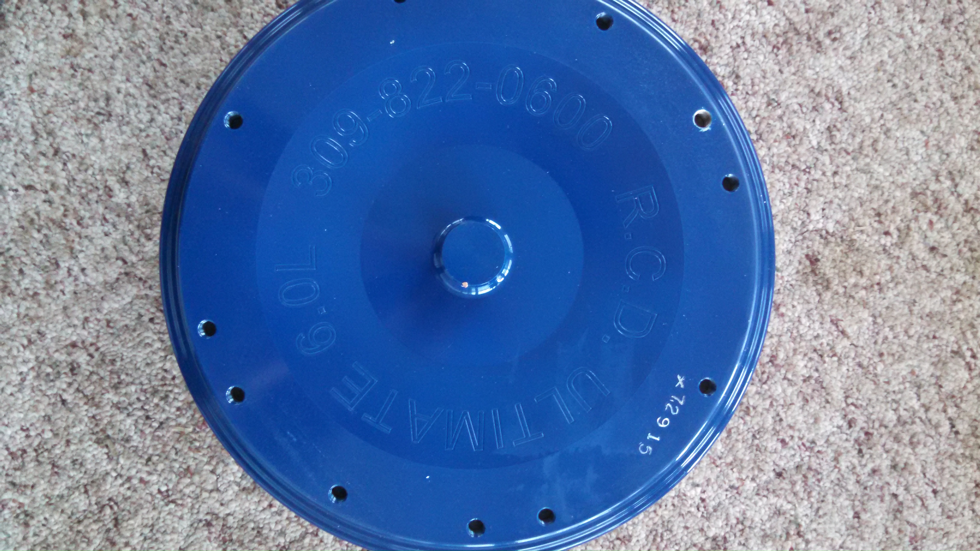

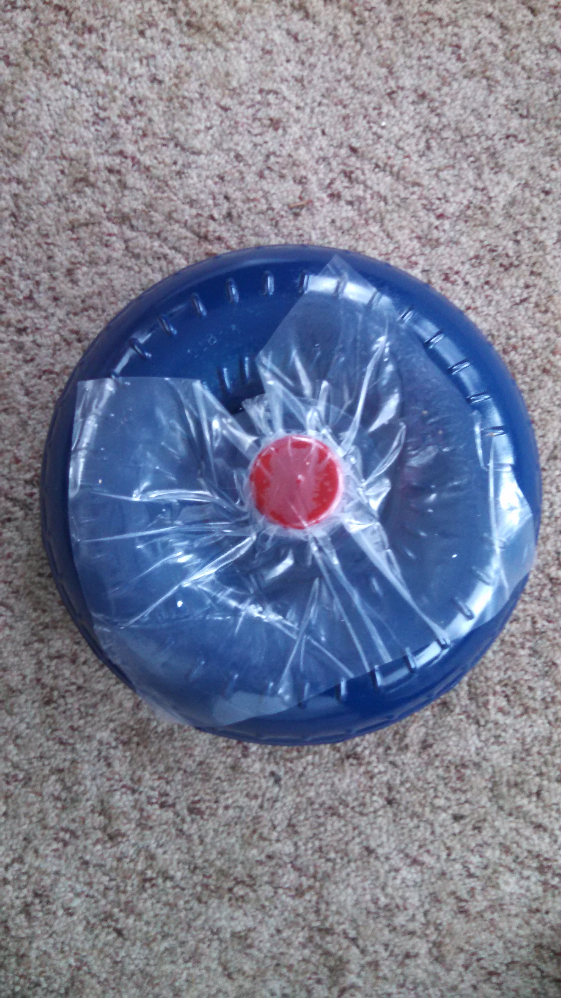

Got the converter from RCD this morning!

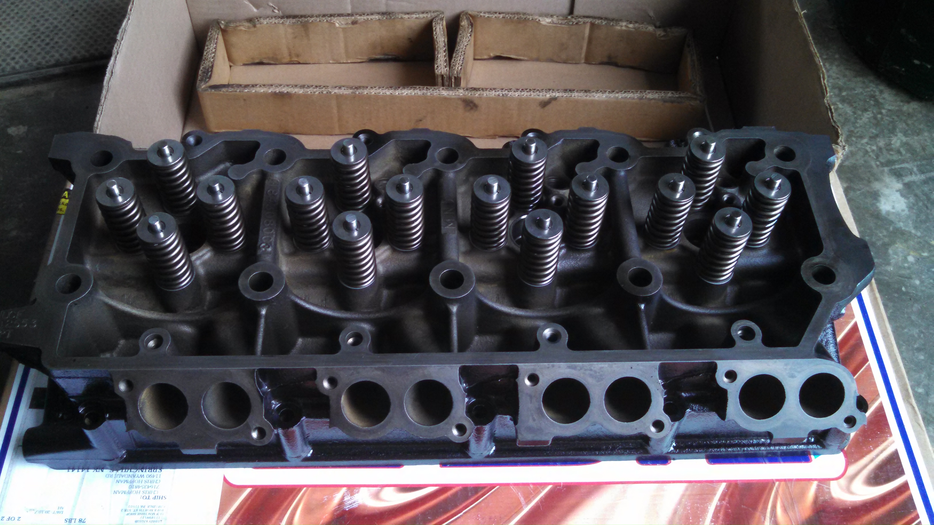

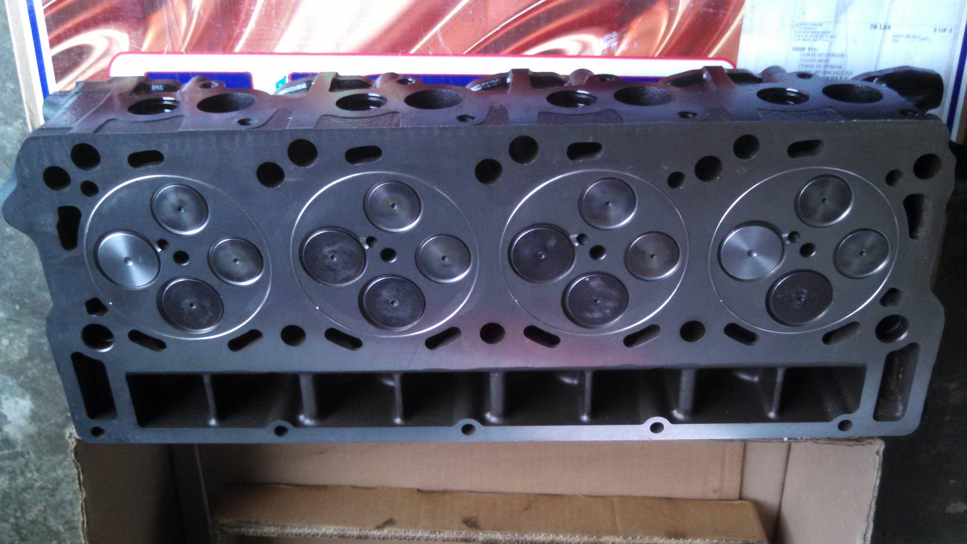

Been a while since I posted anything. Got the UCF o-ringed heads with RCD 120# valve springs last week!

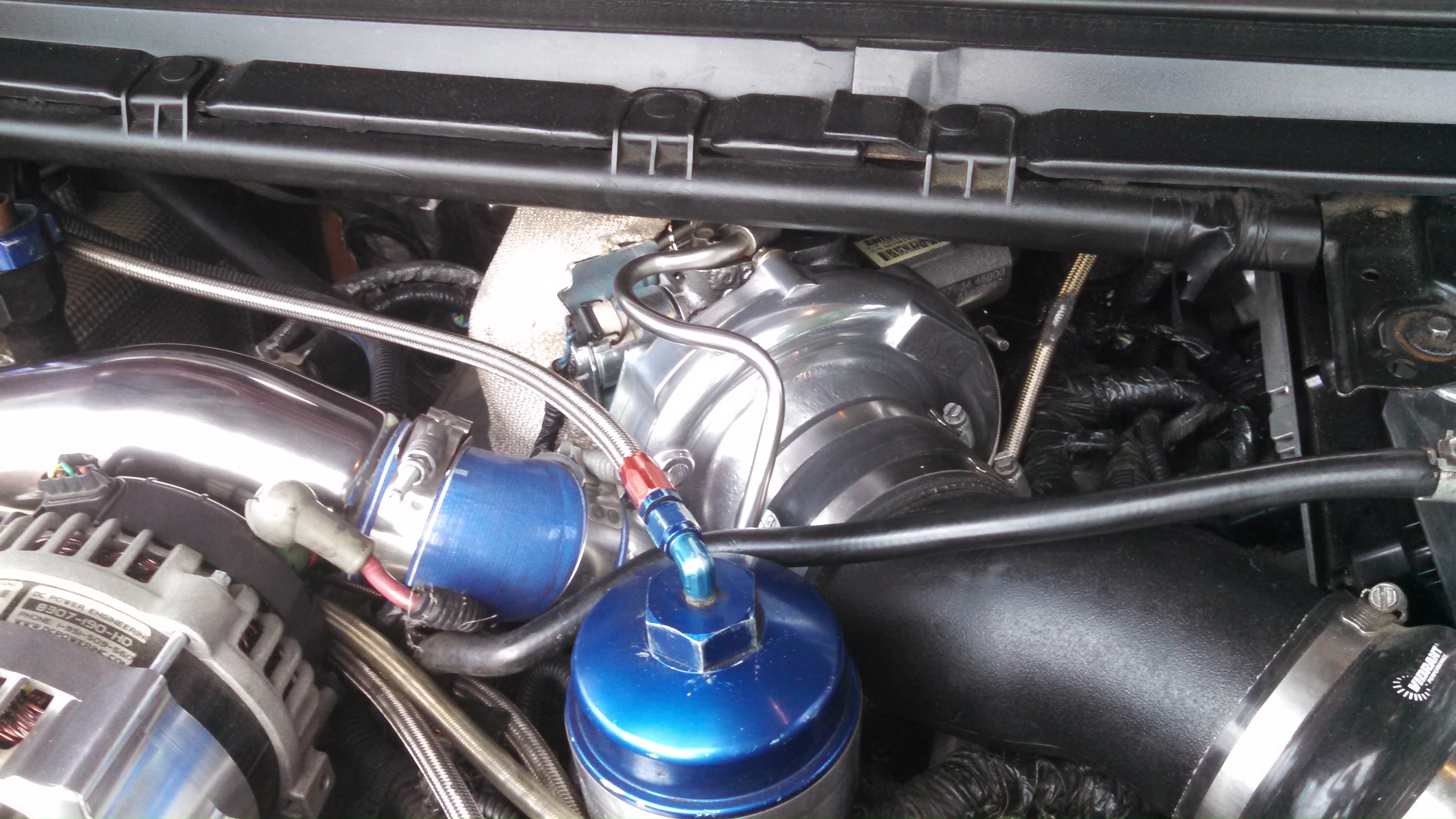

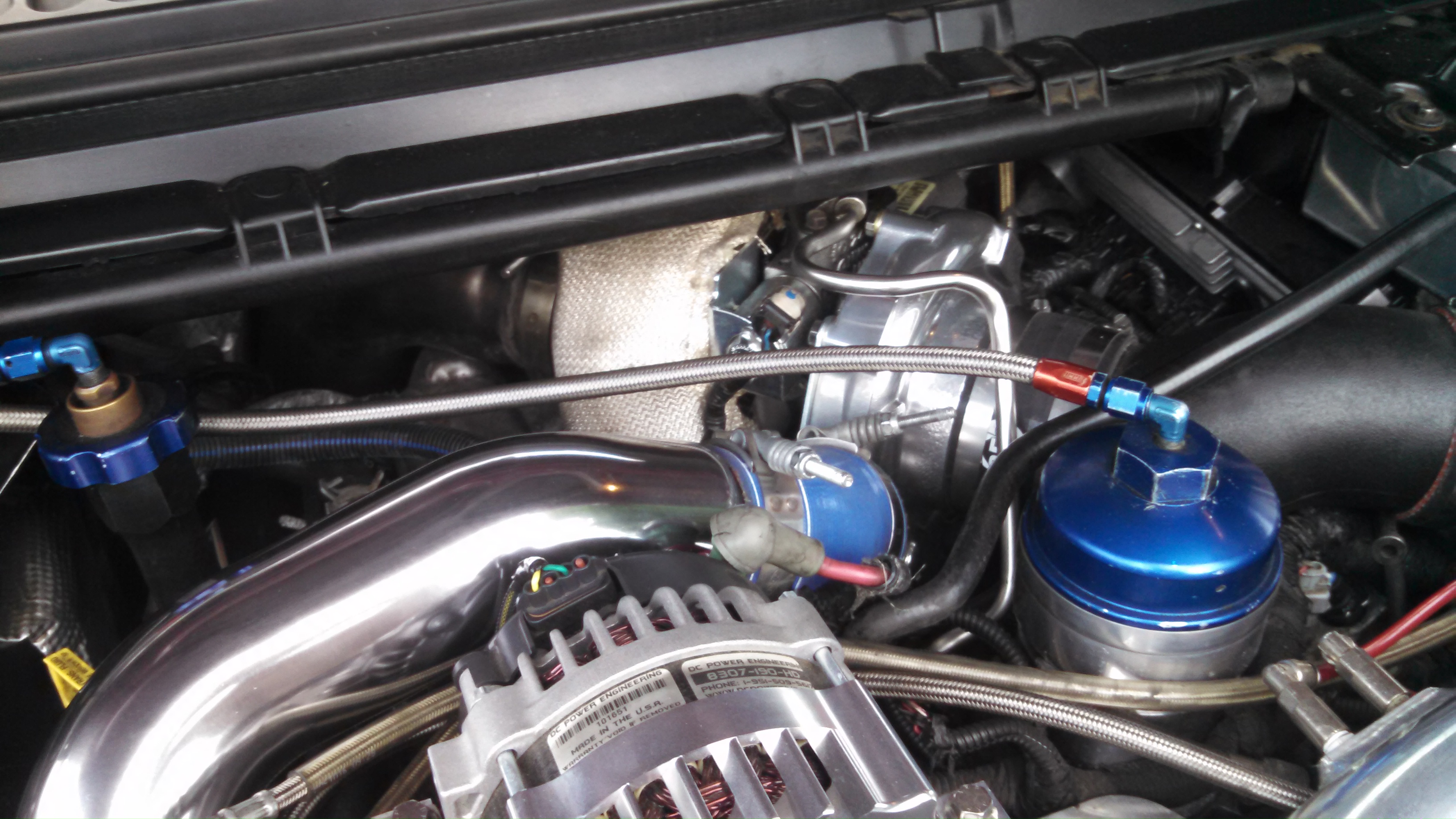

Got the KC stage 2 installed yesterday! Now I just need to get this cab pulled to get the new o-ringed heads and other parts on the truck.

I just read through the whole small build. Trucks sounds like it will be nice once it's all back together. What cai do you have on there I seen the afe tube an what looks like the filter from no limit.

What fittings did you use in conjunction with that billet oil cooler outlet/coolant delta kit? I like the look of that setup, and think it would go along nicely with my new vision coolant bottle!
