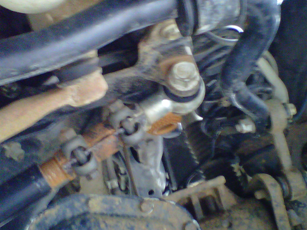

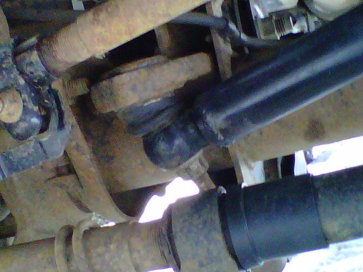

Take a picture of the axle from the front looking at the track bar and track bar bracket and post it up.
The alignment shop will know the specs, you need to find out if the tried to put it back to the factory specs or not, factory specs do not work on lifted trucks. who put the kit on the truck? Did they install the alignment cams in the ICON kit when the truck was lifted?

Here is some pics i took of my trac bar on the truck right now.

Did you watch the installer torque the trac bar to the required specs? They are not the same as Ford specs. I believe the stock trac bar requires 350 ft-lbs and the Icon requires over 400 ft-lbs. That could explain why the stock one works and the icon doesn't.
Also, do you have any bumpsteer issues?

You are trying to throw parts at the problem hoping it is going to fix it, which it may seem like it helped, but you are only masking the real problem. You need to get the specs on the alignment, I am willing to be you only have about 2.5* of caster when you need more.
I ran an ICON track bar for over 100k miles and didn't have an issue with it, it was on 3 different trucks with a 2.5", 3.5" and 5.5" lift. My trucks were not street kings either, it all has to do with the setup being right.
