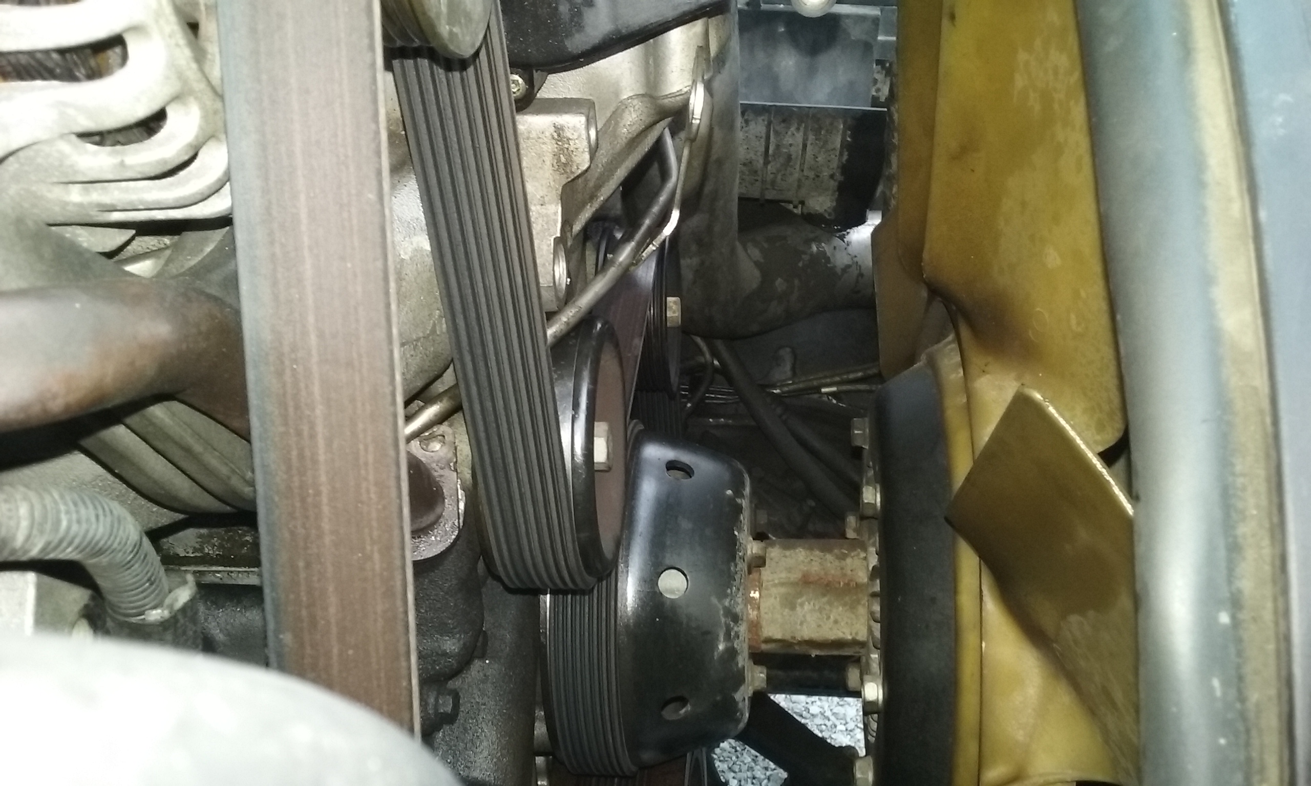

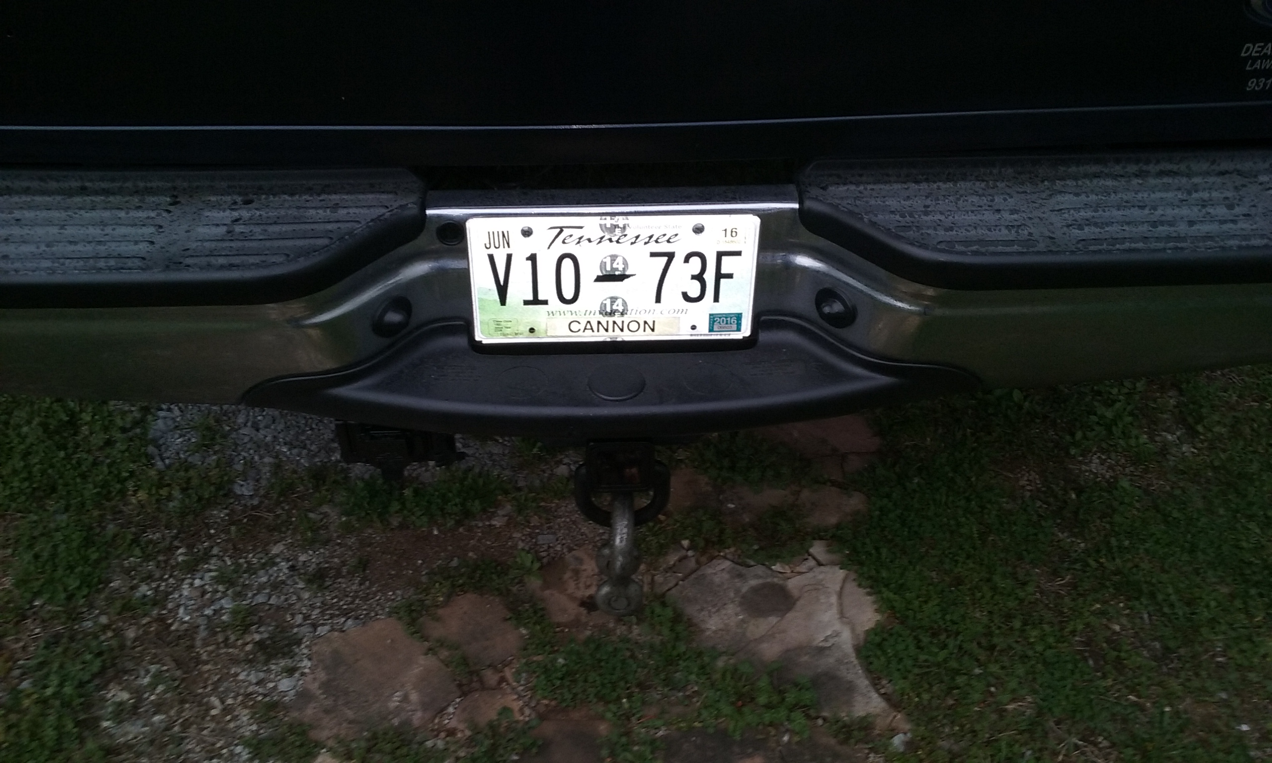

No white smoke. Just weird the hpop all of a sudden though I have oil all over in the front of the motor underneath on the tailgate everything. I have some pictures but I'm on the forum with my phone I haven't tried loading pictures that way.

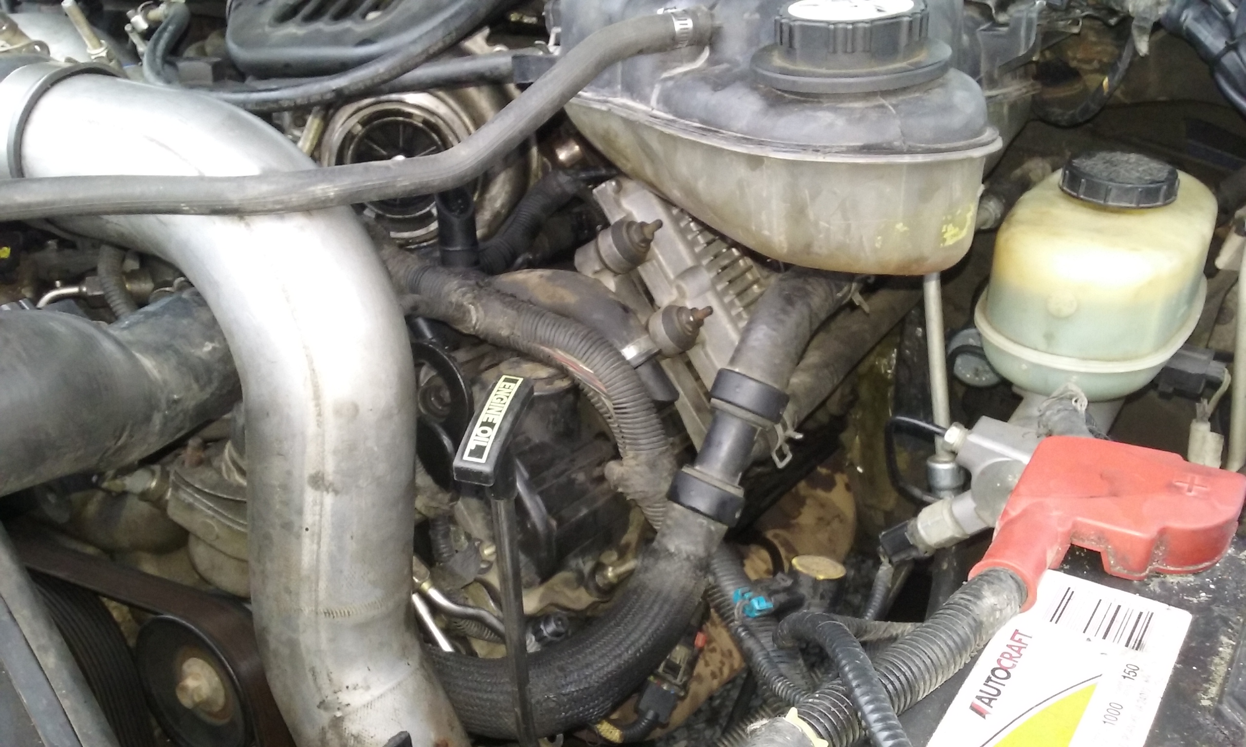

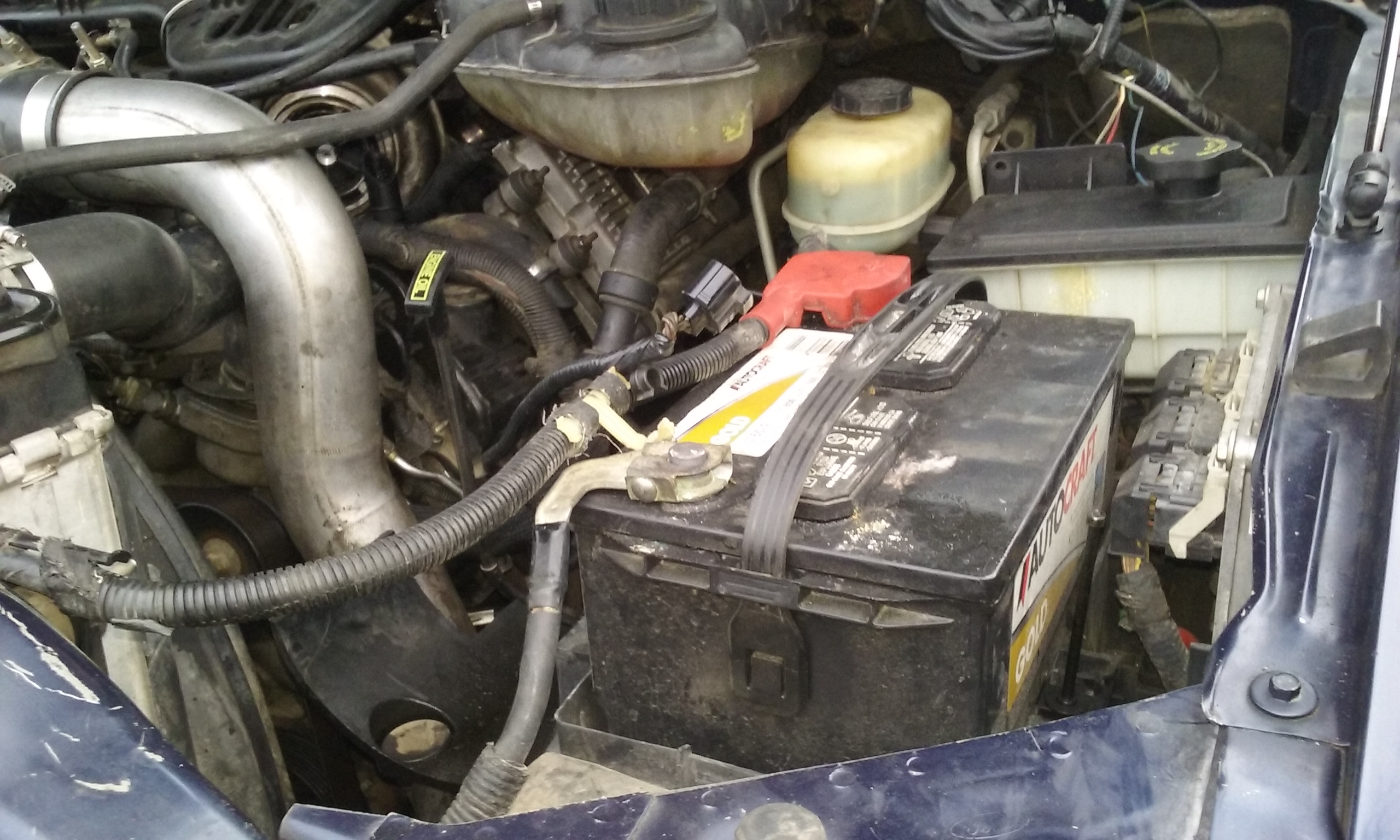

Yea noticed that my ficm was in with on bolt I could grab it and move it alot. Degas bottle had one bolt in it and barely any coolant. I'm real pissed off with this guy my truck came back after me having to cuss him out and looks like he never did anything to my truck till the last minute. He had it for 5 1/2 weeks.
