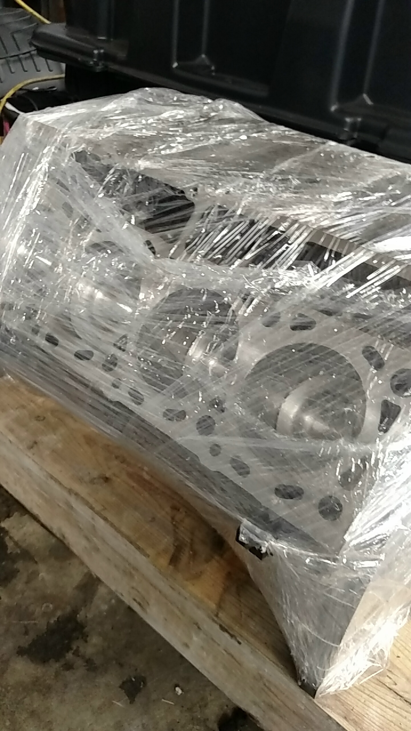

Got slammed at work past few weeks, so for a quick update- motor and heads are NC bound, and it feels like Christmas in July.
btoler4th
Apr 30, 2015
152
Mt. Olive, NC
Straight from Engine Services in GA. Warapped up until it's time to get down to business.

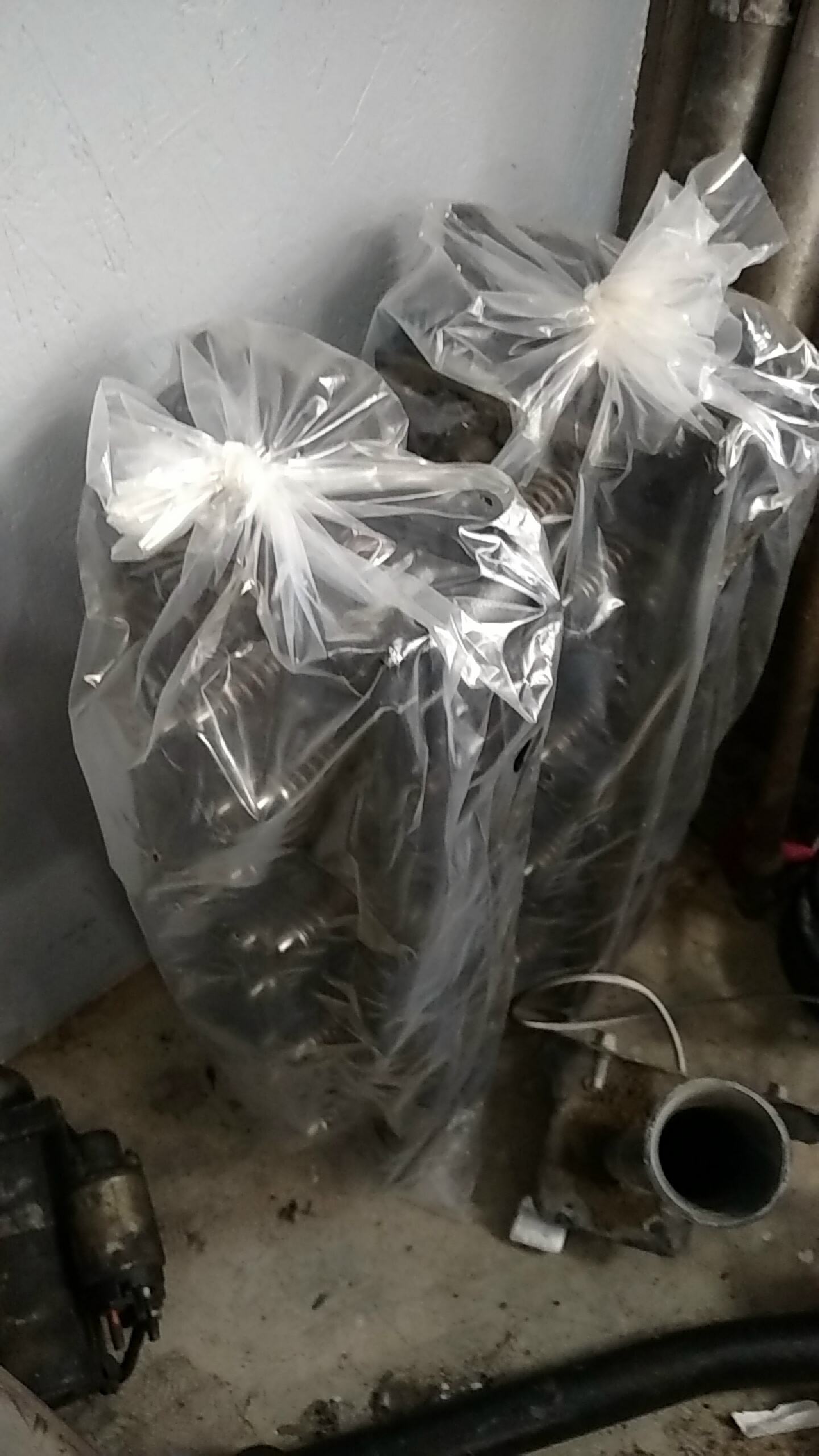

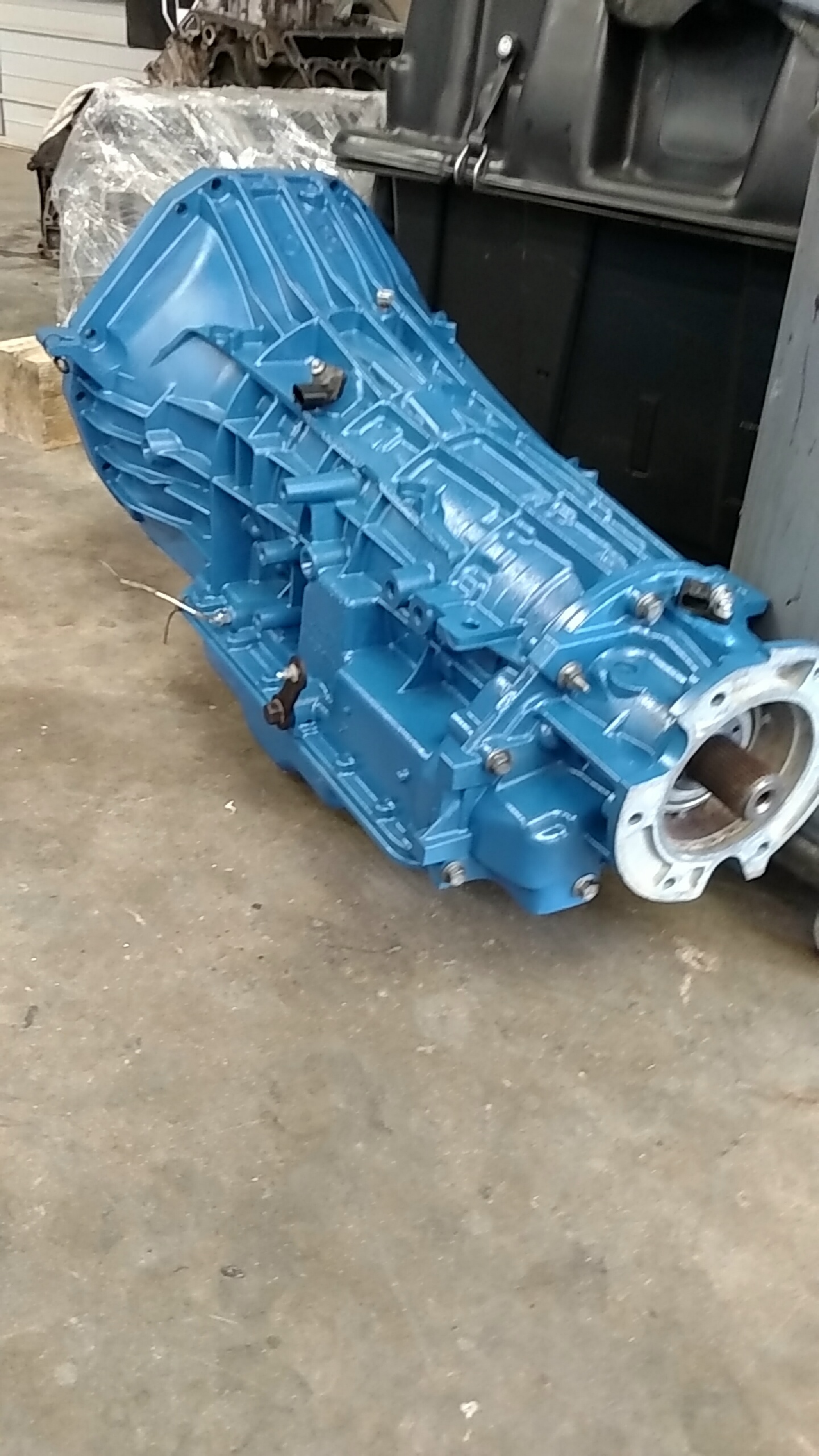

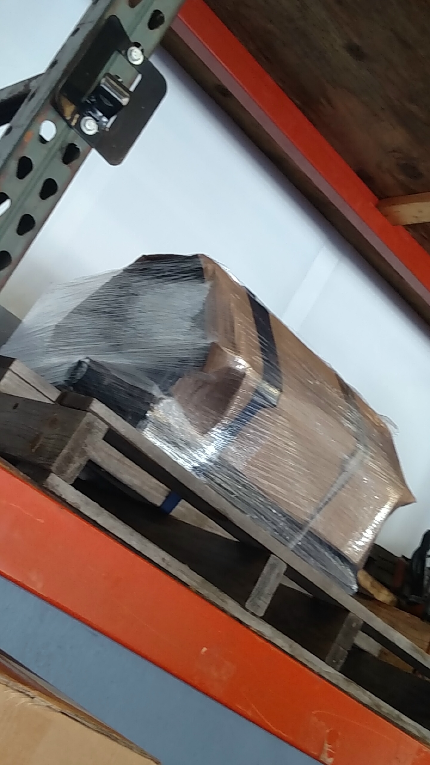

Motor and transmission investments.
