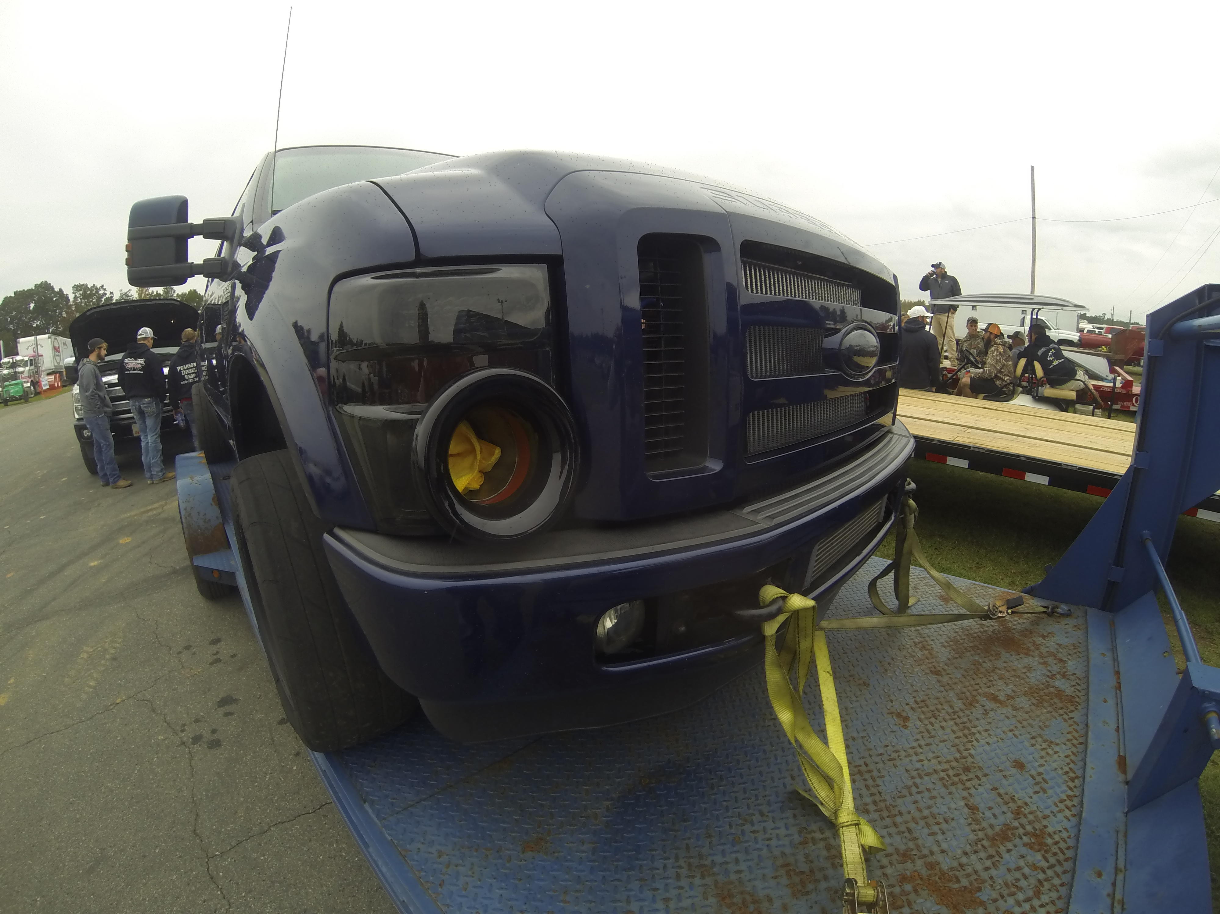

Rain held off for longer than I thought. Saw a few solid passes, and some bada$$ trucks....

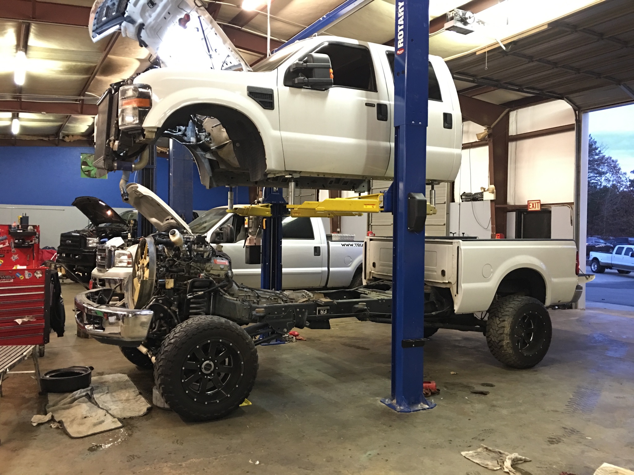

Hell yea me too, taking my go pro up there tomorrow to get some cleaner shots. Hoping we can get the motor out, and new one in. Front cover is chewed up, and just ordered 4 new stock injectors. I'm sure we'll find some more surprises as the replacement progresses. Oh well. Got to pay to play!

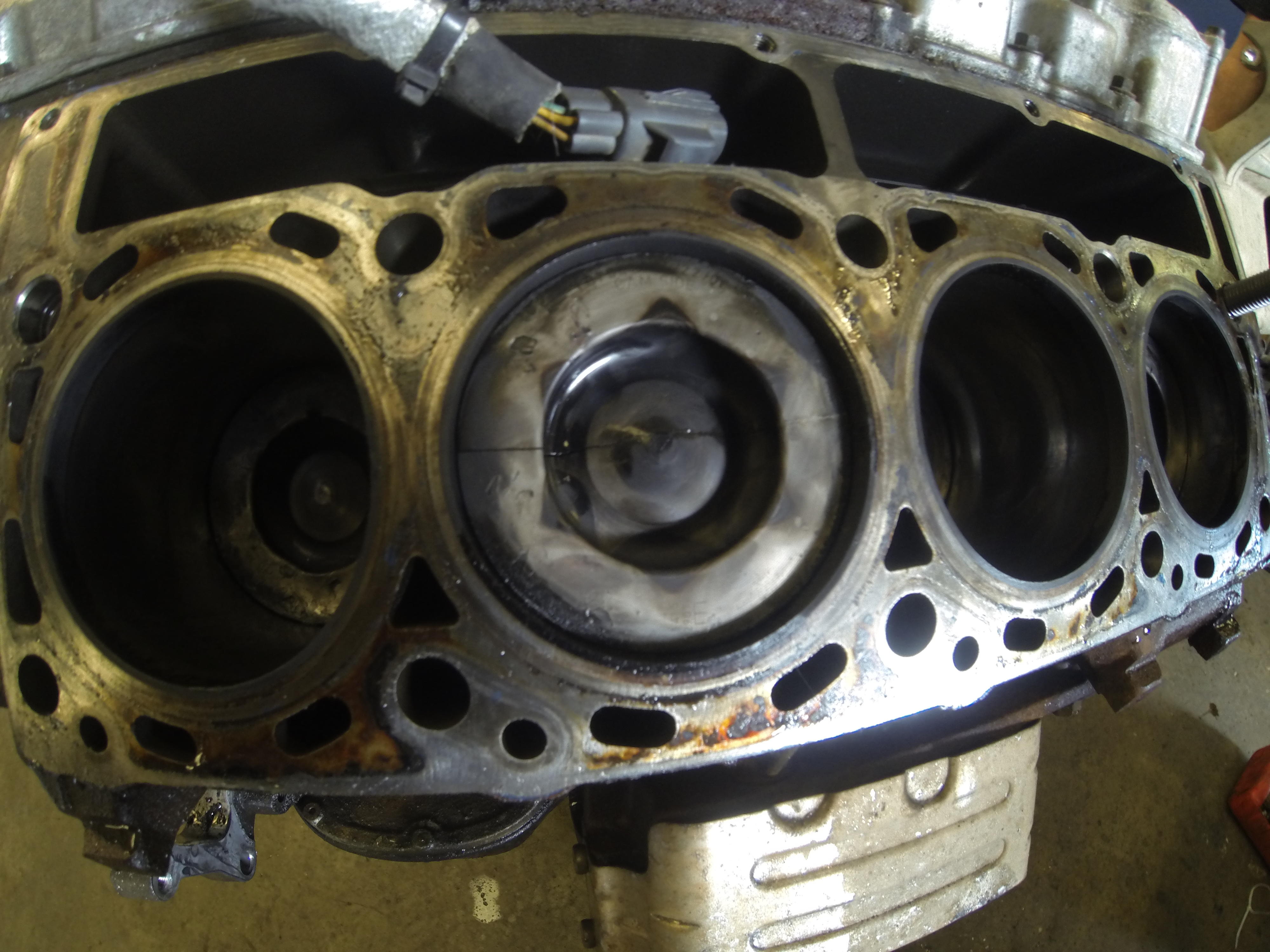

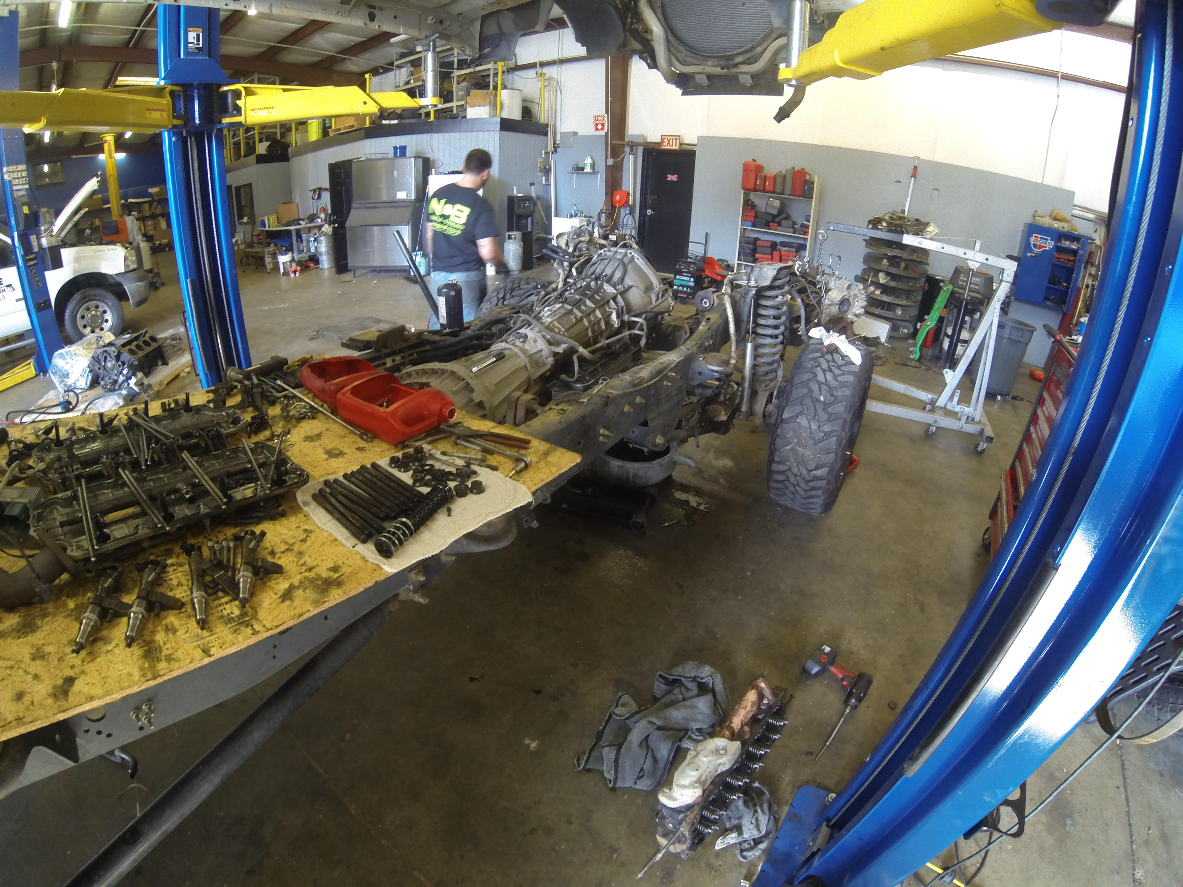

Friday surgery @ NCB Diesel & Off road
#5 is almost cracked all the way across. Multiple valve stamps on the other pistons.

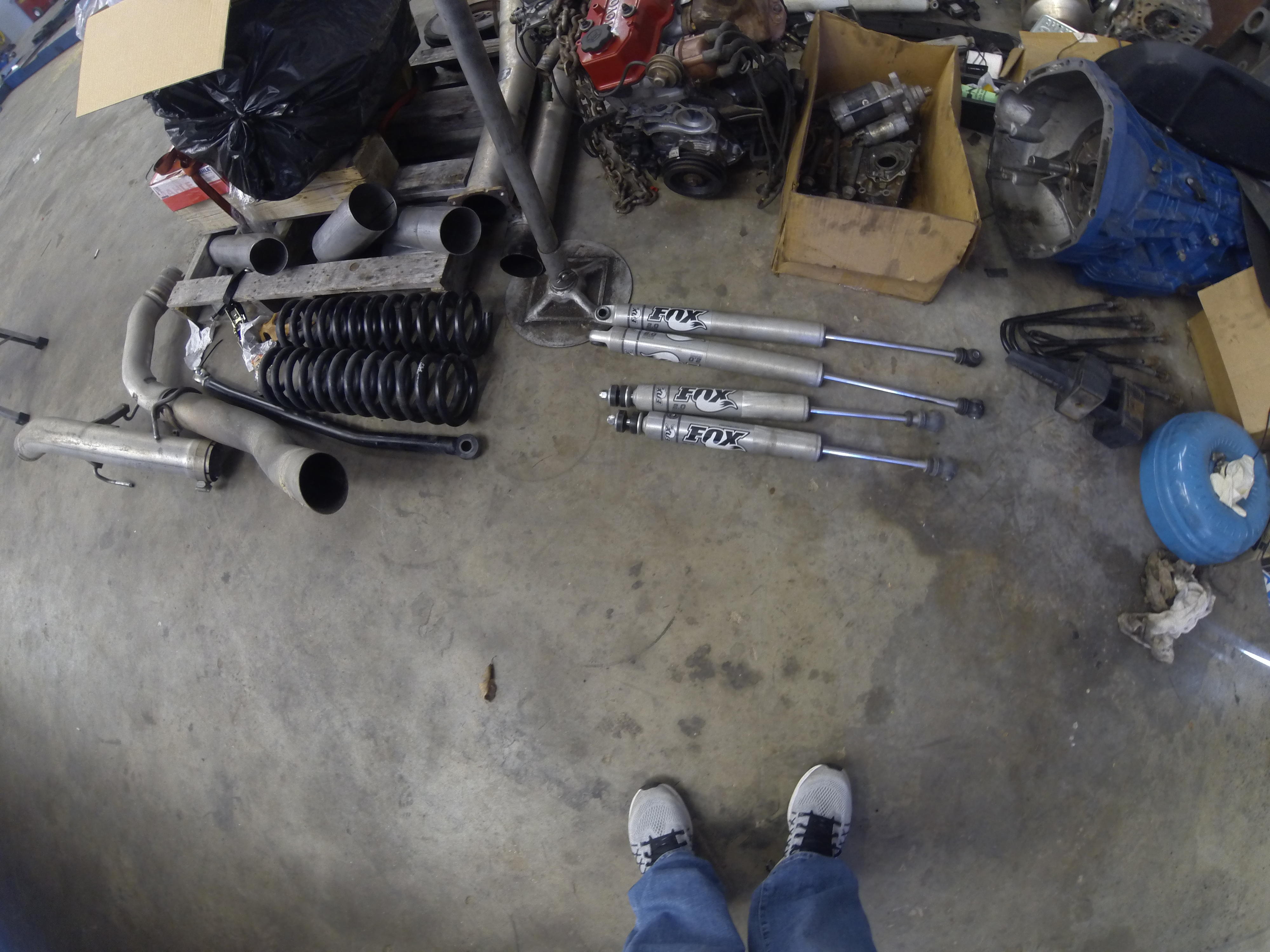

Perfect timing for me- a customer was selling his Carli commuter package, and returning his f250 back to stock height before he traded the truck in. So while my truck is in the shop I'm probably going to have the parts installed. Believe he had around 12-13k miles on the set up. I have heard nothing but good out of Carli , and was very tired of the 4'' lift on my truck. I think it will sit perfect, and ride like a dream with the commuter kit.

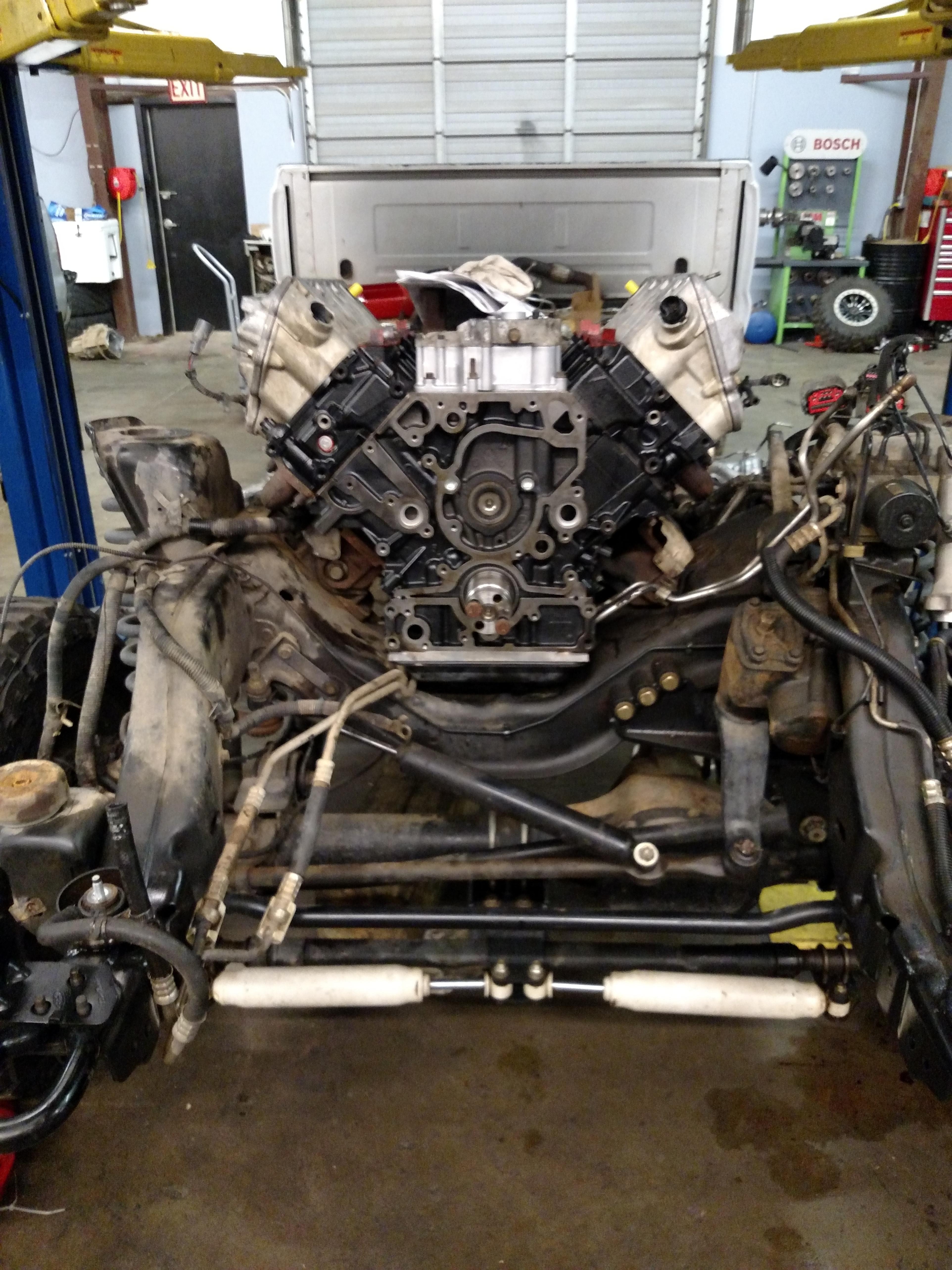

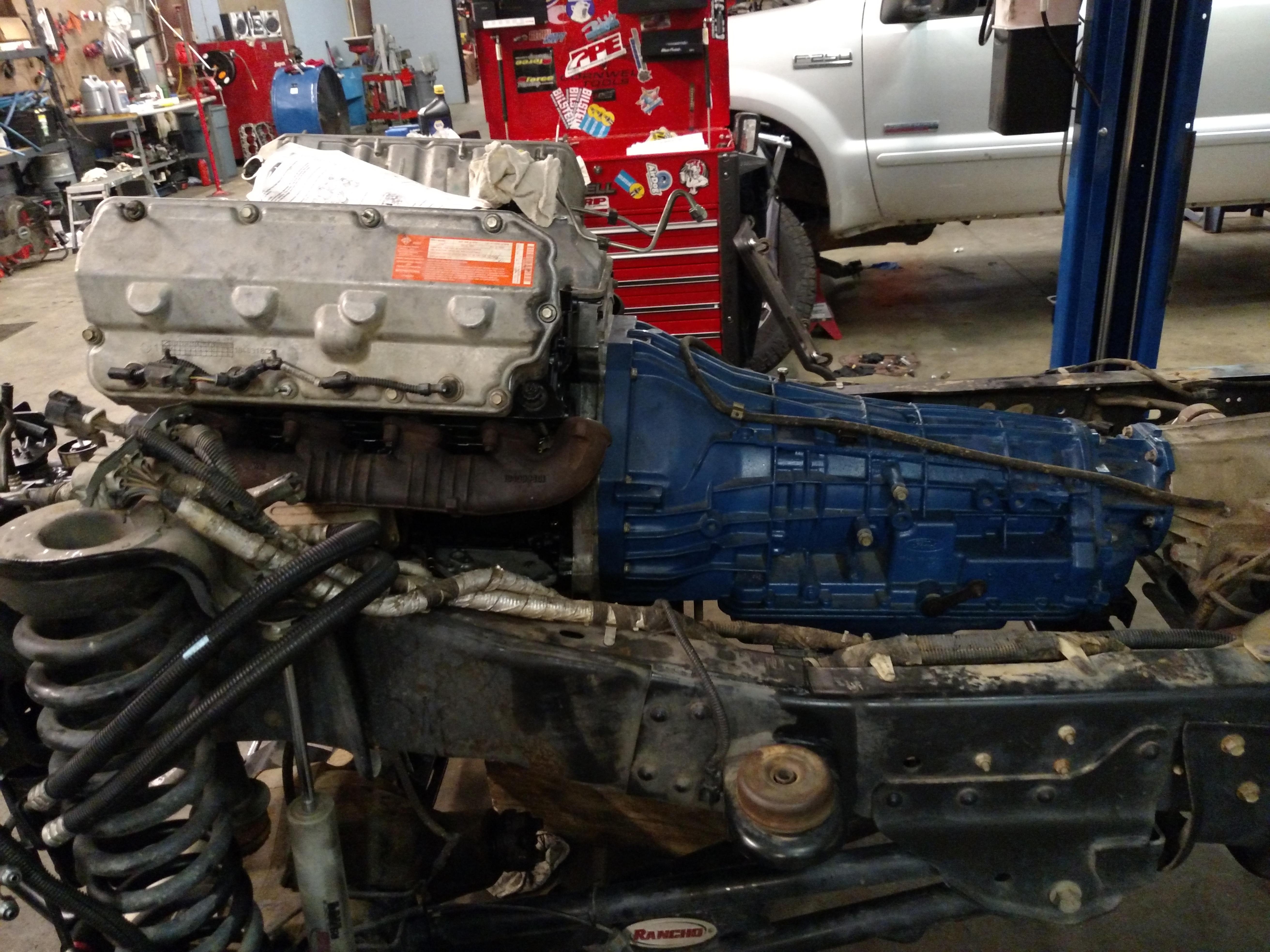

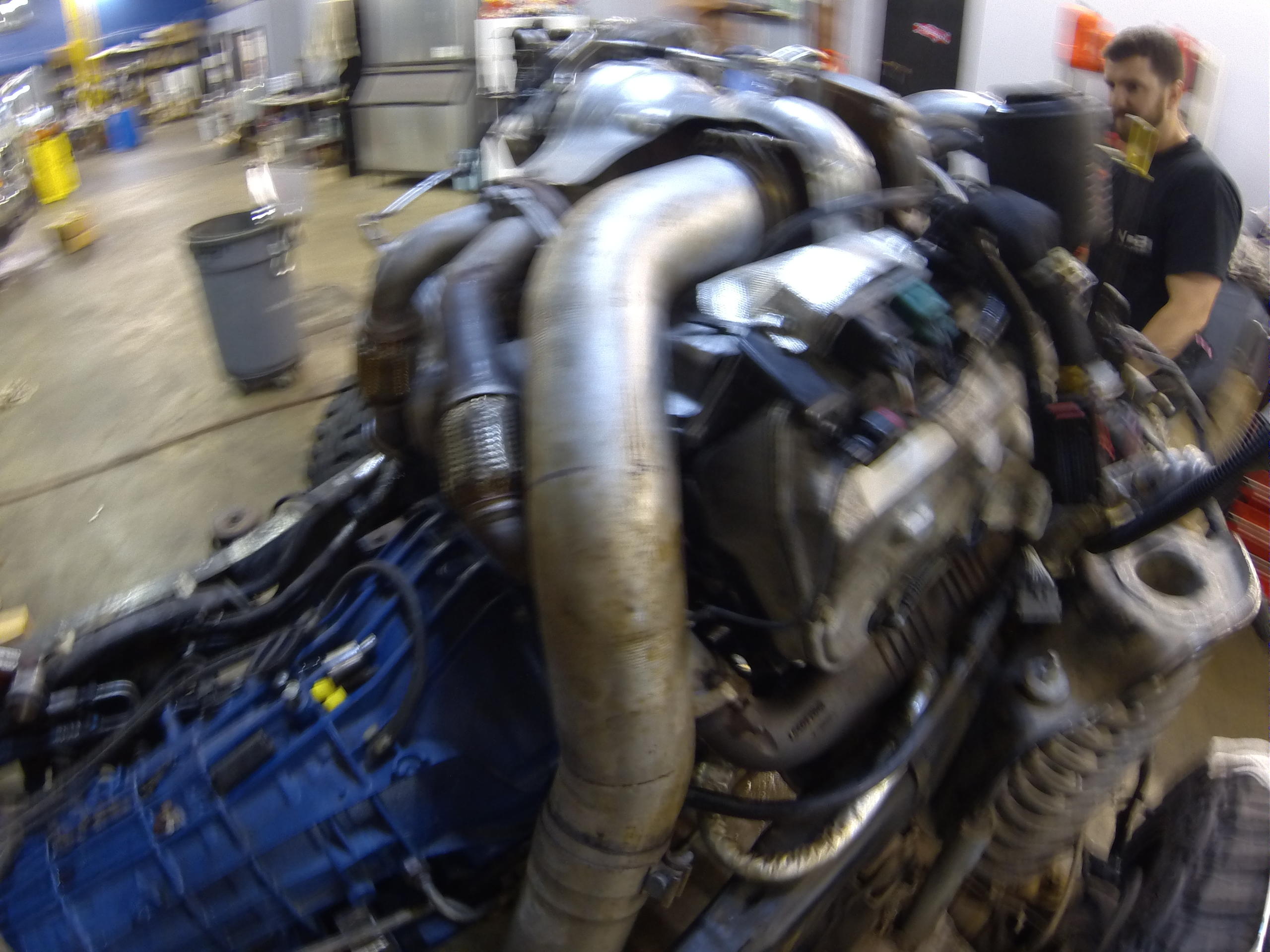

Trans and motor installed. Both built to hell. Doubt I'll be tearing this combo up anytime soon....

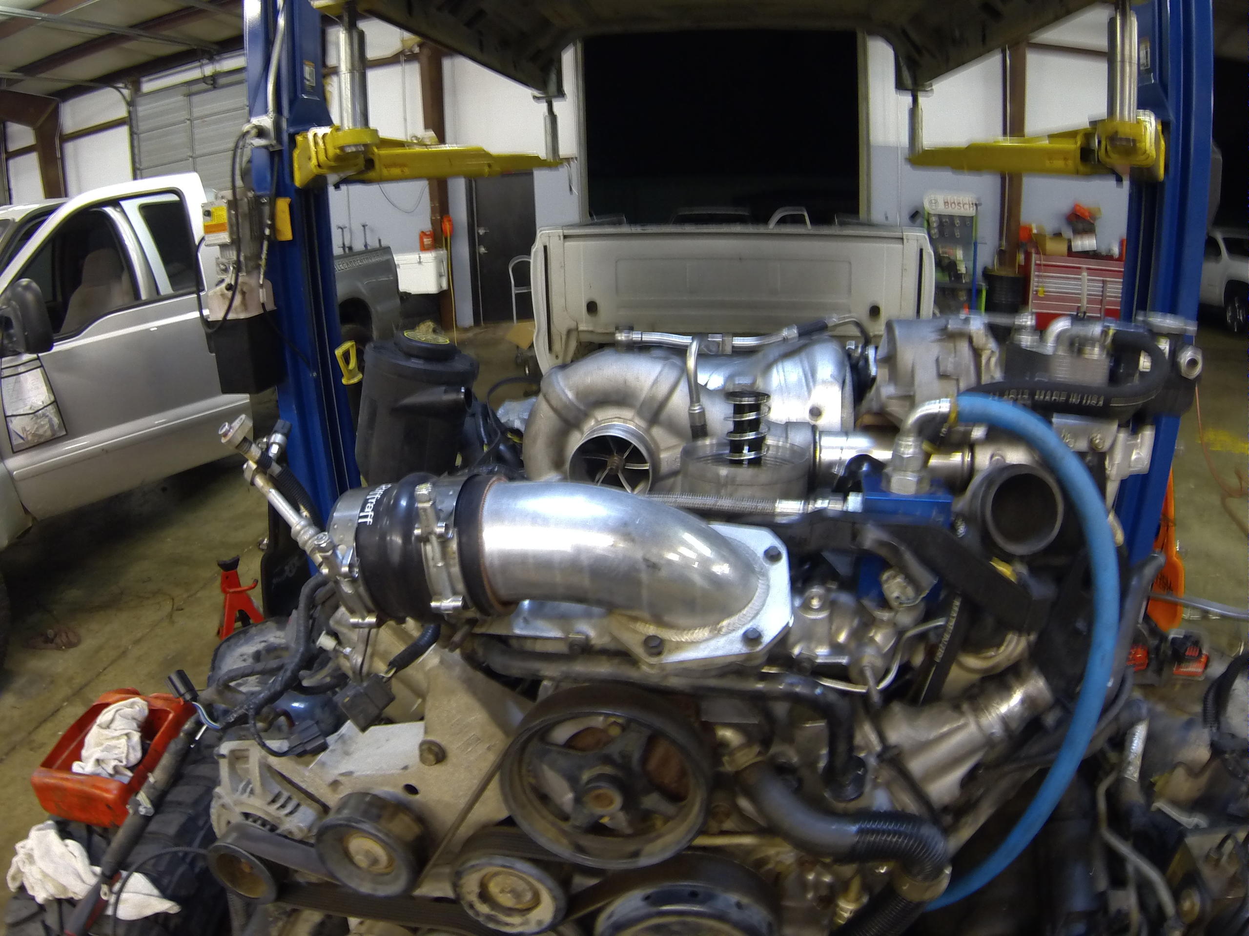

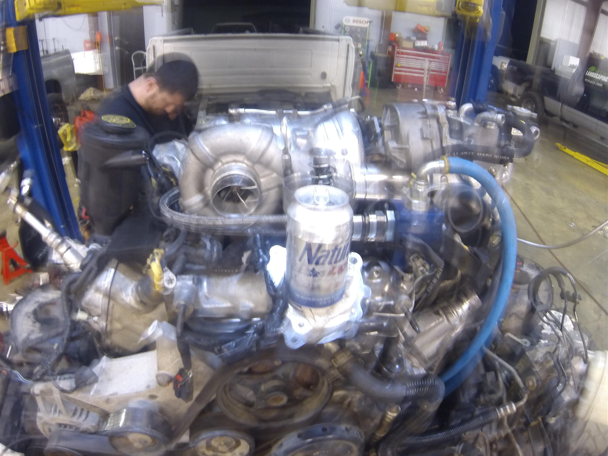

Got the snails on. Prototype EDE with some mods.....I'll leave it at that, and who I got it from. Decided against a single etc....very pleased with the build. NCB has done an excellent job. I bring them beer and they let me hang out. Win win situation for all. Few pics turned out blurry.
sootie
Oct 3, 2012
11,853
39
Prototype? those look like just bored out stock housings with larger billet wheels, unless i'm mistaken...
btoler4th
Apr 30, 2015
152
Mt. Olive, NC
Well since you asked...the 59hp was a prototype built for Aaron to test.He never installed it, the LP is a 72. I was messing around. The 59 has some additional turbine work. No clue if it went into production. Owner at NCB took set up off his truck a while back, and I traded him my tow powers and a good time for them.
