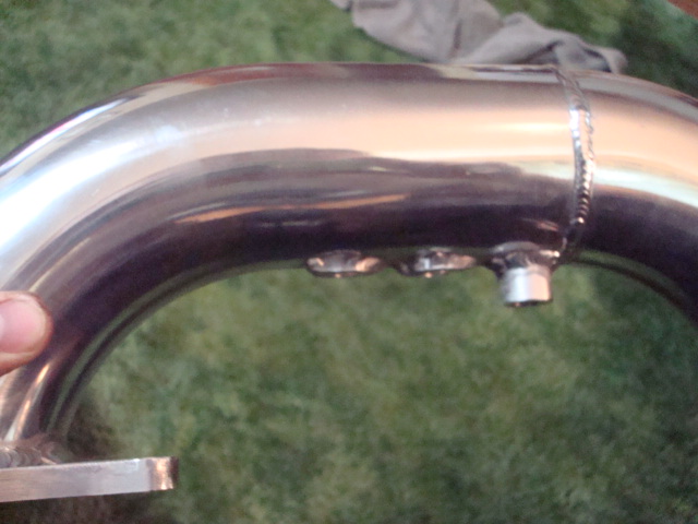

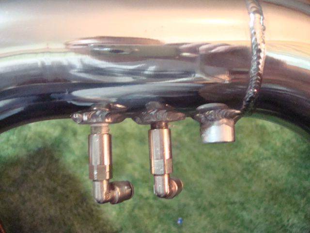

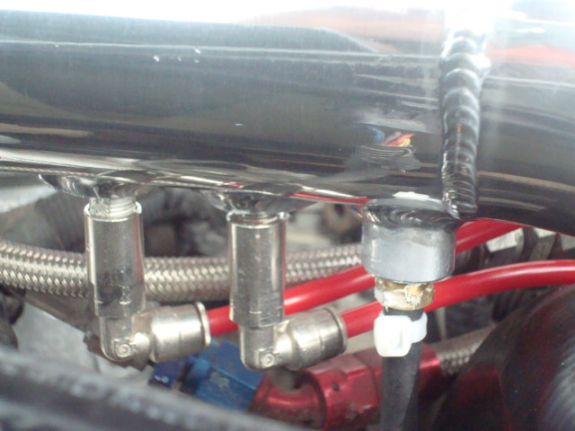

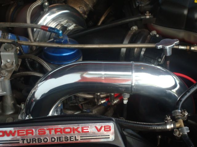

Just thought i'd share some pics of my No Limit cold side CAC pipe. I got it through Steve @ Absolute. I had Mike weld in three bungs...two for water injection nozzles and one for the boost reference. I had to grind down the two bungs for the nozzles so that they will atomize into the tube rather than the bung. Looks awesome Mike...great work.

strokin6L
2,979
Springville NY
Those are nozzles holders for my water nozzles from Snow Performance. The third bung is my boost reference for my incab boost gauge and for the water injection boost controller.
