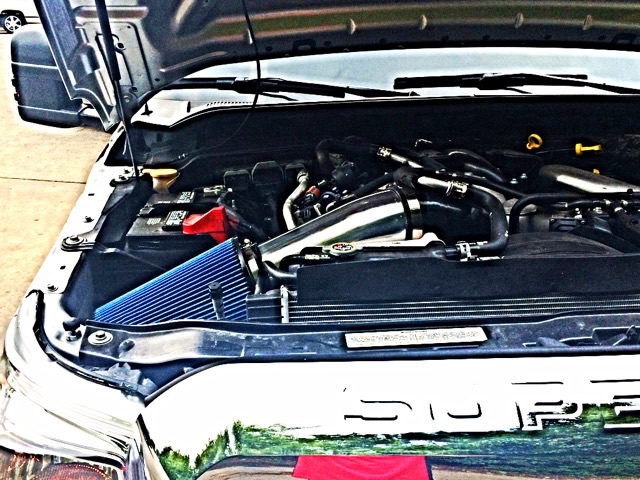

A little update, I received one of the prototype No Limit Fabrication 5" Intake last night, polished it up and threw it on I couldn't be more pleased with the results. If you are looking to get an intake for your 6.7 this one is definitely the kit to go with.

I read earlier in the thread that you were planning on installing the dual fueler kit on the truck, are you going to try to figure out how to make the intake work with the fueler kit or change it out? In the review thread he said that it won't fit together, I'm guessing because of the large pulley, but I have the dual fuelers and would love to run this intake as well if some one can figure out how to make them compatible.
When I install the dual fuelers I will let everyone know. With a little fabrication anything is possible. ;)

I finished up the dual pumps about an hour ago. Installation went pretty well once I figured out what belt I needed. The No Limit Intake worked it was very close to CP3 pulley but from what I can tell it does clear.
We did design our pump kit to work with the stock intake, and the factory manifold/turbo system. So I hope it clears:) ..... Ready for a turbo kit yet?
Zane you know I am ready! Bentley and Aaron are making me be patient and wait for it. :(
