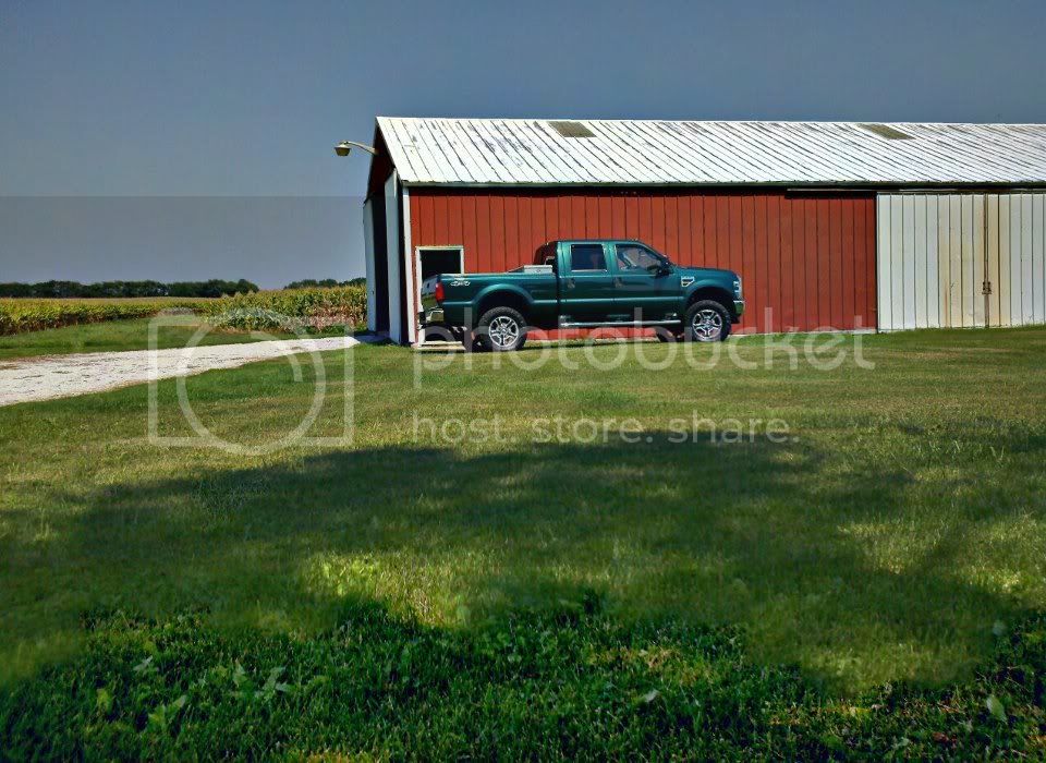

Trucks going under the knife. Gaskets are apparently no good. Here's some background to start.
Bought the truck with 66K on it, up to 82K now. Had problems right off the bat. Had a radiator replaced by previous owner, had a large coolant look while test driving. Leaked all the coolant out and got pretty darn hot. Temp light going off and what not. Just happened to be on my way back to the dealer. Limped the couple miles back after it happened and they fixed the leak/leaks. 4-5K later had a no power issue, turned out to be a bad EGR temp sensor. Warrantied no problem. Trucks running good at this point so I order a tuner, intake and exhaust. Im like a kid on Christmas, i'm pumped :thumbsup: . Trucks running well so I decide to take a buddy from work for a ride (drives a cummins). It seemed to me that it wasn't making the power that it was a couple days ago. Thought I was going crazy. Well I happened to notice it was low on coolant and for obvious reasons (it was sprayed all over my engine). I cleaned it all off and tried to make it puke again. Guess what, it did.
