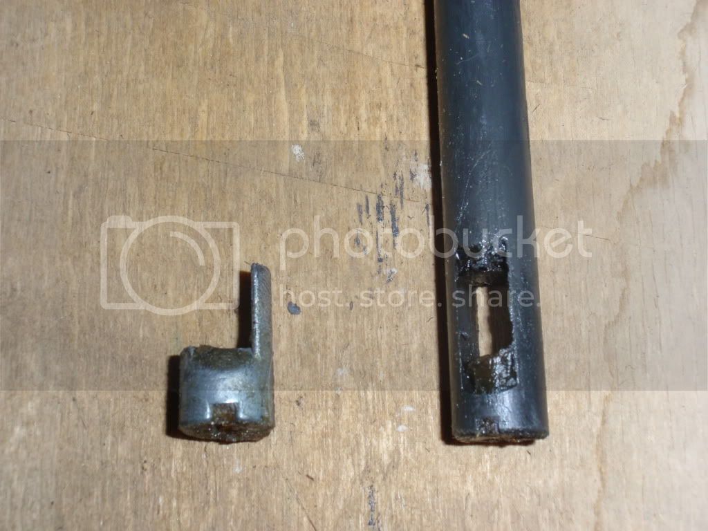

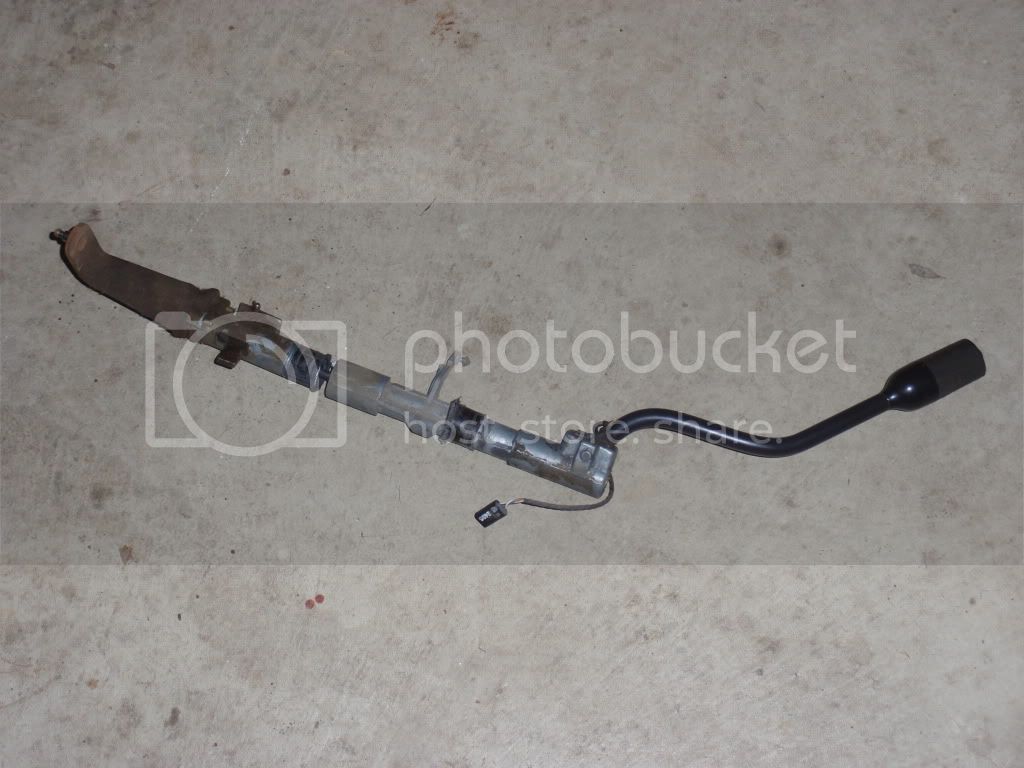

Nice. :thumbsup:Both typical problems. Most ford dealers keep the shifter shaft in stock. Replace the shaft, housing, and two bushings!

My shifter is kinda sloppy, would that be the bushings or that whole shaft?
Just sloppy? The bushings are probably gone. But if your in there, just replace it all. They are known for going bad and breaking like LawnRanger's did
