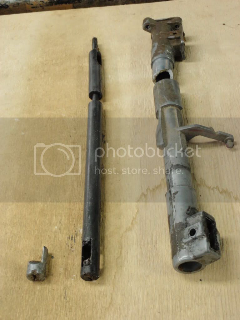

davey99, is the slop in your lever back and forth, or up and down? If it's back and forth, it may be a broke shaft and not the bushings.

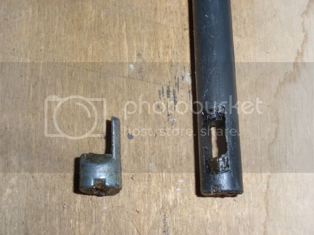

I was looking at the "turd" ( around my house, this is what we now refer to the back-up plow truck as, thanks to Garrett ) and noticed a large piece of aluminum laying where it shouldn't be. It tuns out the back end of the shaft is broke off. This is why, in the turd, the lever is sloppy back and forth.
This is the chunk that broke off beside the shaft I replaced in the plow truck.
So now that I know what I'm doing, I get to do it all over again to the turd. :redspotdance:
