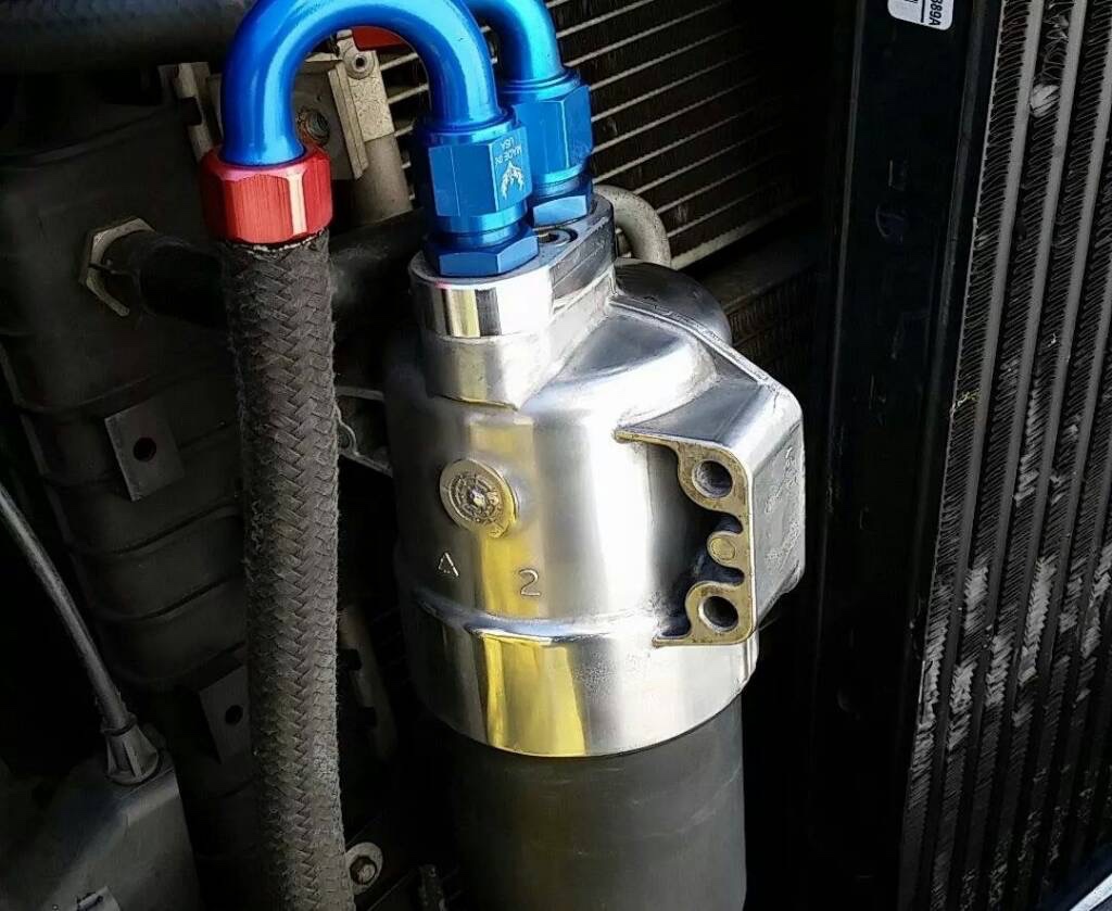

Anyone running a fan on their air/oil cooler? Also is anyone using the van oil filter mount?
I know the MPD Cooler delete kit utilizes the van filter. They make a billet adapter so you can run lines to it. I've seen it mounted on two trucks. Looks pretty good. Uses the same filter as stock so it filters the same.
This is on mike corsillis truck
