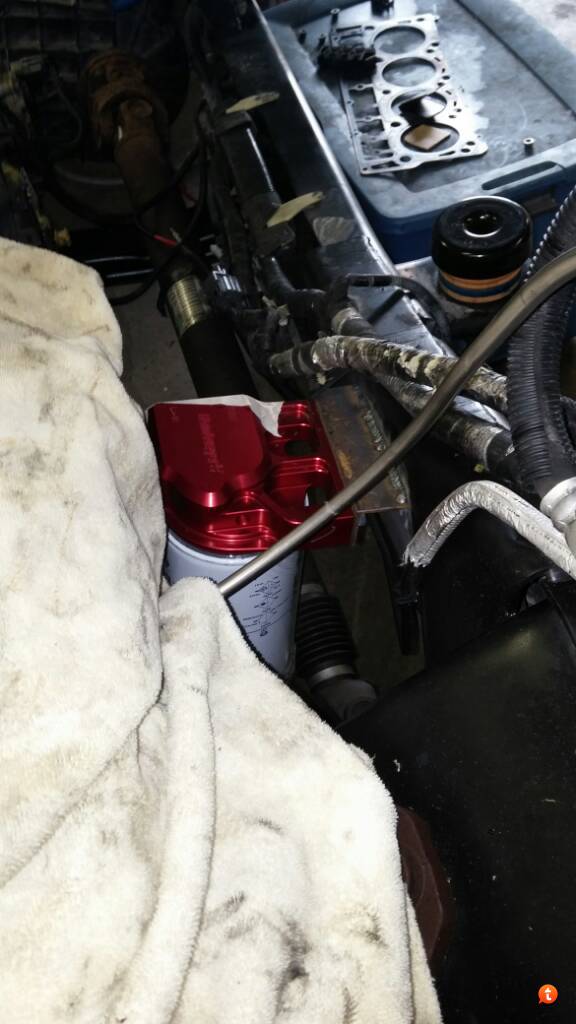

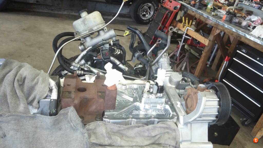

Here's what I got so far will add more pictures as I complete it.
Sent from my SM-G900P using Tapatalk

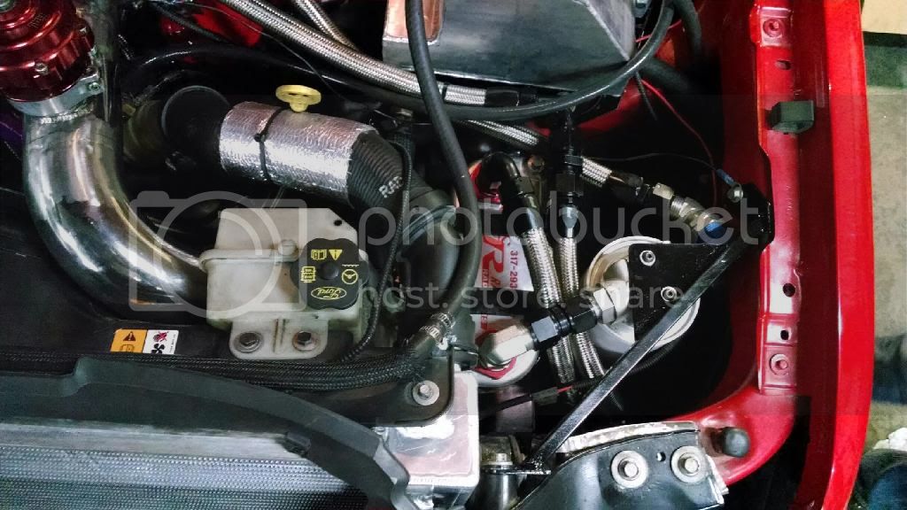

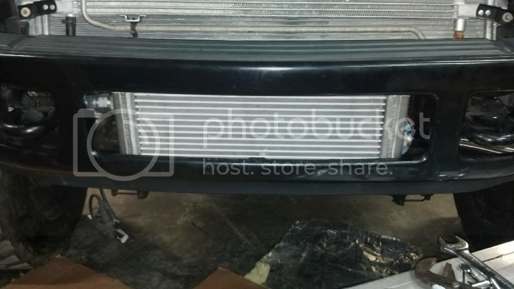

If I did mine all over again I would do mpd plate. RCD filters head and filters(no line or fittings). Fluidyne oil to air cooler in the front bumper and run all my own -12 line. Would be a very nice setup.
blk350on20s
Jul 5, 2011
2,720
Oil to water cooler and filter head
Oil to air cooler
MPD plate
Keeps my oil at 182-185. It got to 194 on a 7 mile 7% grade in Colorado. Did awesome.

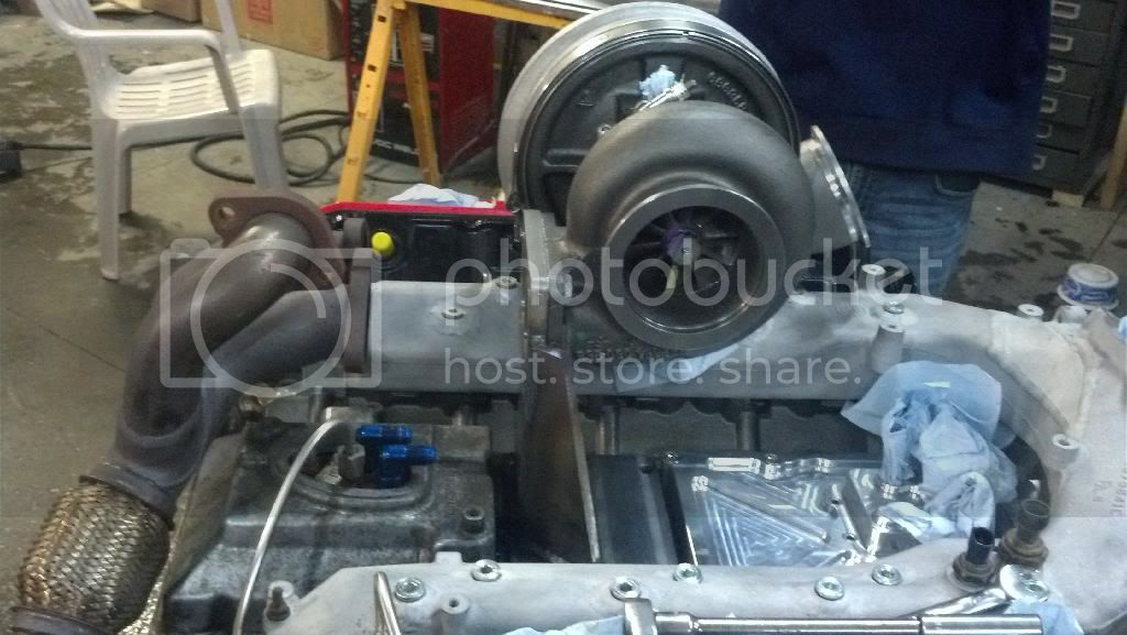

What's everyone doing for oil lines on the turbos? I'm still running stock turbos for now till I see if the block stops leaking coolant. I was thinking -8AN off the plate and a -8 to -6 Y to feed both turbos.
blk350on20s
Jul 5, 2011
2,720
I ran -6 to both of mine. I used a T fitting right of the new oil plate. Its a -6 hole in the plate.
