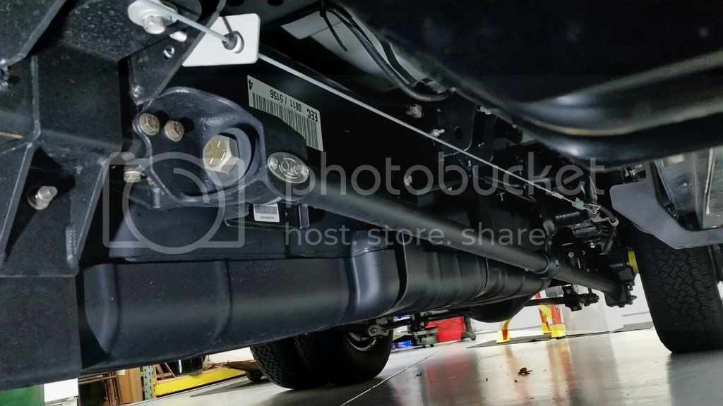

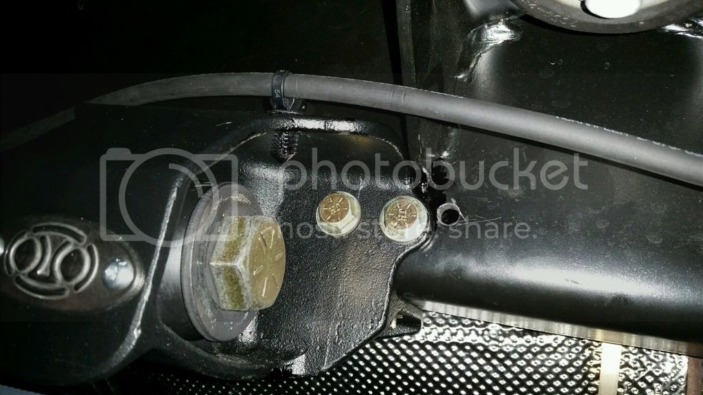

I swapped out the Grade 5 bolt for a Grade 8 yellow chromate bolt to match the rest. I like the stainless ARP bolt used as the through bolt.
Now you got me thinking....I dont know if I have the 8" overlap in the bars....:shrug::shrug::shrug:
I ran across this issue on the passenger side. I drilled the bracket to secure the Christmas tree strap.

oh boy.. is yours a cclb?
lincolnlocker
27,913
177
Central Michigan
Yep...2016 F350 CCLB DRW with a Titan 65 gallon tank.
Billy T.
[email protected]
oh chit!! so if the frame length and body mounts are the same and i figure i have 10 inches of overlap, and im 3 3/4 inches from that body mount, you are probably under 6 inches of overlap since you are kinda tucked under the mount some... hmmmm
