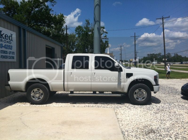

Beaumont..err Vidor Texas

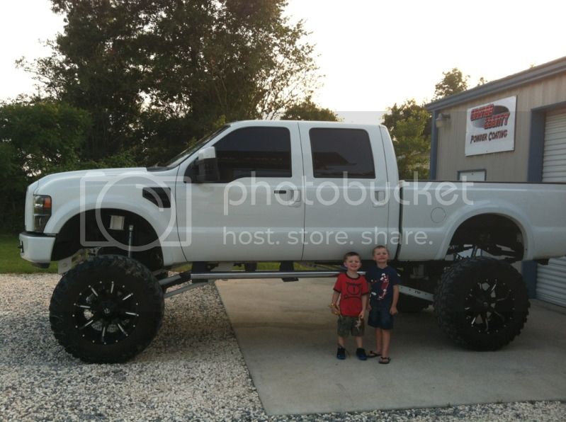

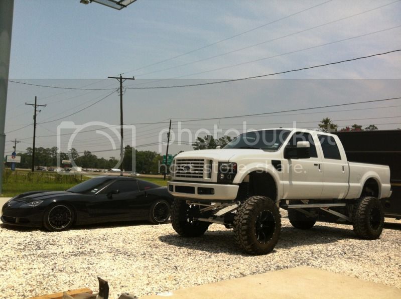

So I bought me another 6.4 after rolling my black truck over....I drove it stock for a few months then called up Trevor for another lift. This is my second PMF lift...first was the big 20" airbag lift 4 link front and rear. It was a no brainer to choose Trevor again when it came time for a big lift.
I started out wanting just maybe 11-12" well that changed as Trevor was building the lift. It all ended up around 15" total lift...and I was pretty luck to get a set of the brand new Traction bars.

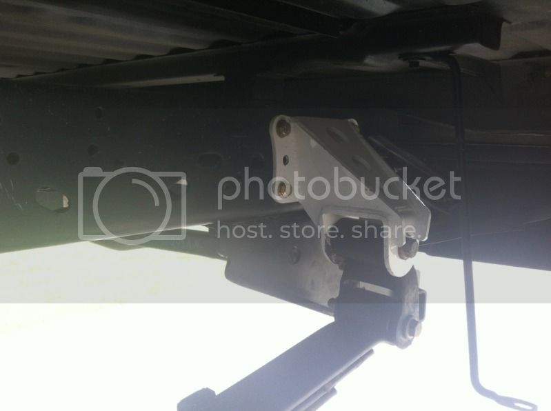

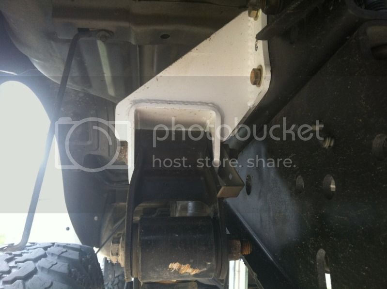

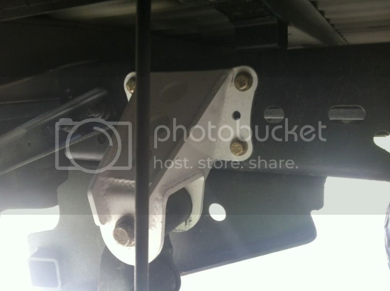

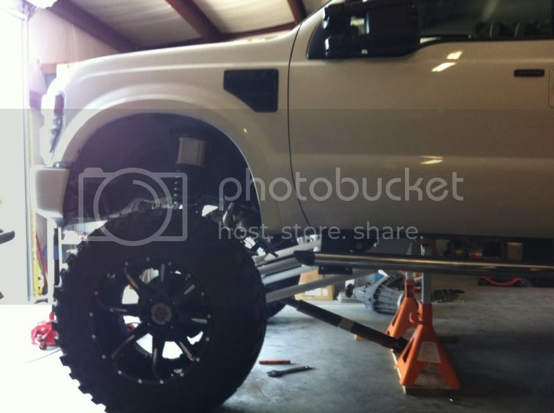

The lift consists of traction blocks in the rear and a shackle reversal using the stock leafs. Front is Trevors 4 link with new crossmember and transfer case clocking ring. Using spacers and Icon springs for the height.
PMF track bar and just received my bigger stronger PMF drag link that I need to get installed.
As you can see I had everything powdercoated white and IMO it all came out great. I have a few details to finish up still...one piece driveshaft will be ready monday, I need to have shocks re valved and order my brakelines.
I will take more pictures this coming week after I clean it all up...I will get closeups of the components etc.
I want to thank Trevor for the great product and its been a pleasure doing business with him and his company again.
Scott

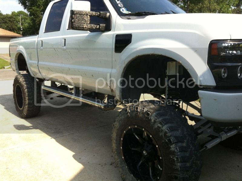

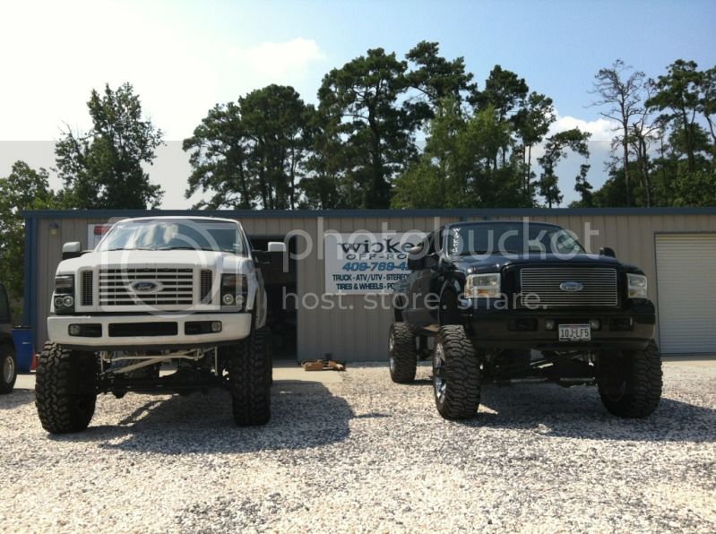

Few more pics.
My boys love the fact that I have a big truck again....their smiles worth worth doing the lift alone.
Got it a little muddy already...lol

Looks awesome...I was looking at the shackles the other day and noticed I could get quite a bit of lift going that route and it would flatten out the leaf. How does it ride in comparison?
