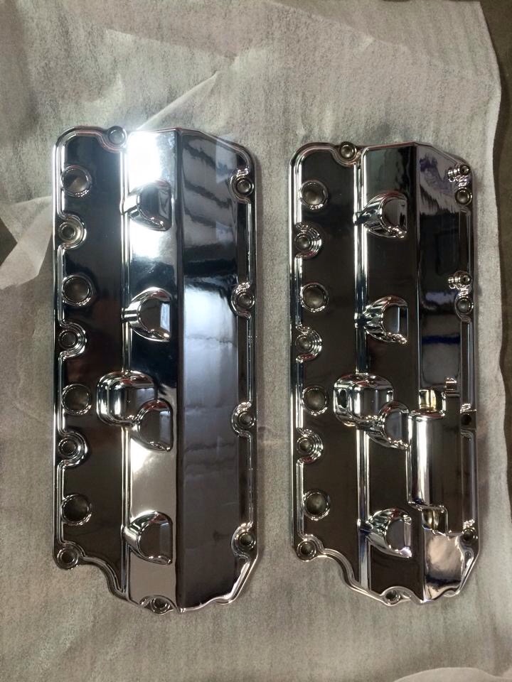

Polished valve covers.

Seen these on 6.4Fb post yesterday

Those looks awesome.....wonder how long that took
I've haven't did 6.4 VCs before, but have polished rough aluminum before, and have a few buddies that are really good at it.
I'd guess 6-8hrs on each VC.
They do look sweet!

So what would be the steps to try it out?

http://powerstrokearmy.com/forums/showthread.php?t=54725
Here's a set of compressor housings I did. This was in a rush so they are not perfect, and those housings actually went through an engine fire.LOL
Main key is wet sanding them smooth, using a quality polish, some jewelers rouge, and lots of time..
A good buffer and variety of buffing pad helps to. IMO.

Just snag an extra set of covers . Start out with some 600 grit wet and work your way up to 1500 or so . Then hammer the rouge to em . You really can't mess it up .
