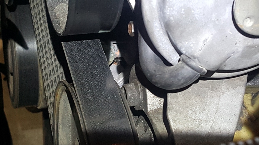

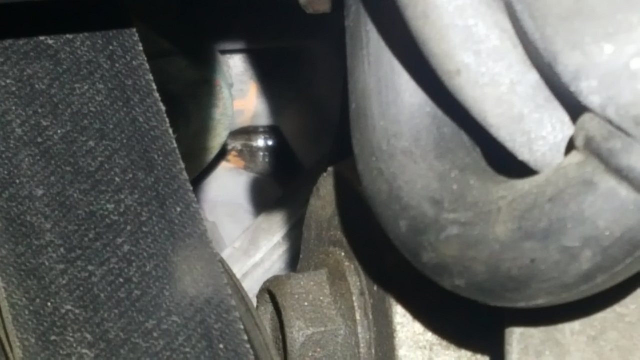

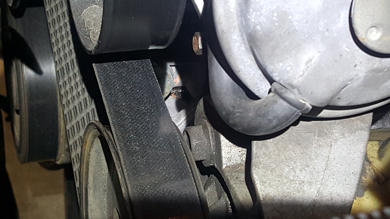

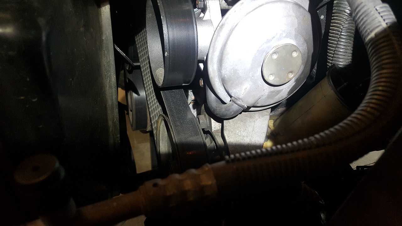

Well i found the leak today, and its exactly where the shop said it was. After i got to the shop and opened up, i went and drove it hard for about 15 minutes, pulled it into the shop, and put the coolant pressure tester on it. You can see the coolant was coming out of the front cover, right where the shop marked with a paint pen.
Pics: (They are progressively zoomed out so you can see where its at)
So i went out and bought a 5 oz tube of JB Weld. Wish me luck.
