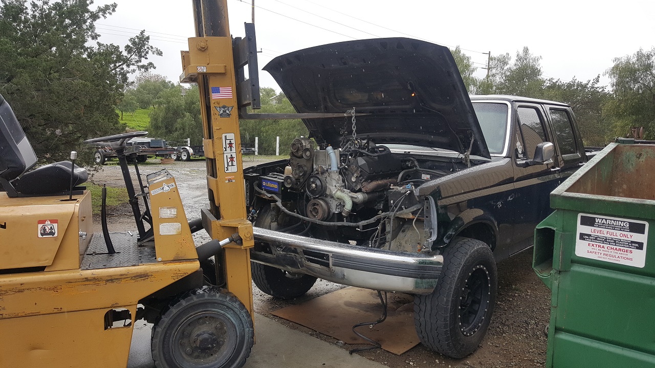

First off, I got the motor out, but sacrificed the motor/tranny spacer.. I forgot to unbolt the starter, and it got hung up on the motor mount, which in turn broke the spacer. A new one is on order, picked it up for $50 on ebay.

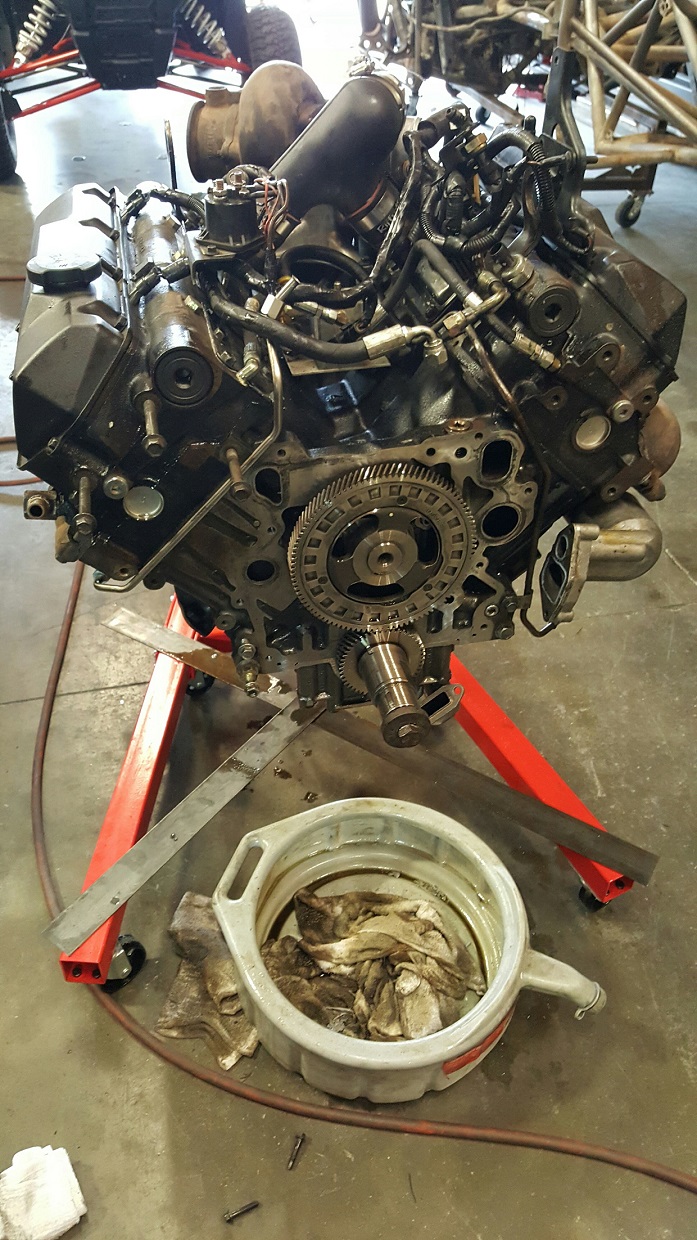

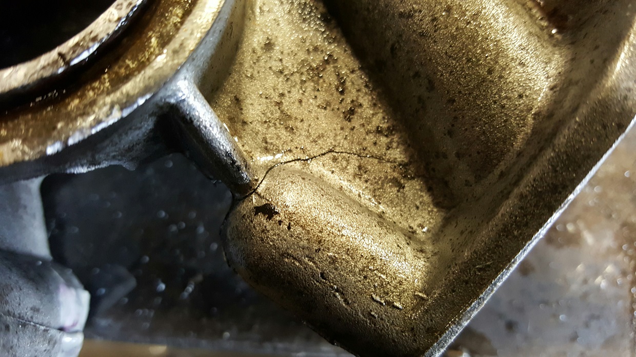

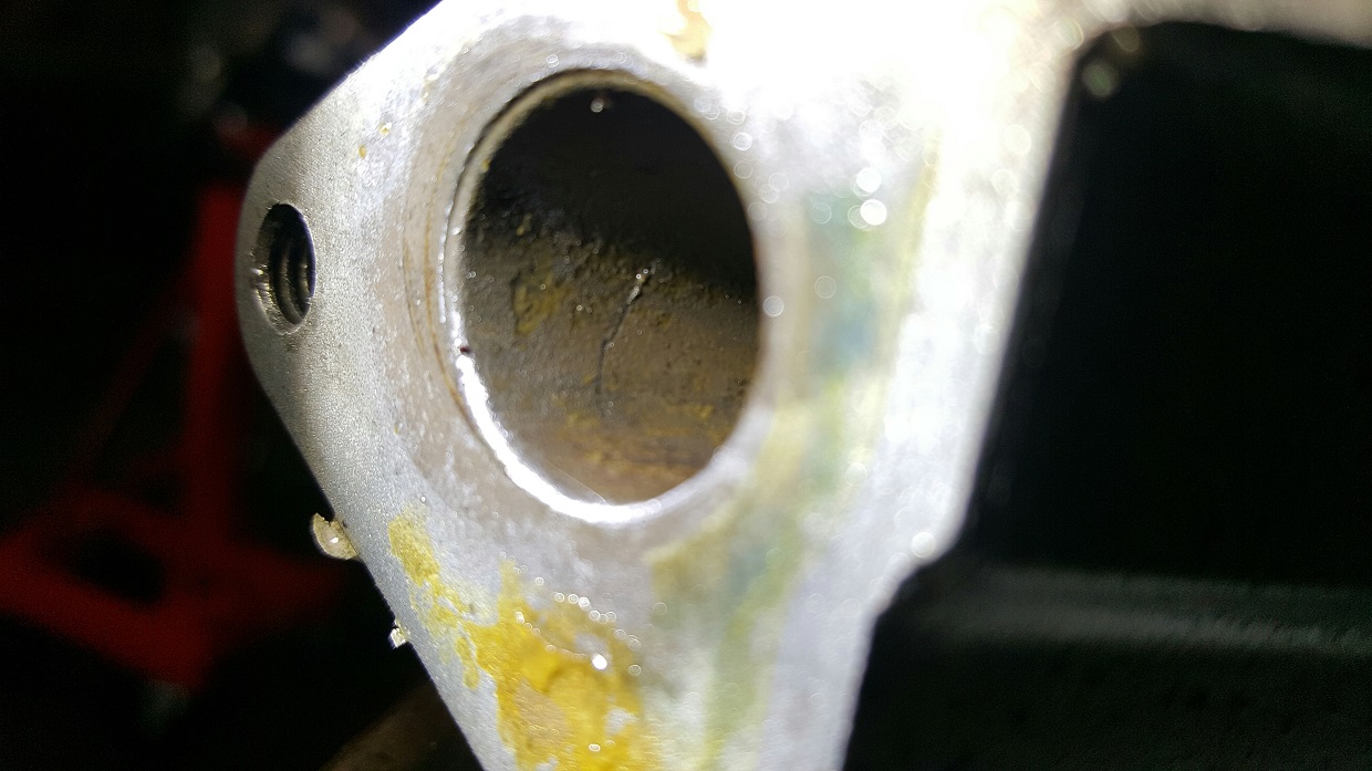

So then I threw it on the engine stand (got the 2000lbs model from Harbor Freight, which is surprisingly stout!!), and started tearing into the front. Got the oil pan off, all the front accessories, water pump, harmonic balancer, LPOP, HPOP, HPOP reservoir, and then finally the front cover. And this is what i find...
So If you have read through this thread at all of my entire endeavor, you would remember that the shop that was doing the work dropped my motor. Not really dropped, kind of just fell over. It was sitting on the ground and fell on the driver side, breaking the oil cooler mount. Which he replaced. Well he didn't think to check the front cover, which was cracked right where the cooler bolts to it. It cracked through the orifice to the bolt hole, and was weeping out of it, and down the front of the cover.
So i took a picture of it, and sent it to the guy along with stating what happened and for him to call me. Now its sunday so I dont really expect him to, but he hasn't called me yet. I'd like for him to reimburse me for all the parts (Over $600 worth), and maybe the labor it took me to pull the motor, do all the work, and reinstall it! So far i'm into it probably 12 hours worth of labor, and im not done. Is it crazy to ask him to cover labor even though im doing it myself? I guess I would still be happy if he covered the parts?

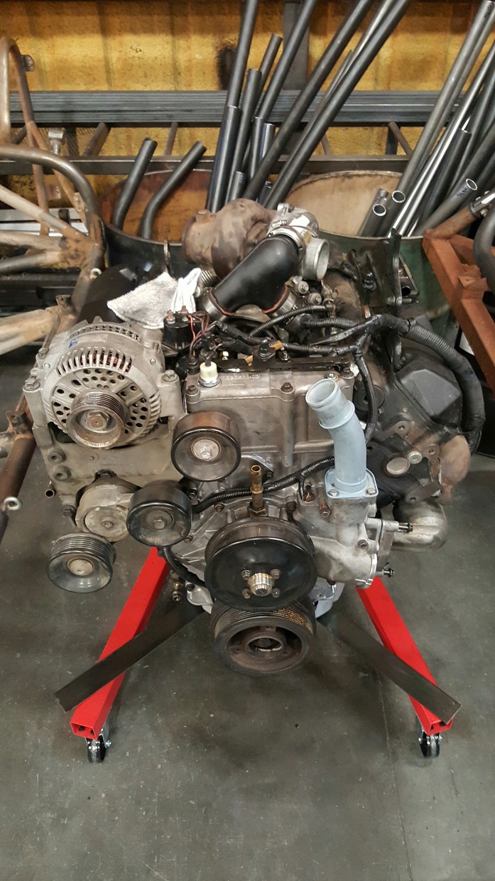

Almost done, just needed the gasket for the oil pickup tube. I was unaware I needed one, so Im waiting on that to reinstall the oil pan. Also waiting on my T500 HPOP to come back in the mail. Then the truck will be all done and hopefully finished! Wish me luck!
How it sits now:

Yeah well after i sent him those pictures on Sunday, he finally gets back to me today, with a text that says, "Sorry i just got your text". And another saying "New cover here tomorrow". So I told him no, I already have one, and the job is almost done and over with. Long story short, its my fault, and he wont pay me anything, but I can have the cover and return it for some money. But he doesn't want to waste his time or pay a restocking fee. Also trying to tell me that he did me a favor for this entire rebuild, and I should be thankful! It got heated and I ended up telling him to keep it, If he treats his friends this way, then I'll fix it and take care of it myself.

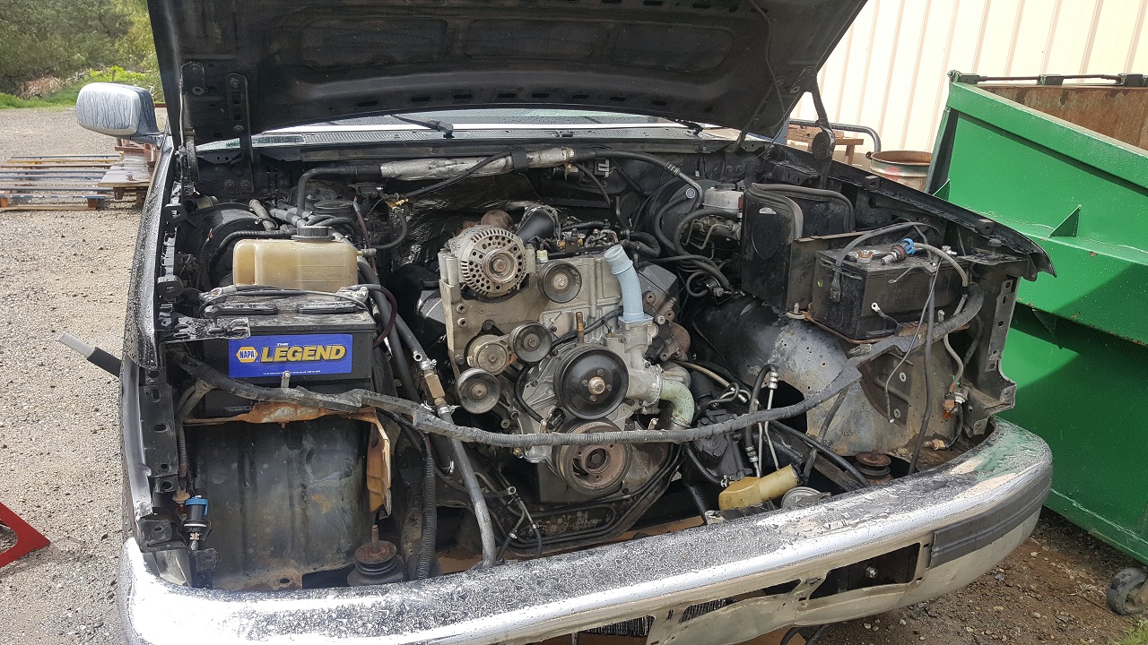

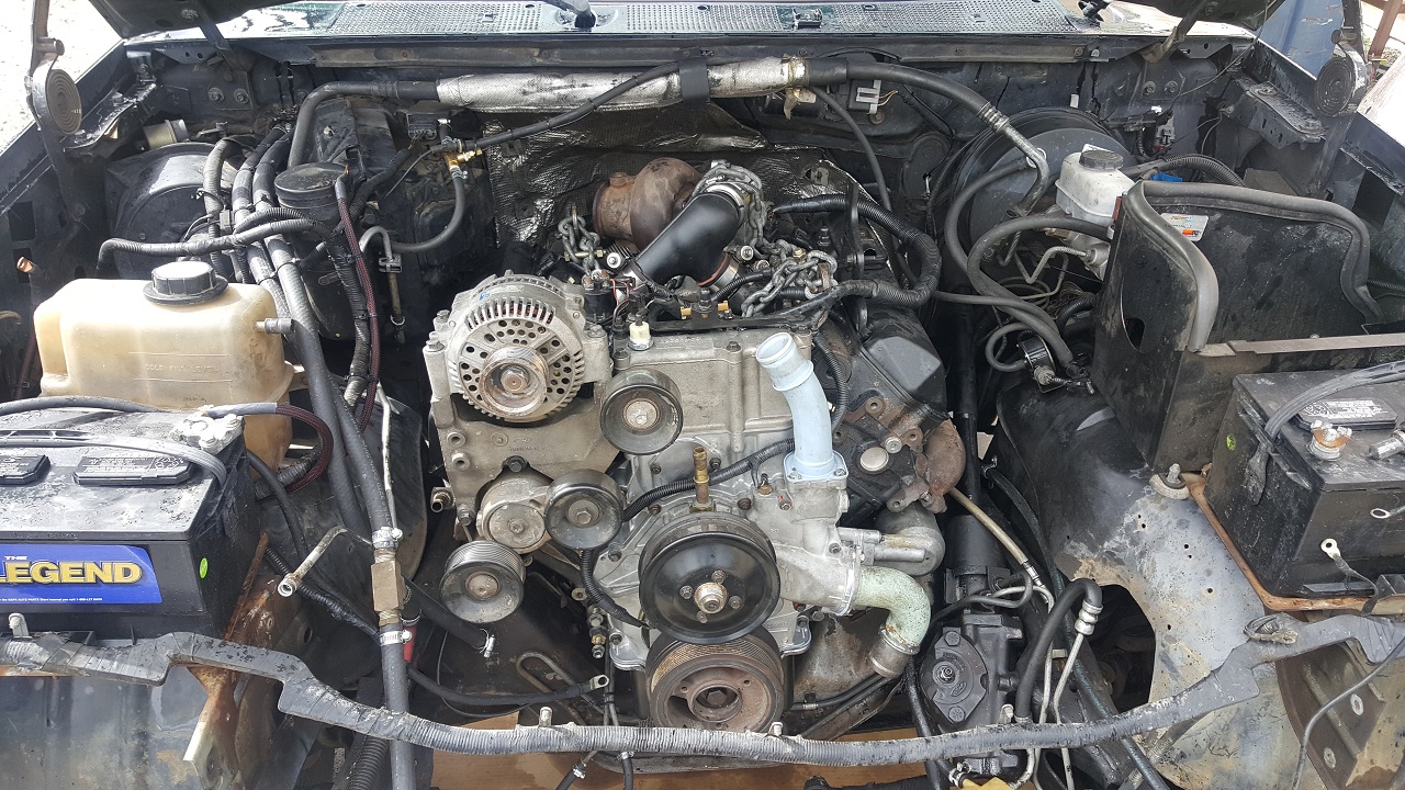

Also got the Motor installed today, just got 2 Bell housing bolts installed and the motor mounts bolted up. Fuel system is put together, and all the front accessories are put together. Installed the core support and a couple other small things. Hoping to have it finished tomorrow or Tuesday. Then im just waiting for the T500 pump to come in the mail so I can drive it.
