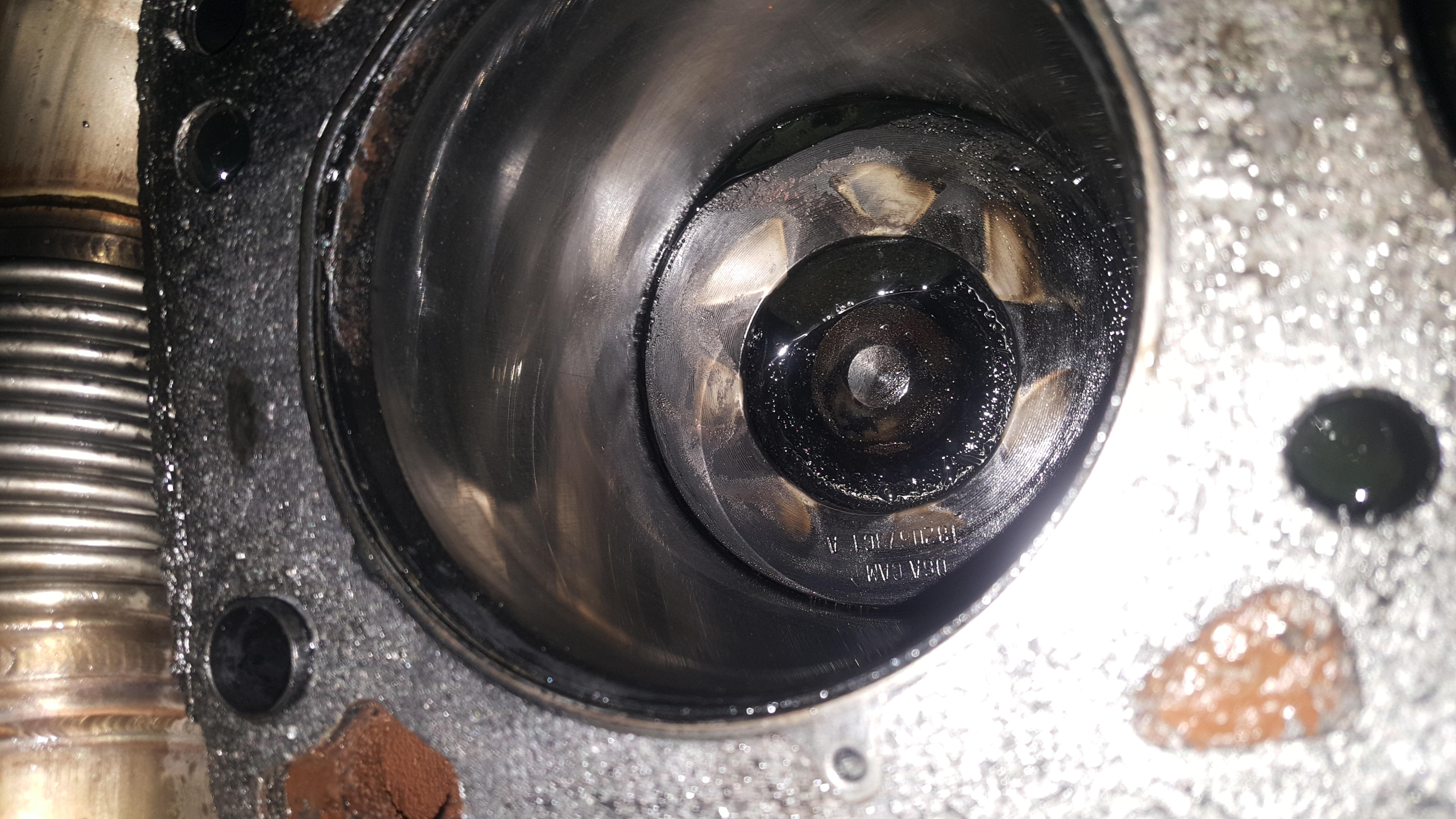

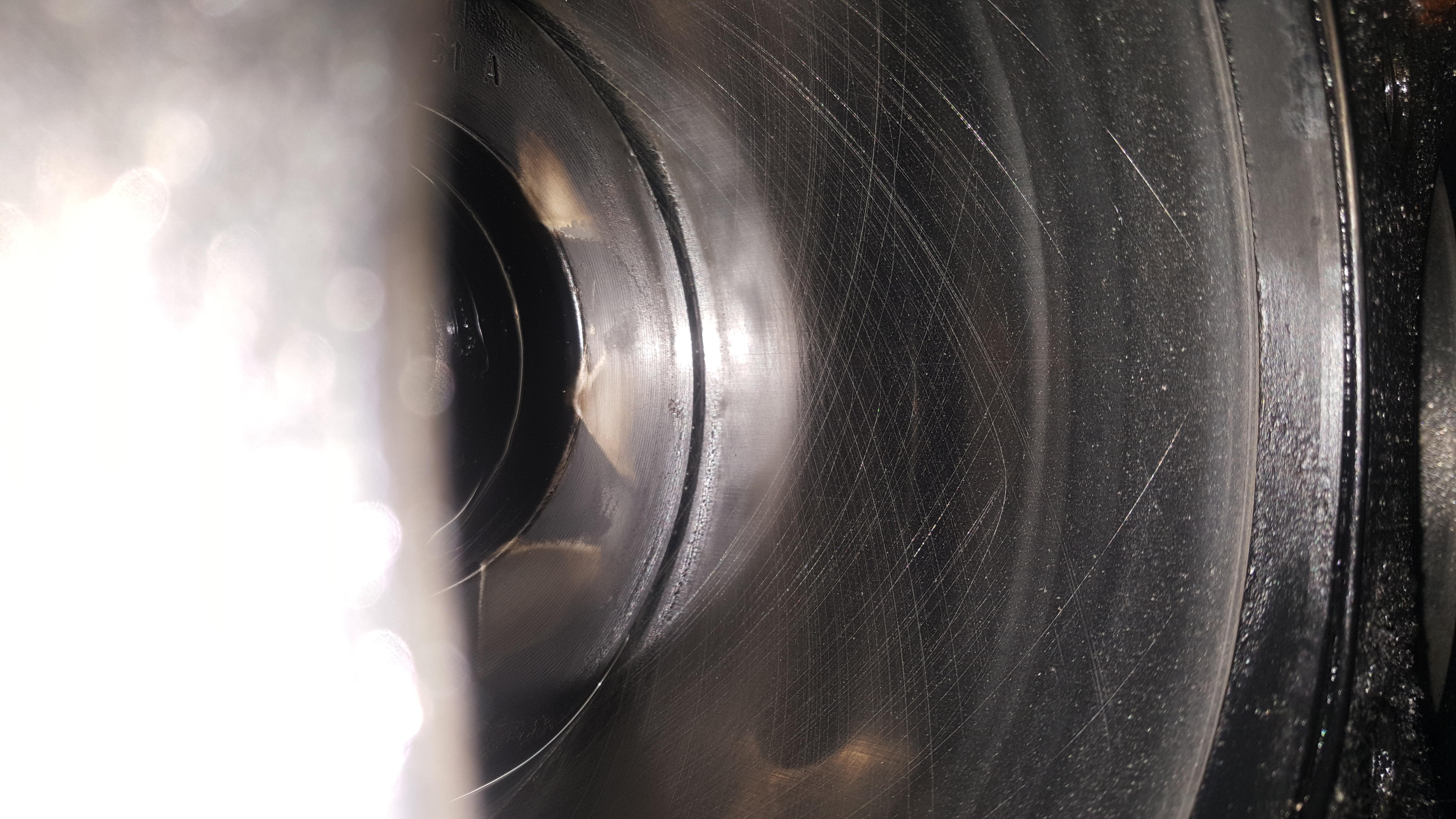

Here's pics of the cylinder walls, they're off my phone, so I can't see them,I hope they are correct lol
Edit: the second one is upside down, sorry! These were taken immediately after the head was removed

1500 degrees means nothing unless it's sustained. 2000, then you would need concern.
Looking at your pistons..... you NEVER saw any decent heat. Period. They would have at least 2 or 3 cracks coming out of the bowls, and they don't. I've never had an engine apart that did any towing with stock pistons that did not have cracks.... so consider yours babied.
Secondly, if heat had opened a path for coolant to reach the crank, I would look for the cylinder head to be cracked between intake and exhaust deep enough to reach the cooling jacket. Remember...... if you were smoking the world out then the coolant was NOT flowing straight to the crank.... it had to be running into the CYLINDER....
In my experience this is a cracked head, although it could be the block, that is usually catastrophic as cylinder pressure will push a nice window through the wall at that point.
The lack of cracks in the pistons deter me from thinking exhaust gas temperature. Even stock trucks that tow heavy will have cracked pistons.
Lastly, in my experience, you can't tow with an OBS and no coolant gauge. I think that's now your experience too...
If you hurt the engine, it was with coolant, not exhaust gas temp. Remember.... your pistons are aluminum, nothing else is... If an engine gets hot enough from egt to hurt the heads or block the pistons will show it. If the engine actually runs hot, the pistons might be fine (although getting a bit tight, lol) while the heads are warping and being destroyed.
Look at the heads between intake and exhaust for cracks. Clean the pistons are see if they really are without cracks. If so, that thing never saw egt.
On Edit:
I've never seen a 7.3 without beautiful crosshatch.... no matter how hopeless the blow-by was, lol.

Thanks for your insight bud, I havent had any extra money lately so its been sitting behind the shop every since.
I agree with you i dont think i hurt the motor with EGT's, or atleast not bad at all, i do agree that it was a coolant problem. Im still having plans of sending the heads to the machine shop and have the mag-fluxed, and tested, Cups replaced etc. but then i think im going to put all my eggs in the basket and put it back together without actually looking into the bottom end.
If it runs, then im back in business and no worries, but if it doesn't, well then i guess the motor is coming out...

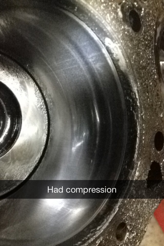

1st time for everything lol supposedly had 165k on. When I say it had or didn't have compression, it was on a stand with the glow plugs removed and only 1 installed and I spun it over by hand. If it got tight it had some compression to it, a few cyclinders didn't hardly slow me down. The one in the pic that didn't have compression had the cyclinder wall wore about .04, look at the ridge at the top of the bore.
