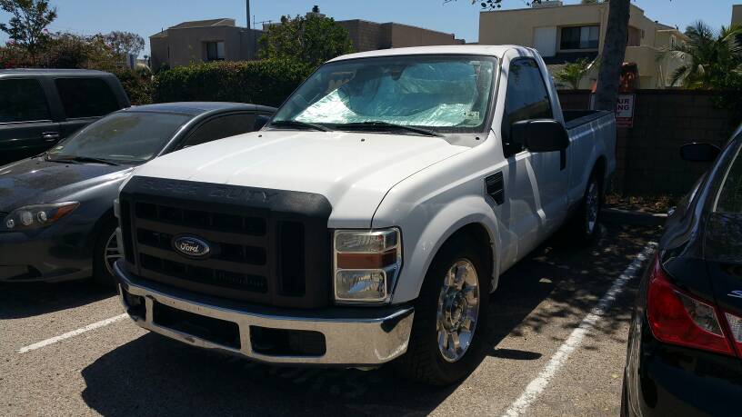

Haven't posted in a while, but I'm starting to collect engine parts in preparation to lift the cab. Here is the parts list. I don't have alot of these items yet so input is welcome.
59/75 Compounds
Tial WG
FASS Titanium 150 LP
Fuel Bowl Delete
Ported Fuel Rails
HD UpPipes
ARP Studs
EGR Delete
Stage 1 Valve Springs
Stage 1 Pushrods
New OEM Lifters
New OEM Rockers
Hot/Cold Side Pipes
No Limit CAI
No Limit CCV ReRoute
A built tranny is on the list for the future as I'm sure my stocker won't last too long. Anything I'm forgetting or should think about? My current K16 seems to be healthy. I am seeing 26,000+ psi rail pressure on Eric's Street Tune now. I have given some thought to going with 15-30% over injector nozzles but I hear a stock K16 will not be able to feed even 15's properly? Don't really want to go dual fuelers and there doesn't seem to be a reliable stroked K16 on the market. So, I may just live with stock fuel. With the truck being light and 2wd, I don't think I will have the means to get the extra power to the ground anyway.
