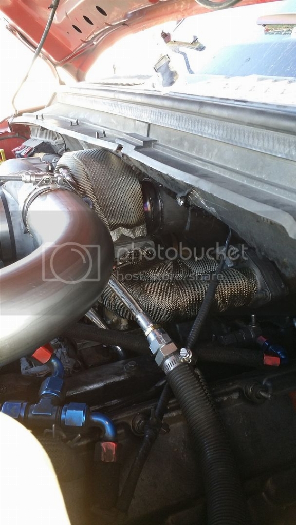

The fab guy's apparently gave me the "special" hot side pipe....LOL
**View discretion advised**

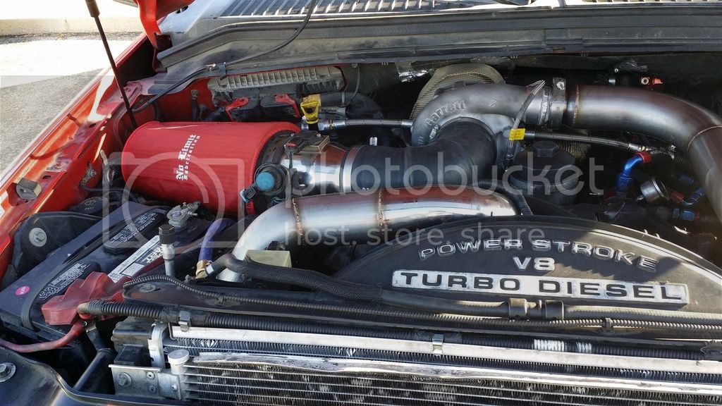

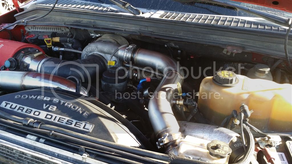

Here's some pic's. yes the engine bay is filthy...I know it just came outta the shop last night. It's getting a good cleaning today. LOL

This thing drives hard, moves some air and spools crazy fast. I for sure need more fuel on top. In the 'Street' setting of my xrt, it's around 1300-1400us for tune, 45psi of boost and won't go past 1150 for egt's und a wot run. Doesn't bark what so ever in between shifts and sounds like a freakin Dyson when above 20psi. Hopefully i'll get it on the dyno just for hp comparison on the same H&S boxed tune that I did the 584 with the 66. That tune runs around 1700-1800us. From there, start tweaking the tune and seeing what I can push it to on stock fuel. :biggun:

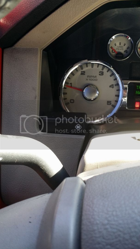

Here's a pic of the lever installed and of the the gear indicator. I thought the indicator would be bigger bit it's pretty compact and out of the way. The lever I will say is a little bit getting used to. Oh, and these things do not agree with CTS's at all. LOL
