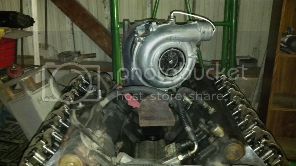

Ok guys......
I got a lil bit of time to mess around with the turbo night before last and got a few things figured out. Sorry it took me so long to get it all posted up, but I have been extremely busy trying to get all my work done before I leave for cali tonight. To give you an idea how busy, I took these pics at around 1 am LOL

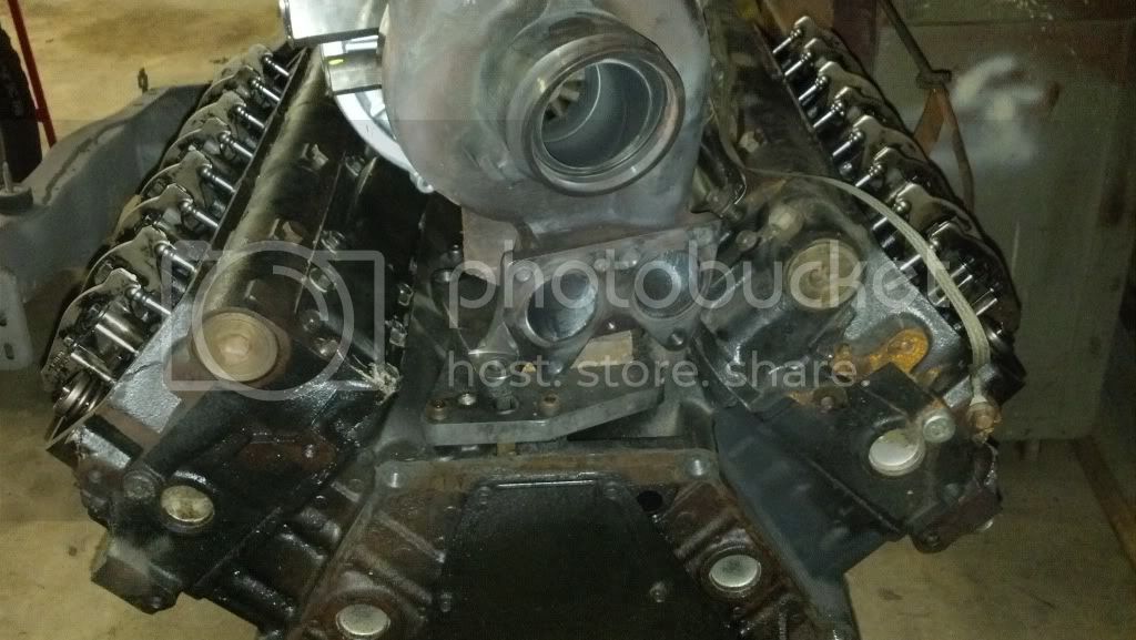

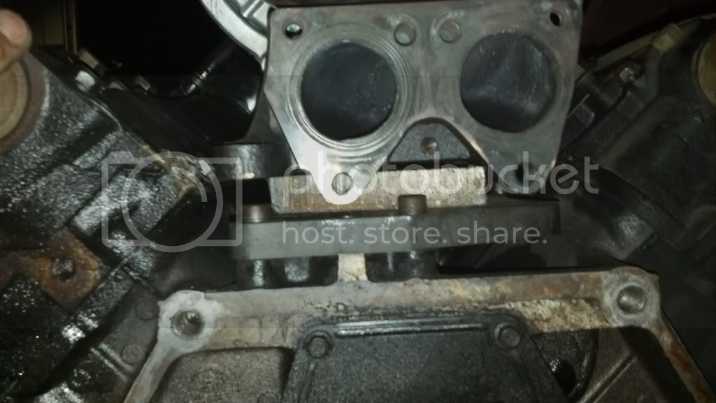

As for the up-pipe flange issue, how about this.....
I used a piece of 3/4 flat stock and it gave me the clearance I needed to set the turbo farther forward. This helps in 2 aspects. One it allows me to be able to slide the turbo forward and align the rear mounting hole over the plate. This is necessary as the turbo only has 3 mounting holes in the pedistal and this is the only one located in the rear of the turbo.

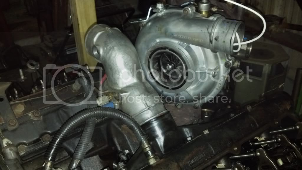

The second reason is now that I have slid the turbo forward, it allowed me to rotate the turbo so the inlet is more towards the driver side then straight forward. This helped in a few different ways. It will make it easier to get an intake piped in for the turbo and also gave me a better idea how I will have to set up my intake y to feed the intake plenums.
As you can see in the below picture, I dont believe I will have to modify the intake plenums but will not know for sure till I get a lil more fab time in. THIS IS JUST AND EXAMPLE!!
And the last thing to address is the up-pipes and exhaust. By rotating the turbo it orients the exhaust outlet more towards the passenger side therefore making fitting a down pipe in easier (at least I hope it will LOL) As you can see in the picture below it also will give you an idea how the up-pipes will be fabbed up. Picture like a 6.0 but turned the other direction.
It also uncovered the oil supply port that is for the turbo. This should allow me to set the oil feed and return up similar to that of a t-4 setup that we already use. That will be all the visuals I will be able to provide for the next week or so. I will not have any more hands on time with this until the 4th of July at the earliest. Interested in hearing everyones opinions.....

That is the first thing I plan to do when I get back it pull the cover and look into this aspect. Unfortunately I will not be near the turbo again till around the 4th to get the picture that you are looking for. Jason might be able to help you though as he has one of these turbos. I am hoping that it will be possible to clock it 180* and basically just pipe charged air the opposite direction that it runs stock.

With the turbo sitting as pictured in the final few pics, the top of the turbo is only 8 inches from the top of the head. So as long as the dimensions that moore gave me are correct, we should have plenty of space.
