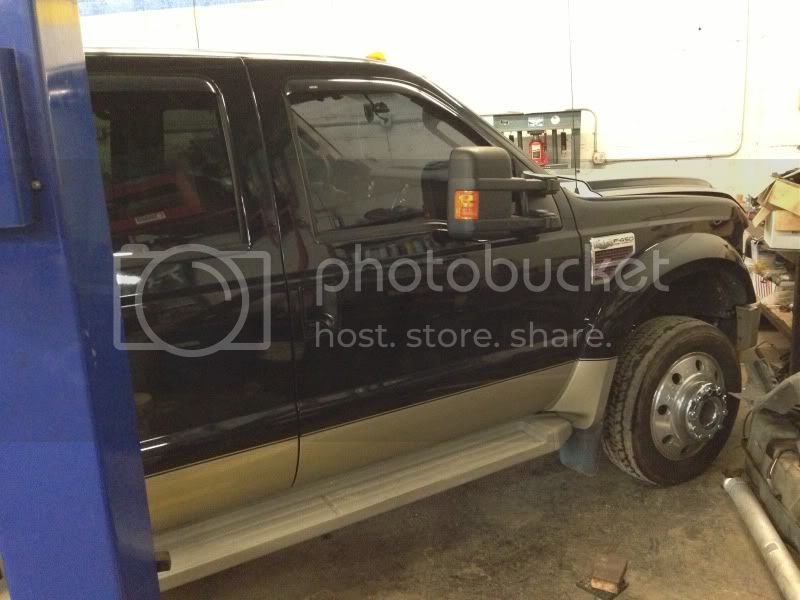

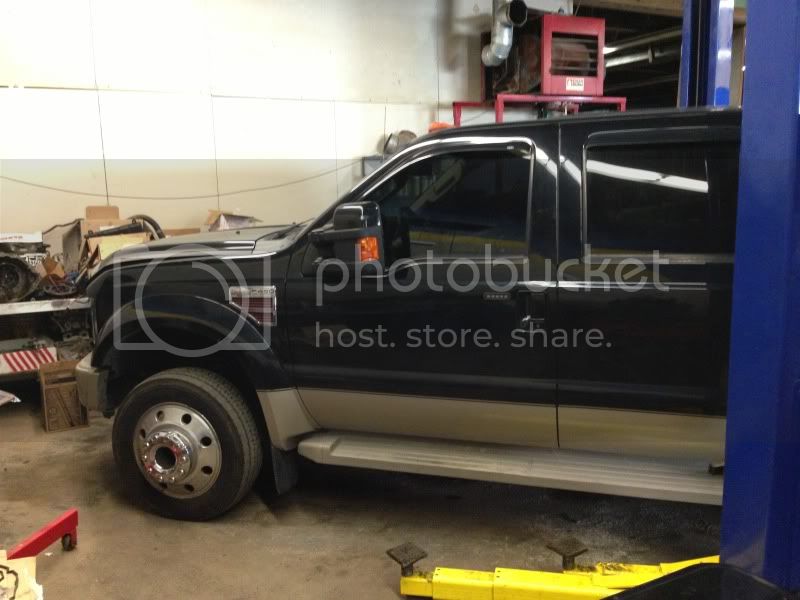

We have been looking for a tow rig for quite some time now. Went and looked at a few 6Leakers but couldn't pull the trigger on any of them.
Finally came across what seemed like a good deal on CL.
2008 F-450 King Ranch with a bad motor.
Of course, like everything else I have looked at it was not as described. LoL
Bit the bullet anyways as the deal was right(IMO) and it was more truck than we needed.
Truck got delivered today so I figured I would start a thread to document the "build" process.
The truck is ROUGH around the edges. She was worked and not really cared for. I don't understand how someone can buy such a high dollar vehicle and treat it this way.
The plan is to either build the motor if the block can be saved or find a low mileage motor and stud it and drop her in.
Obviously it will be deleted and tuned. Not sure what other performance modifications she will get.
Then we will focus on making her a little more presentable.

Sweet find! From the pics it looks pretty clean to me!
Wanna tell us what you gave for it? Or pm me. I'm just curious!
Have fun with the build!
