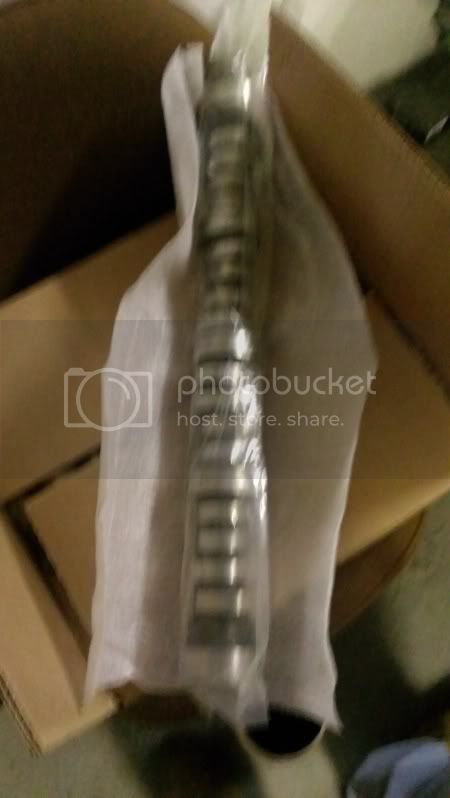

Some valve train parts from Morgan![]()

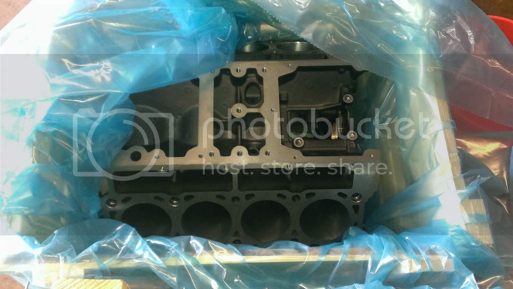

Also one of the heads has a crack from a seat to the glow plug hole. Does anybody have any good uncut cores they would sell?
Lookin good!
Finally getting this thing going.
