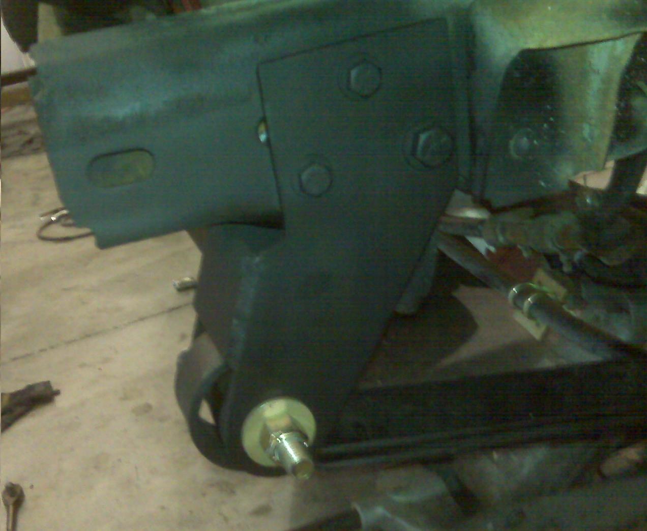

Here is a picture of what was done by someone a few years ago trying to DIY a lower version and also not cutting the bumper.
Tom S
3,365
That is a good photo Cary thanks for sharing. I have fabbed quite a bit of the stuff on my truck but I think this one is out of my realm esp with all the bending involved. I wish Sky was open to some options on all of this.
