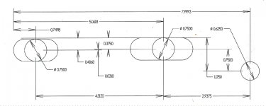

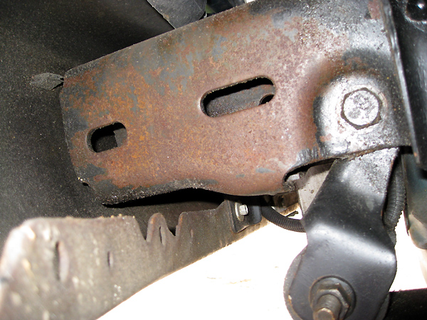

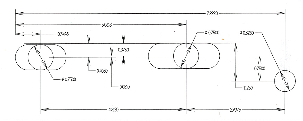

Just copying in a few of the photos to make the thread easier to follow for everyone.
Those photos are from BigBooper and look like 2007 vintage. I posted them up as I think the design on the side plates is going to be right along similar lines on this project. I need to double check but I think that he all used all factory bolt holes so no drilling. Thoughts guys?
