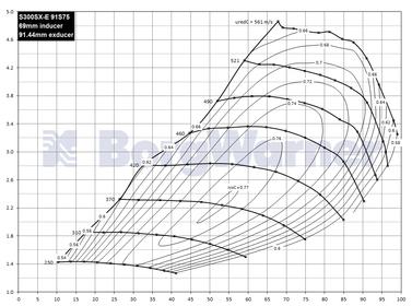

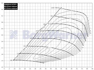

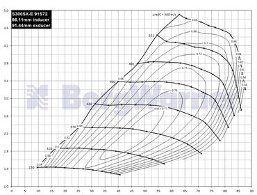

How about maps for the different compressor wheel sizes? It's real hard to find them in high rez for the 364.5 Please make sure they are high resolution so we can actually read them. Thanks in advance if you can hook us up!

I would love to run Charles current AEB file, on 200% nozzled injectors and a 364.5 I bet it would be one bad azz towing machine.

I'm sure I can make that happen. Might not be until I'm baxk at the shop on Monday.
Thanks man! That would be extremely helpful when trying to compare different turbos. Especially the 38r to the 364.5. Now if only Pius would provide a map for the BASB. Also, I like the fact that the sxe turbos have provisions for a speed sensor. That's nice for the engineering types that like to have as much data as possible.

Hey guys,
Hope this helps out.
