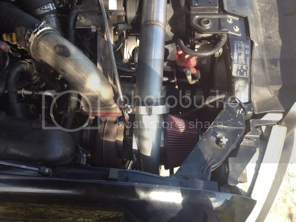

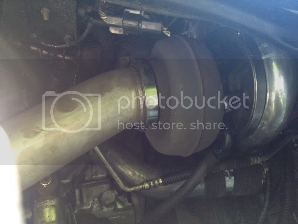

Is your S483 only hanging by that piece of 1/4" x 2" flat bar? Or is it braced underneath where I cant see?
Awesome Job btw. I'm super jealous!
I read an old thread on PSN about Joey running his turbo drain line to the valve cover. Anybody have any info on this? Seems a little high to me, but it would be alot easier than removing the pan.
Sorry for the derail.
JDub
1,813
Hooper, Utah
Going to depend on where your atmosphere turbo is mounted. Joeys is directly above the valve cover, so it's a straight shot down into it. The way this one is set up, you'd have to run it into the pan. That's alot like how WOP did it...

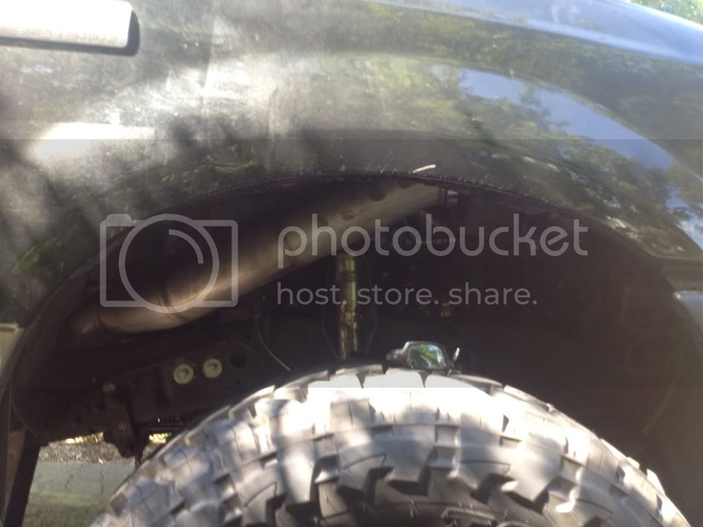

I need to add about an inch lift to the rear when it has sh1t in the back which is 99% of the time she sits ass low a little. 7" block , add a leaf something.
