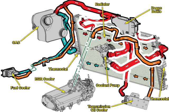

Oil is cooled by the primary cooling system.
If I understand correctly half of the secondary radiator is thermostatically controlled for the trans cooler and egr cooler, where the other half is for the cac and fuel cooler. Which would make sense, they wouldn't want to be on the same circuit as the 200+ degree transmission fluid and hot egr. After the coolant leaves the hot cac and hot trans fluid cooler, they all converge back in the secondary degas bottle so it's not surprising these things are puking.
If you think about the secondary heat exchanger in halves, that means there isn't that much cooling surface dedicated to keeping the iat's at ambient. Especially when the truck is moving twice the air or making twice the boost the system was designed to see.

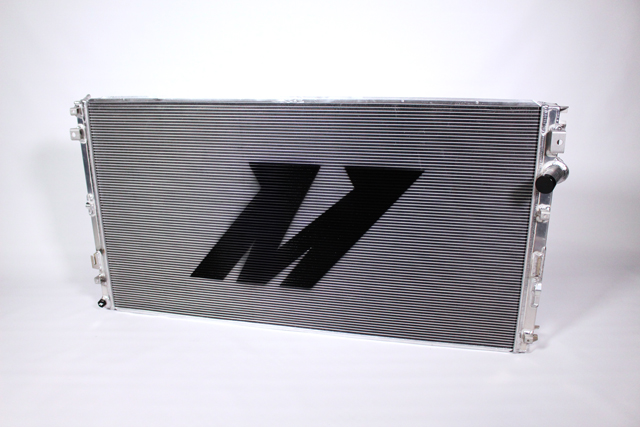

Has anyone heard more about the Mishimoto heat exchanger upgrade?

Don't know if that would truly fix the issue.
For a $1000+ dollar heat exchanger mishimoto needs to prove it'll reduce temps under extreme circumstances. I have faith it'll work, just needs to be proven.
As far as the miracle coolant, I'm skeptical but I like the idea of their NPG product in case my secondary system decides to puke at the track.
But what about the cracking issues?
For every guy that cracked one I know 10 that are happy.
There is no 100% radiator solution. On the 6.4's oem leaked, mishi leaked, alradco leaked.. The 6.7 is turning out to be a similar situation. The way the secondary cooler is mounted I doubt it'll have issues like that.

So, ran the truck hard this weekend and got the secondary to puke AGAIN. I think I got the CAC to leak again. I guess the factory CAC can't take sustained high psi (high 30s)
OR my thermostats aren't working? I'm thinking the CAC is leaking again though, it stopped puking towing after I installed the new CAC. Will keep you guys posted.
