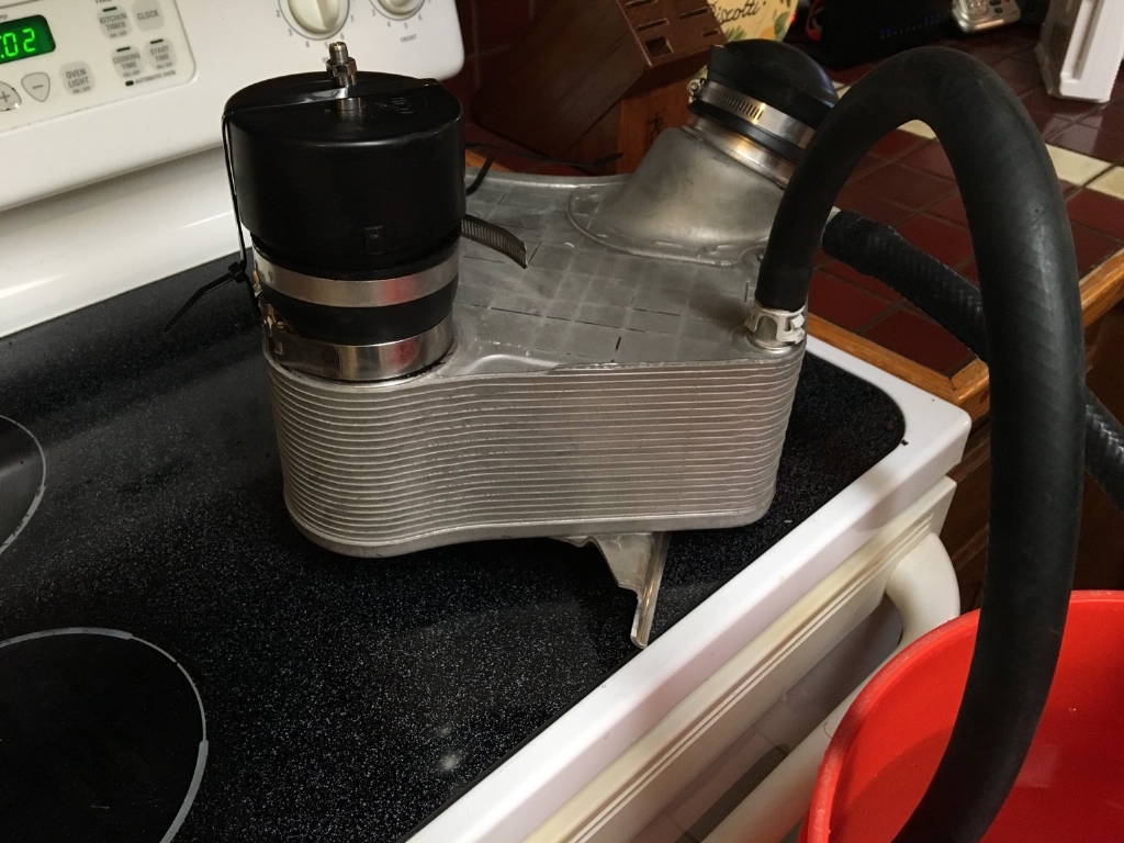

So, put air pressure to the CAC while heating it up and it's leaking. But only leaks when it's hot.
Tony helped me check it at his ford dealer he works at, but we couldn't find it when the cooler was cold. Took it home and threw it on the cooktop till it got to 250degrees. Low and behold the POS was leaking then.
6.0tech(Tony) is hooking me up at his dealer to get a new one. He's TOP NOTCH! Thanks again Tony for everything!!
I'll update this after the new one is on.
Pics of my homemade Air leak setup lol
Zipties are to keep that piece on. I now have a hole in my garage ceiling lol.
Glad you were able to find it man. Sorry it wasnt showing up at the shop, even after a trip thru the parts washer.
