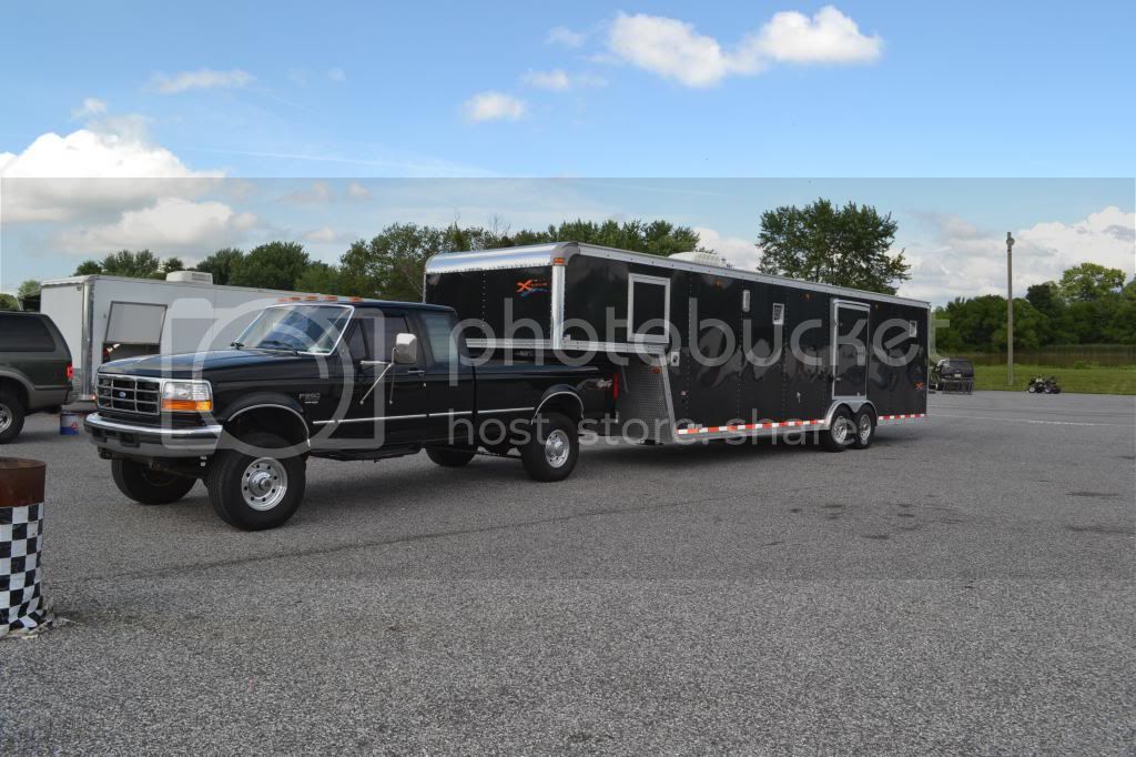

I run Bilstein 5100s with 255/70 valving all around. My rear springs are "C" codes from dually with Firestone air bags set at 85 psi. I tow 23k with the cruise set at 70mph. I get no bounce on concrete expansion joints. The tires are 285s Michelins Es rated at 3750.
Drove across the scale. This is without the 1100 pound golf cart on board. I don't know my pin weight. The golf cart goes in front of the car, against the front bulkhead so the rear axle sees a lot of the weight.
This is my tow set up:
