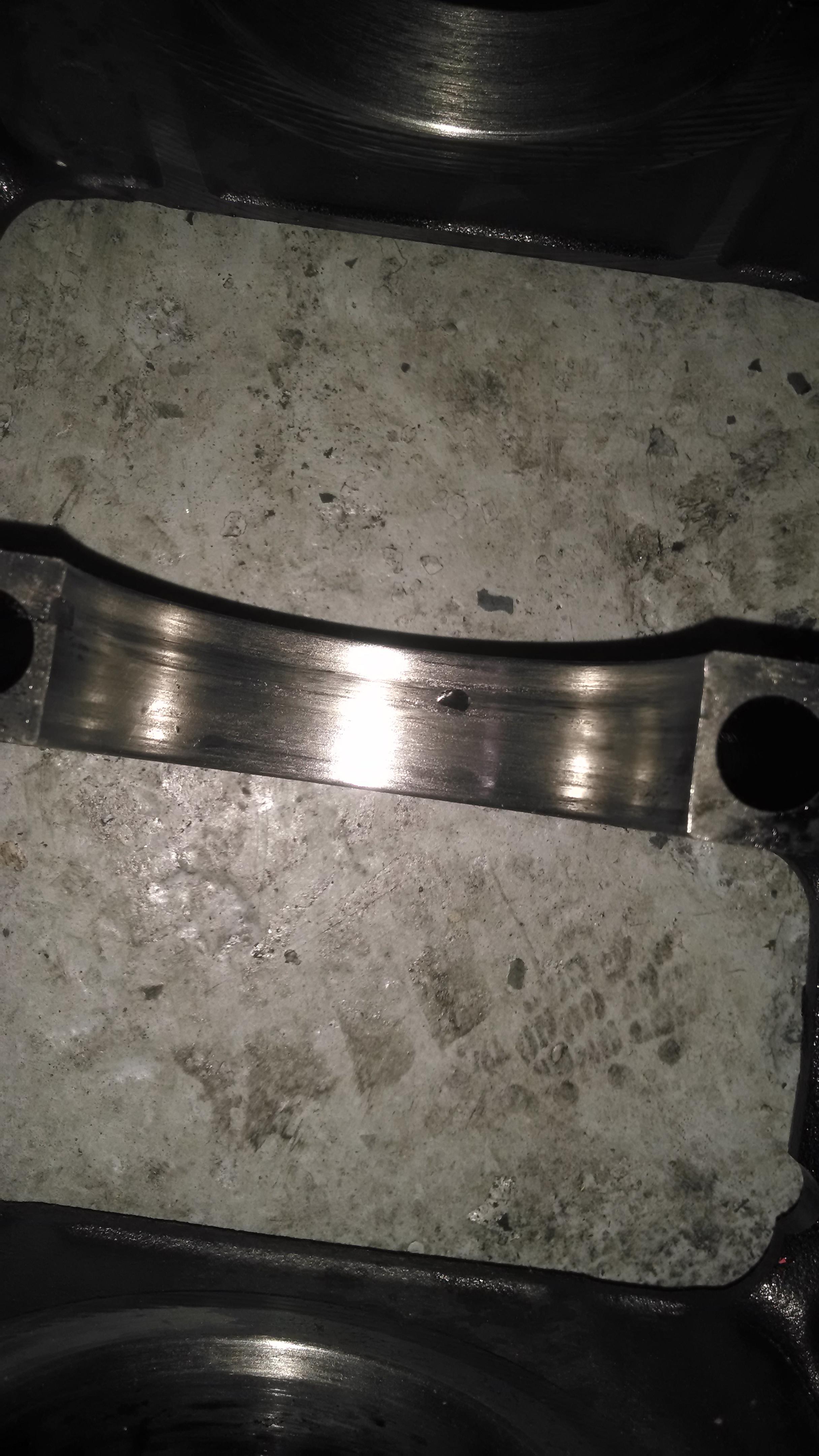

Where can I find a rotating assembly for a reasonable price? I'm done with the junk yards.. I bought 3 of them and they all had spun bearings. And from what I understand and read if they spin the mains.. There junk. I've thought about milling the bed plate and block then re honing the bores to stock.. But then I though about the gear to gear clearances...
One block granaded..
Block 2 snaped crank spun bearings
3rd block spun bearings

I did that. I have all good external parts. One had new rocker arms one had a new hpfp. Etc. None of the blocks were saveable all the main journals were spun. What's the fix to that?

I dont think they make oversized bearings for them, but maybe international does. Otherwise you can pick up a block, but they are 3500 for a bare block from ford. or 5000 for a shortblock.
6.4s are very hard on blocks

A lot of people aren't accepting blocks with spun mains. Except ford. I thought I had beat the system by milling the block and bed plate then re honing the journals back to stock.. Buttt... My machine shop didn't feel conferrable doing that . due to gear to gear clearances

There's one of the worst journals . I Dont think they make one they may make them if you have to polish the crank. Then yes they go as big as .20 but not for larger journal size I wouldn't be posting if they did
Someone needs to tho
